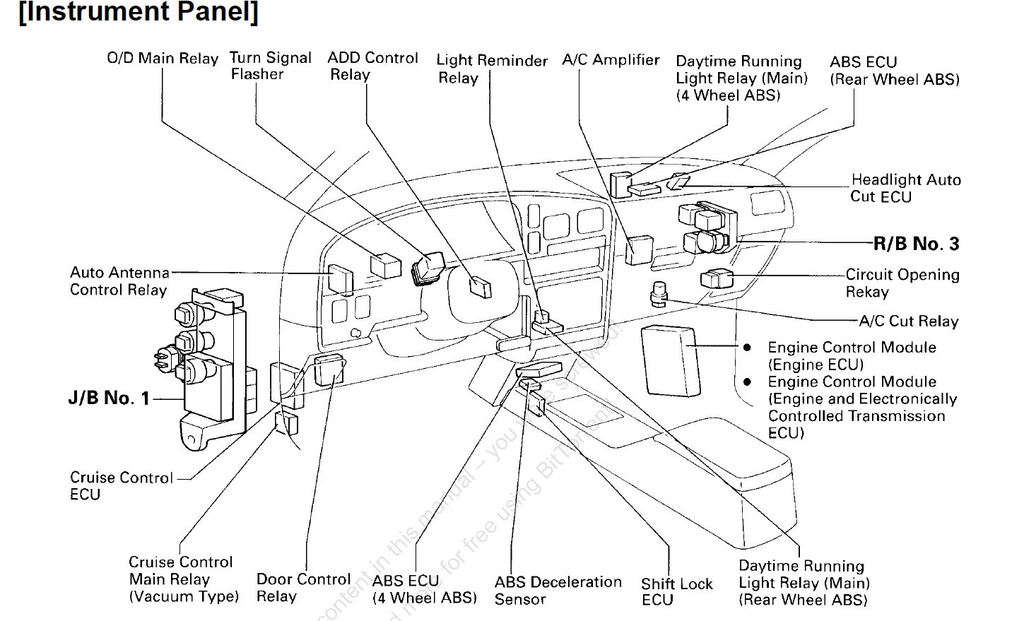

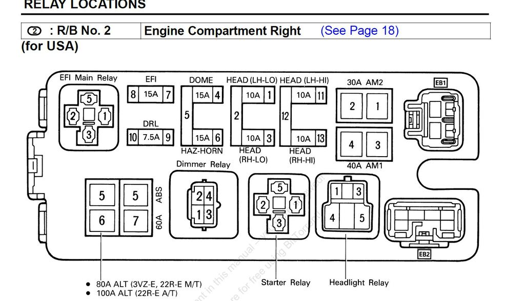

Also, I found this in my 4runner fsm on my computer. I found it weird that the starter relay was in the kick panel. On my truck mine was under the steering column I'm pretty sure. But then I found this.

According to this, it should be in your junction box? In the engine compartment. I don't wanna throw shade, but I wonder if the guy used a starter relay in the kicker panel fuse box, as a replacement for whatever was in there just because it worked? Sorry, if I'm completely off base. This is from the 1990-1995 4Runner FSM I have.
Very interesting. I'm now even more confused as to why the starter relay is inside the vehicle on the drivers kick panel?? Here's the fuse box under the hood... Further inspection is needed.

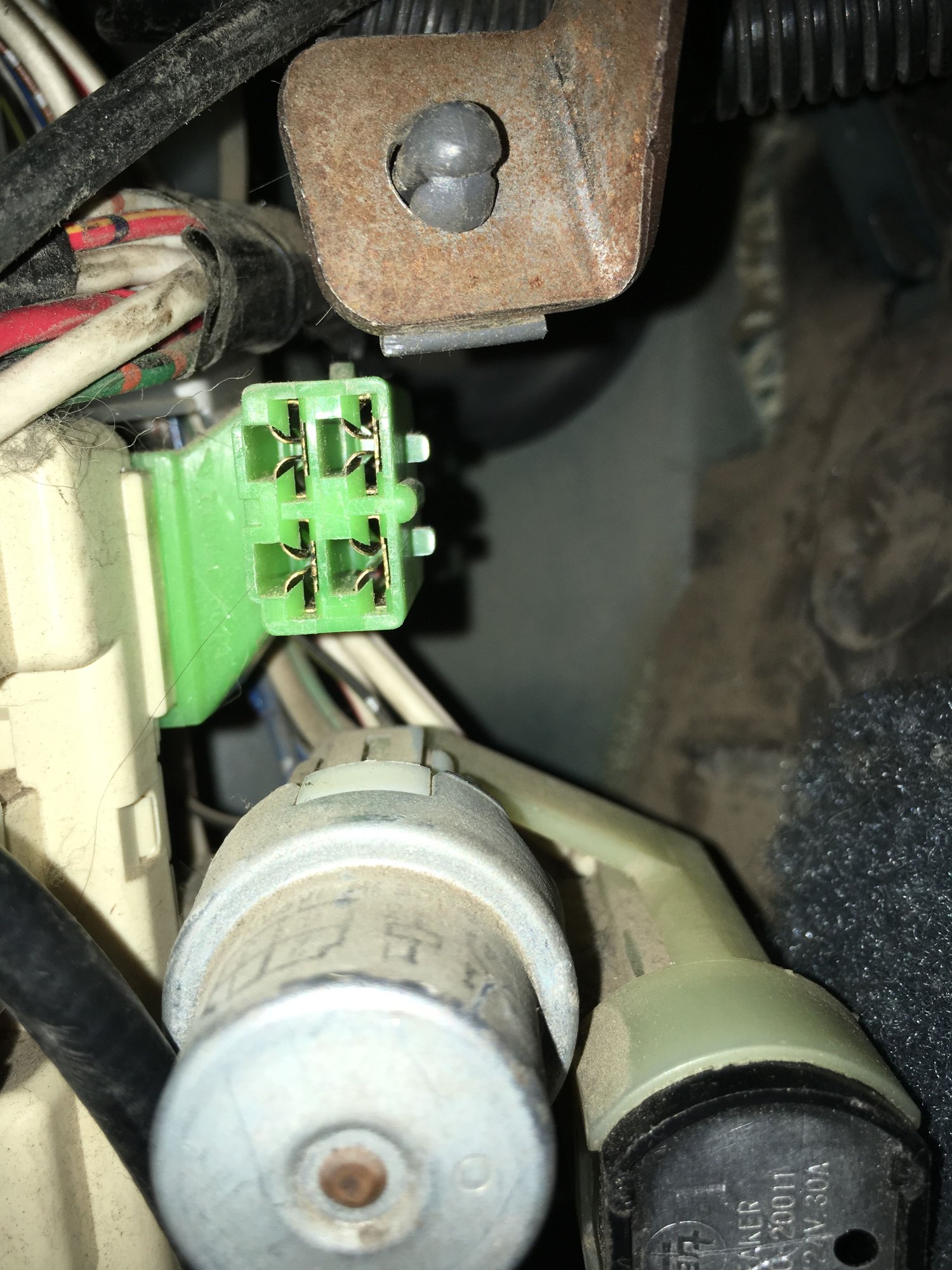

This is in fact the 'Starter Relay'. The vehicle will not start (or click) with it removed. When re-installed the vehicle starts right up..
Starter Relay bottom
Starter Relay for 1991 Toyota 4Runner 22RE 4x4....?

Yes, do checksa as cr@ves4wheelin says above.
However, above schematics confirms that his layout is different from yours. So we do not get confused ignore the above schematics. Let's work on actual, physical relay and socket that you have.

Okay, disregard my post about the fuse box then, because I think that must be for a 1992 -1995.

1) Close up picture of starter relay AND relay socket.
2) Schematic on relay housing please post, i present
3) Exactly where each pin of the relay goes into the socket if known.
4) Finally, beg someone in forum to share his schematic for EXACTLY same model as your truck.
There's no schematic on the relay as there should be. The wires off the back of the Starter Relay socket match the color code of the wiring diagram posted earlier with: first pin/wire (Black) going to Ignition Switch, second pin/wire (Black) going to Ignition Switch, third pin/wire (Black-Red/Black-Red) two wires going to Clutch pedal switch and Clutch Cancel switch, and fourth pin/wire (Black-White) going to Starter, Cold start injector, and Start Injector time switch.
