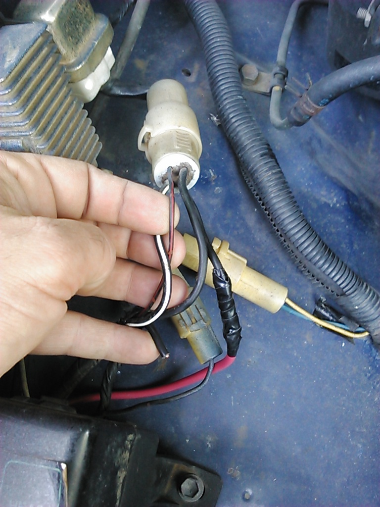

Old May 8, 2015 | 03:08 AM
Terrys87's Avatar
Posts: 11,787
Likes: 28
From: Anderson Missouri
It is the box on the left side of the picture on the passenger fender, closest to the firewall.

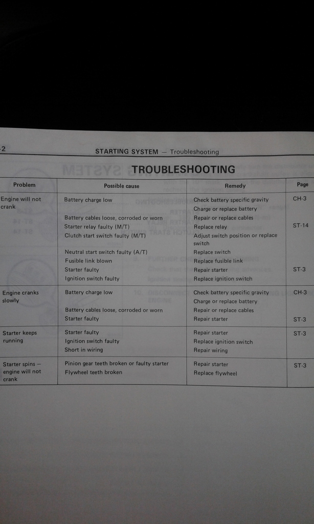

This is the troubleshooting page which lists other possibilities. One of em says faulty ignition switch, that was one of my other guesses as well, and more often than not, does happen. Worth a try if all else fails.
