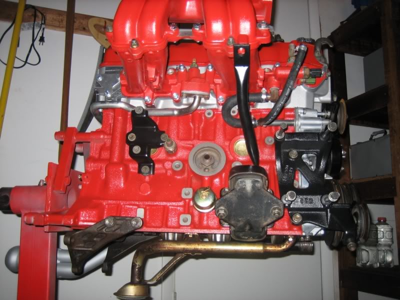

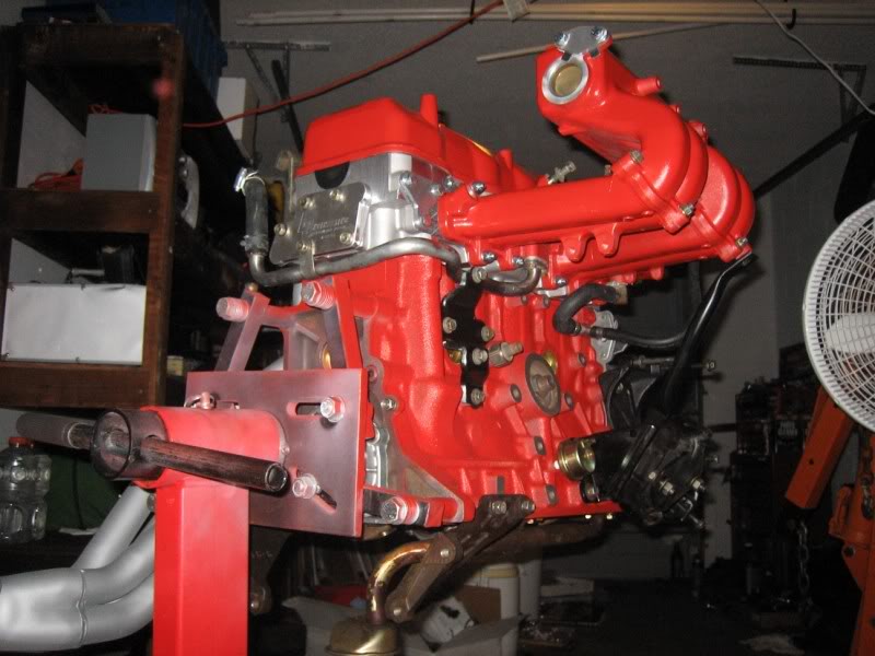

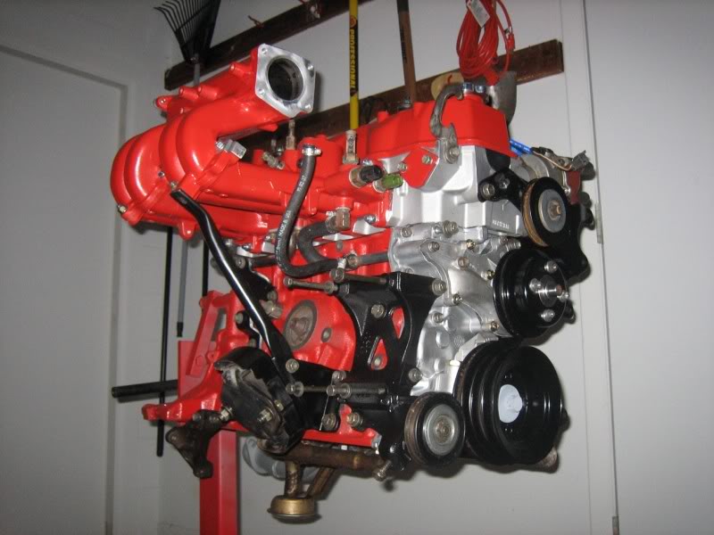

none on mine; no ill side effects that I can tell
gutted it during the engine rebuild

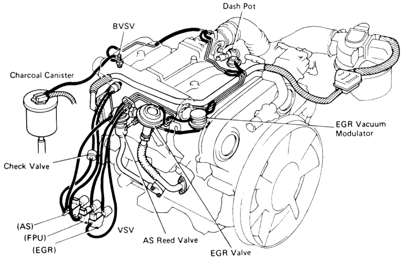

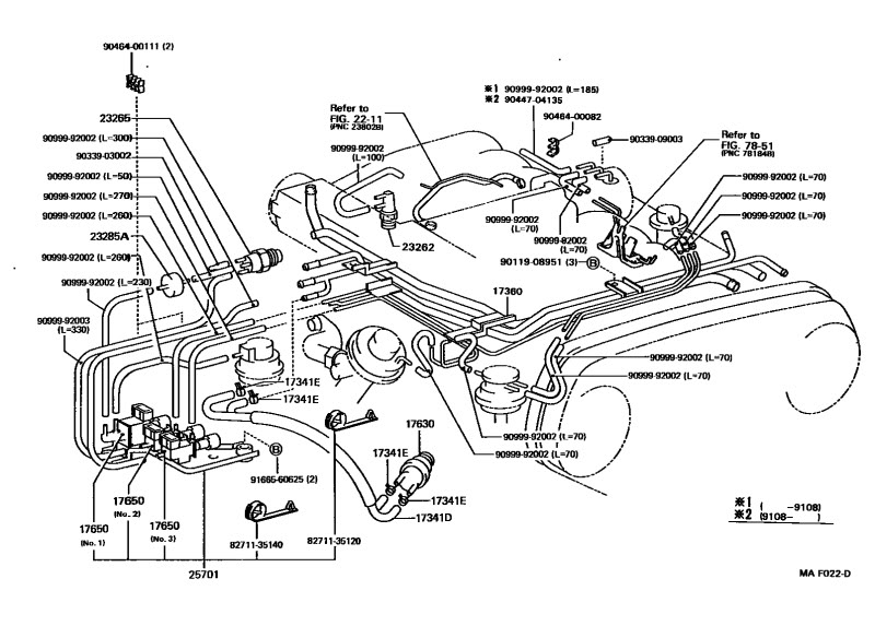

Originally Posted by Brhesson
My question is what to do with the vacuum hoses, etc. any pics of that aspect would be helpful.
You can remove them or just plug all their ends. Depending on what year your vacuum lines can be routed numerous different ways. So pics won't always match up with what yours look like.
I'll give you a few clues on what to do as far as removing them goes.
1. There's 3 brass vacuum tubes on top off the throttle body. Each one has a letter mark next to it. P is for the EVAP purge port, don't touch that one. You can plug up the ones marked E (for VSV for EGR Valve)and R (for EGR Vacuum Modulator).
2. Then disconnect all the hoses between those 2 tubes(E/R) and the EGR VSV and EGR Vacuum Modulator and all the hoses from the 2 VSVs to the EGR Valve and PAIR Reed Valve. The VSV colors are blue(PAIR) and green(EGR). The brownish one is for the fuel pressure regulator, don't touch that one. You can leave the blue and green VSV plugs connected or remove them. It makes no difference to the ECU. And the switch consumes minimal voltage, so unplugging them's not going to gain you anything really.
3. I plugged the vacuum tubes on the throttle body with a dab of RTV. Shoved maybe about a pea-size bit in their ends to seal them semi-permantly. You could probably use some sort of epoxy for a more permanent solution. Or jam like a BB size ball bearing in the ends of them. There's going to be some other holes on the plenum chamber where the VSV hoses were connected that need plugged too. I used RTV for those too.
I may have missed something but that's the gist of it anyway.
Good luck!
Old Sep 20, 2010 | 12:19 PM
camo31_10.50's Avatar
Joined: Aug 2007
Posts: 5,334
From: Vian, OK
Hey Mudhippy
i would send you a PM....but for some reason i can't find the button to click to send a PM to you?
you seem to be very knowledgeable on the 3VZE vacuum lines and such...would you mind PM'ing me? i have a few questions to ask you!
Old Sep 22, 2010 | 08:37 PM
Brhesson's Avatar
Joined: Jan 2010
Posts: 96
From: Northwest Arkansas
Thanks Mud hippy, you are a wealth of knowledge.... hijack i'm sure...ok so i've posted here b/c not only have i removed the EGR, i am also in full attack of removing the PAIR valve. My question is what do the Thermal Vacuum Switch control it is on the back of the motor, has 2 broken tips, i've attempted JB weld to reattach them, but not happy with the results. So i am considering ignoring it as i have been told it controls only the EGR/PAIR system.....is this correct? What about the Charcoal Canister that's in-tandem with the PAIR?
Old Sep 23, 2010 | 08:55 AM
MudHippy's Avatar
Joined: Jan 2007
Posts: 6,106
Likes: 27
The TVV is for the EVAP/charcoal canister ONLY.
http://personal.utulsa.edu/~nathan-b...76evaporat.pdf
The PAIR is a seperate system entirely.
http://personal.utulsa.edu/~nathan-b...78pulsedse.pdf
Online 93 FSM
A new TVV/Bi-Metal Vacuum Switching Valve(BVSV) is $40-$50. Part # 90925-05047
I kept my EVAP. It's a good thing.
Sorry, no PMs, too busy....
http://personal.utulsa.edu/~nathan-b...74layoutan.pdf

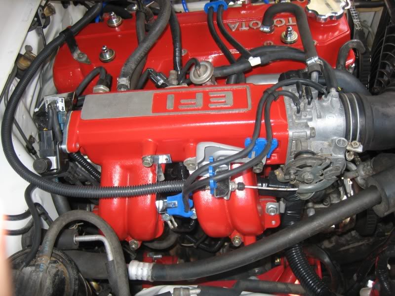

Originally Posted by iamsuperbleeder
bleeder......where'd you get all the fancy, blue vac line clips and throttle cable housing? That's still one of the cleanest painted motor's I've seen. I painted mine very similarly, but the paint's flaking off the valve cover. What paint did you use? Or, this all in your build thread?
