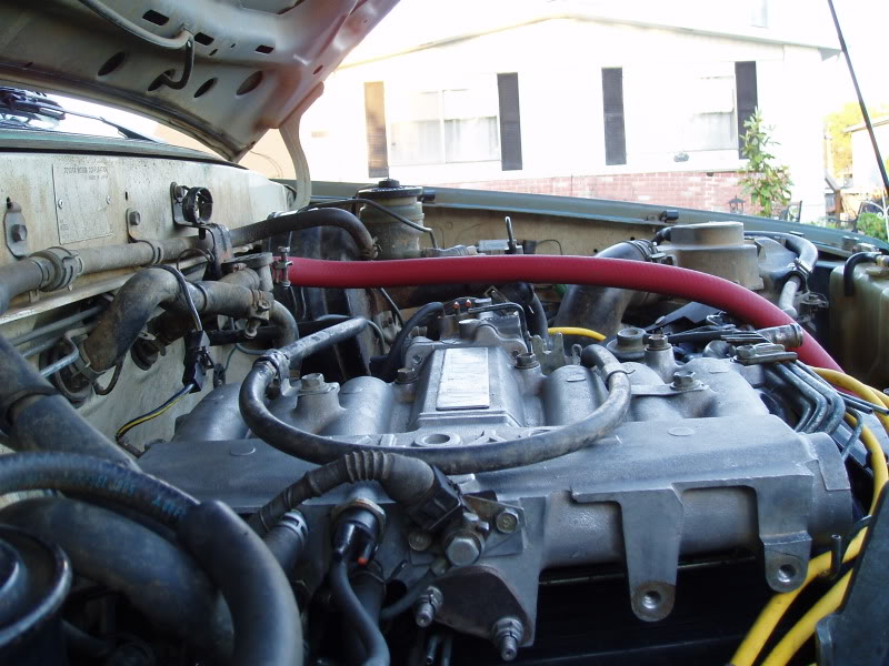

These are my 88 3VZ-E with the PAIR/AS and EGR systems removed. Vers. 2.0(no pics of ISR mod version 2.5 yet)

I've since done the ISR mod. And have removed the steel vacuum, fuel, and coolant lines that ran under the intake plenum chamber as a unit. I also re-installed the plenum chamber stay/bracket, after drilling it out for weight reduction. Pics soon...hopefully before I move on to vers. 3.0(ISR - stock air box + hi-flow air filter)

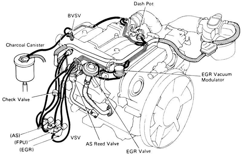

Mud hippy where did the second diagram picture come, from the first is from the FSM.

Originally Posted by Andy A
Mud hippy where did the second diagram picture come...
I can't recall on that one. But it could be from another thread here somewhere. I'm always saving pics like that for later use.
I've got that one and this one that goes with it.

just want to say thanks to MudHippy again for the great diagrams and photos. when i deleted my egr/pair systems i made a mistake and used your photos to help me fix it. Thanks again and keep on loving the 3vze, btw my truck is a rocketship now. its definitely a 3.GO!!!
