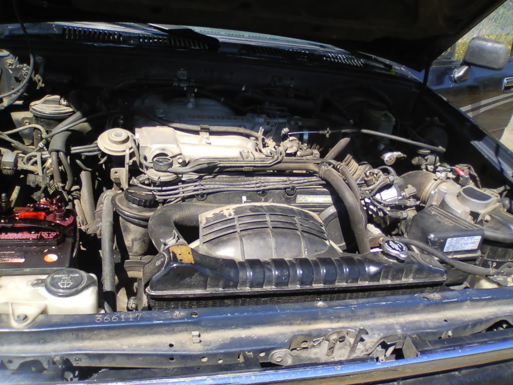

Here are the pics I promised.
BEFORE

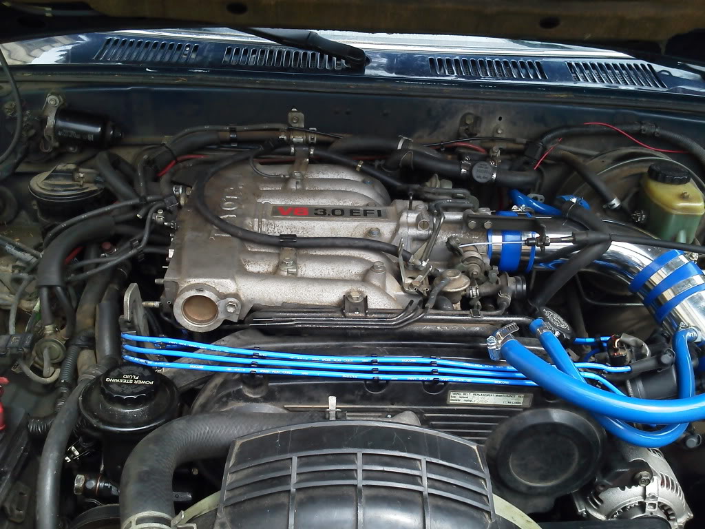

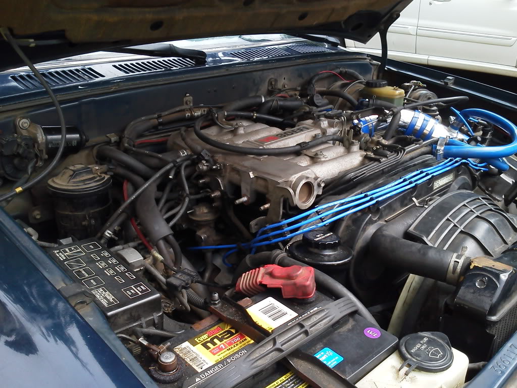

AFTER

What da ya think?
Mike!

That looks very nice, I want to do it so bad but two things are stopping me. One: I am pulling the toyota up to Durango, Co on sunday to be up there for the week of the 4th July. I am worried with my dumb luck I will mess something up and it won't run right and then I can't do any of the passes I want to go wheeling on. Two: I still have to pass emissions/ visual inspection and am worried if I take it off and they fail me that I won't be able to remember where everything (vacuum lines) goes.
