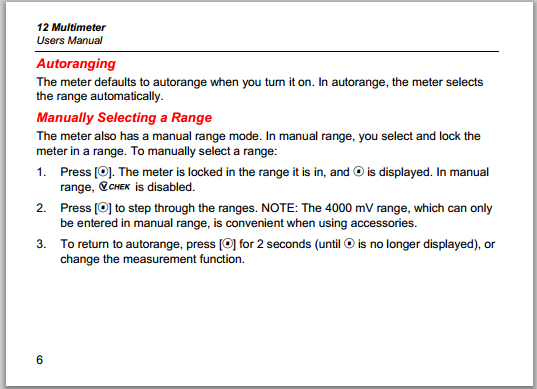

Huh? If the meter is fancy enough to autorange, it's fancy enough so that you can turn it off. (I've attached page 6 of the Fluke 12 manual.)
(The Fluke 12 is a very good meter, but it's designed for "people who can't figure out how meters work." One with an actual range switch would suit your purposes better.)
