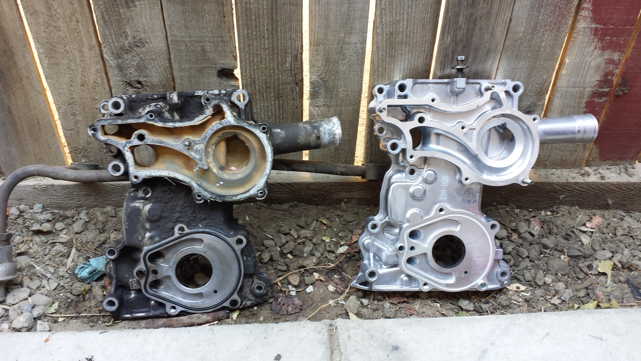

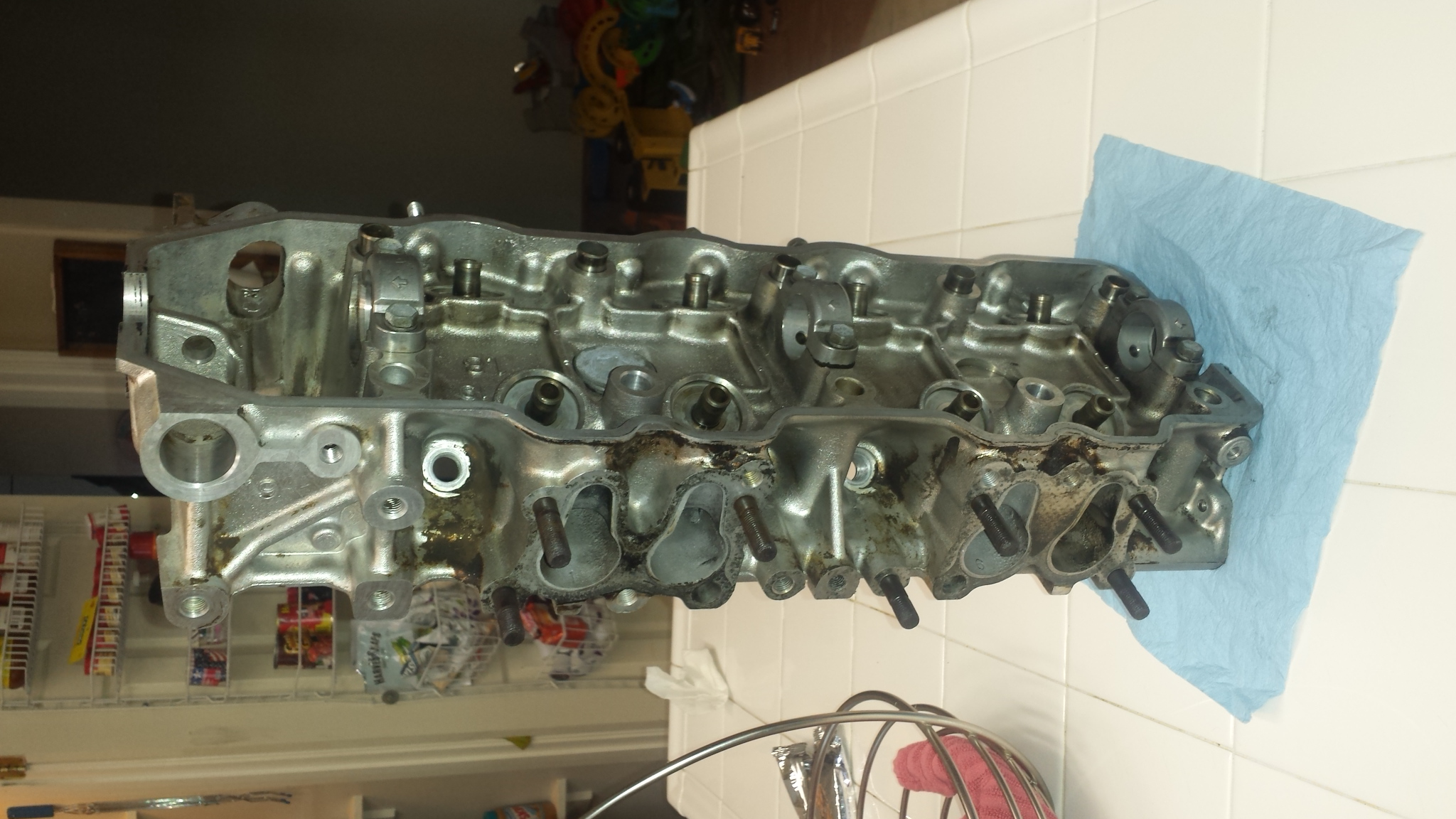

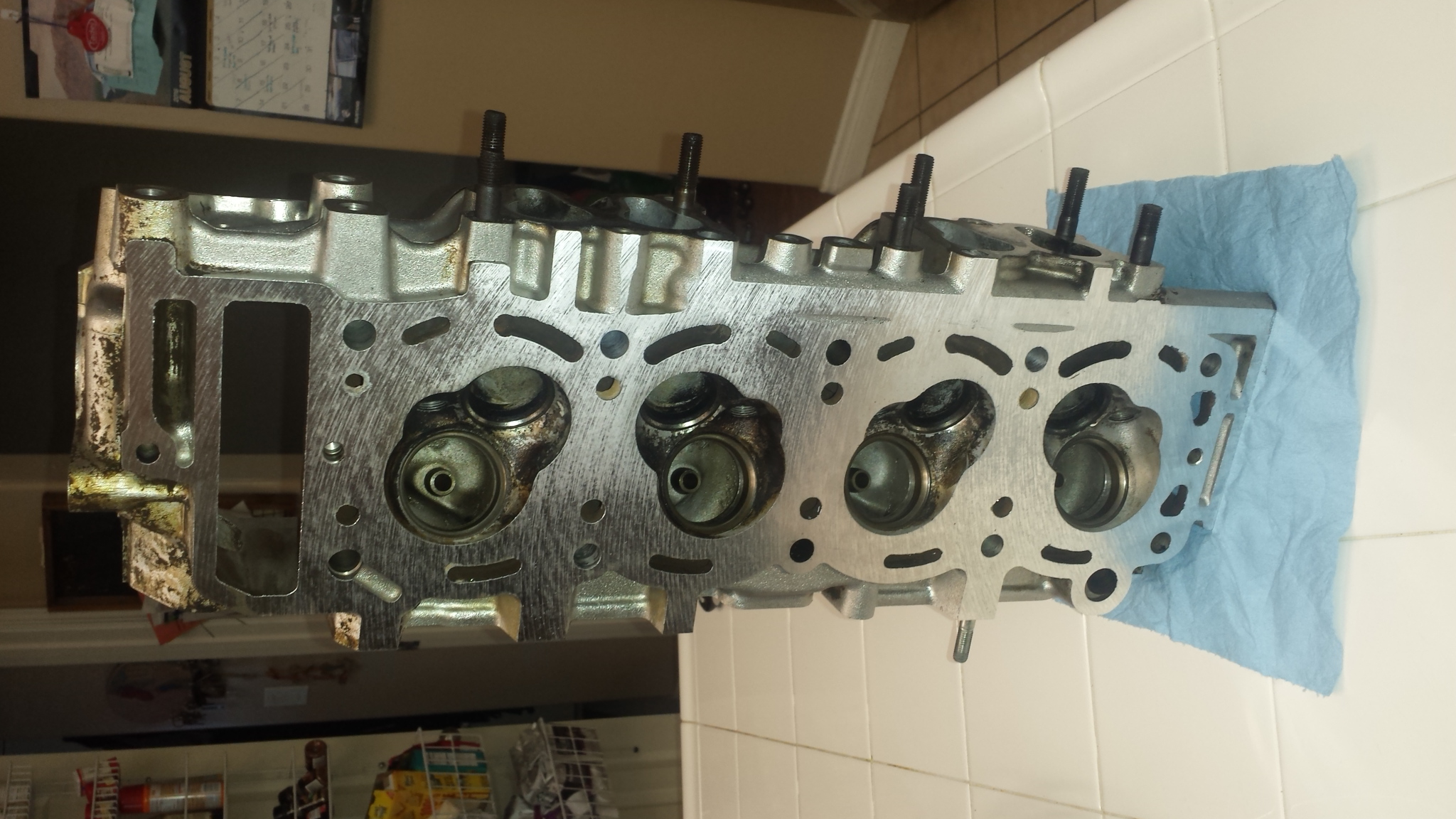

Pics of my cyl head and new timing cover.
Purple power cleaner, a brush and a red shop rag works good

Originally Posted by lalojamesliz
I was going to use a small length of vacuum hose with my drill. It really doesn't do much huh? Damn
lapping compound is highly abrasive, using it with a drill would be like using a 100-grit sandpaper disc on an orbital sander... that's why you only want to use it with the suction cup on the stick, seat width is important.
all that proper lapping does is knock down rough spots and give you a visual confirmation that you have full sealing all the way around the valve, it is never any kind of a substitute for a real valve job.
if $$ are forcing you to half-ass the build by skipping the valve job, at least put some prussian blue on the seating areas, spin the valve around with the suction cup tool, and confirm that you have matching even surfaces.
ideally that would have meant first keeping the valves matched to the cylinders that they came out of... if the prussian blue test shows blue material left anywhere on the seating surface, it needs a valve job, period.
more on valve jobs and valve lapping here: http://www.dotheton.com/forum/index.php?topic=28553.0
did the machinist offer an opinion on whether or not the head needed a valve job?
that head needs to be covered up or in a plastic bag, because dirt will get into the oil if the inside of the head isn't kept clean.

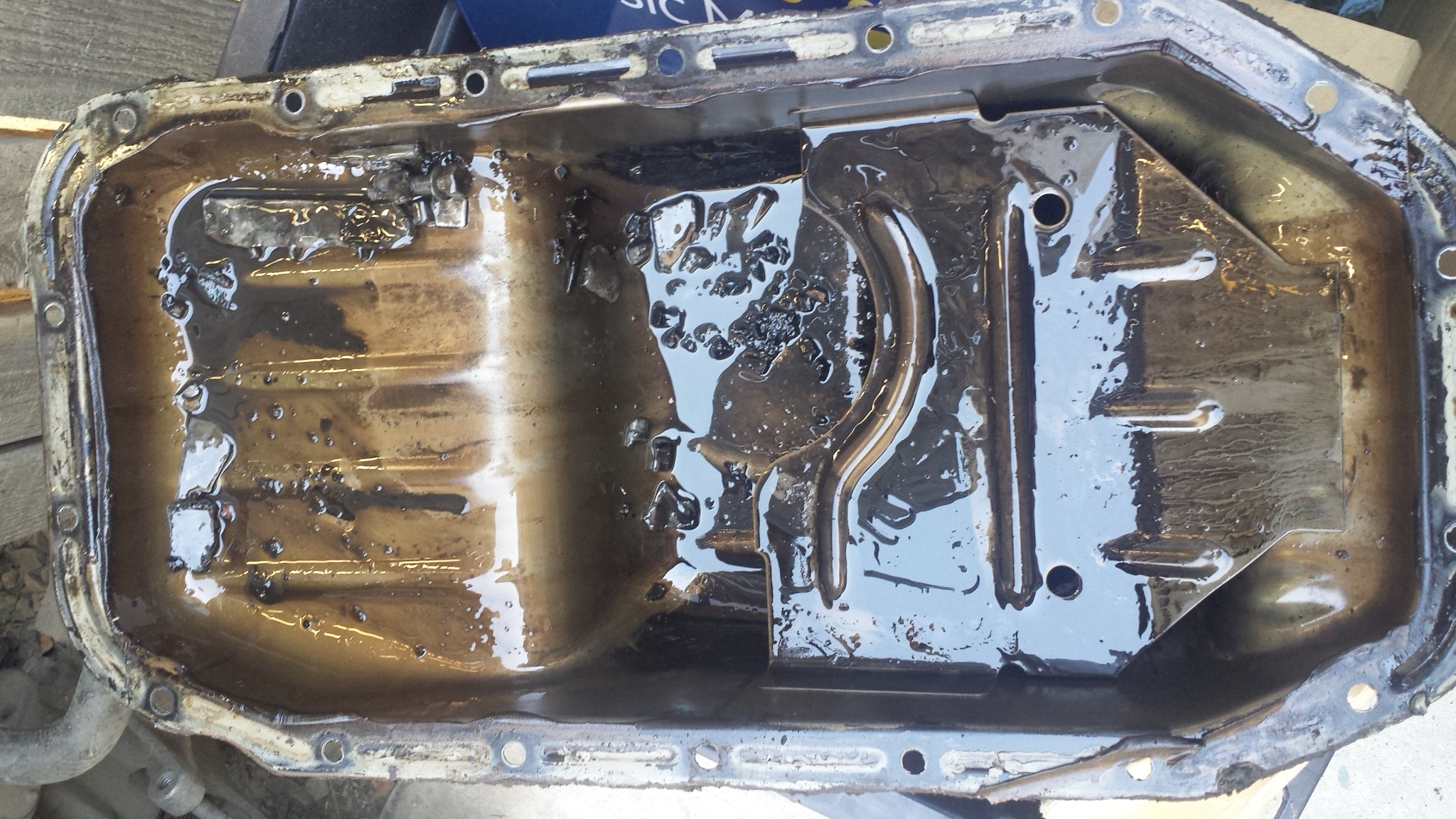

And this ladies and gentlemen is why it's important to remove the oil pan when doing a timing job. I dropped the bolt in and a small chunk is from my timing cover when I broke it but the rest.......?

is any of it metal? you could try shining a flashlight up into the piston bore areas, see if any of the piston skirts are broken off.

Good idea. I was only able to remove the pan and drain it before I ran out of time and had to leave.
I'll check for metal and check the Pistons in the morning since I'm at work now.

Everything looks fine. All that stuff is the plastic chain guide that broke off! I got chewed up on its way down to the pan.

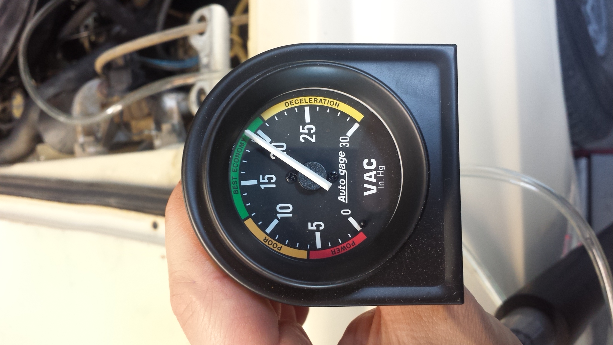

I just did the compression test....
#1----178 or 179 psi!!!
#2---180 psi!
#3---180 psi!
#4--- 170 psi.... whatever, I'm happier than when it was a lot less.
Now at 800 rpm my engine vac is at -19 compared to the 14-15 it was before and I still have the leaking vacuum advance on my dizzy
I'm positive this is the original engine with 172k miles
