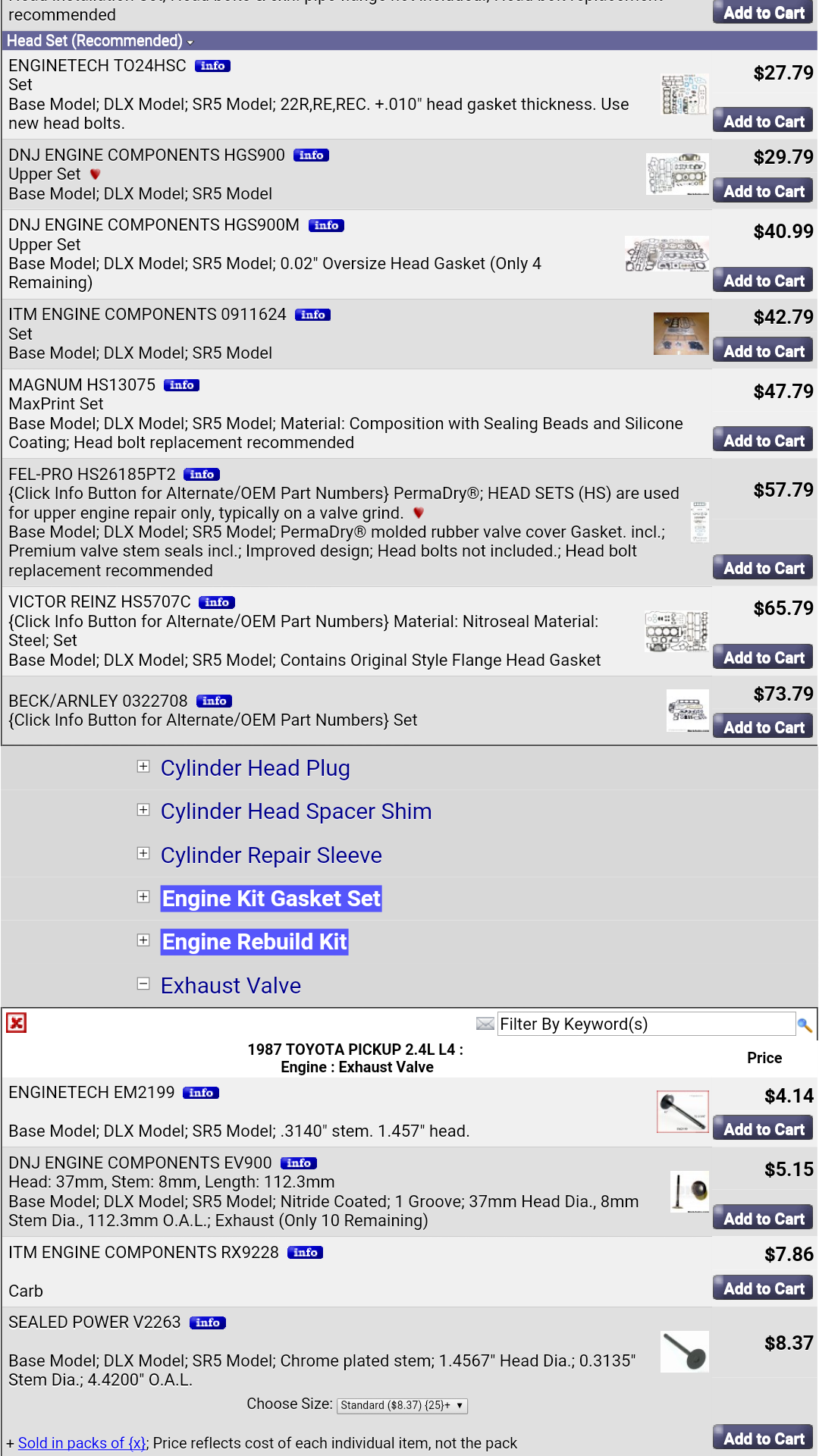

I'm sure if I buy the valves it would be less than if I had the shop replace them. On rockauto they range between $4.14 to double that for the sealed power valves. Do you think the quality is actually better?
What about the headgasket, I know the oem should be the best but any decent brand should be fine right? Same question for the headbolts

You don't need to buy new valves. (Machine shop will clean and re use them)
Your head needs to be resurfaced. (You are stupid if you don't)
The valve seals need to be replaced (they are cheap)
You need to check your valve lash on all valves ASAP.
Use OEM Toyota head gaskets. (If installed right they will last a long time)
Use OEM head bolts. (LCE offers a good price on them)
take le your head assembled to a good machine shop. For cleaning, inspection, disassembly, cleaning the valves, and resurfacing you will probably be into it $150-$250. Add your cost for gaskets and misc parts and if you do the labor your probably talking about $400-$500 total. If you keep trying to cut corners you will pay.
