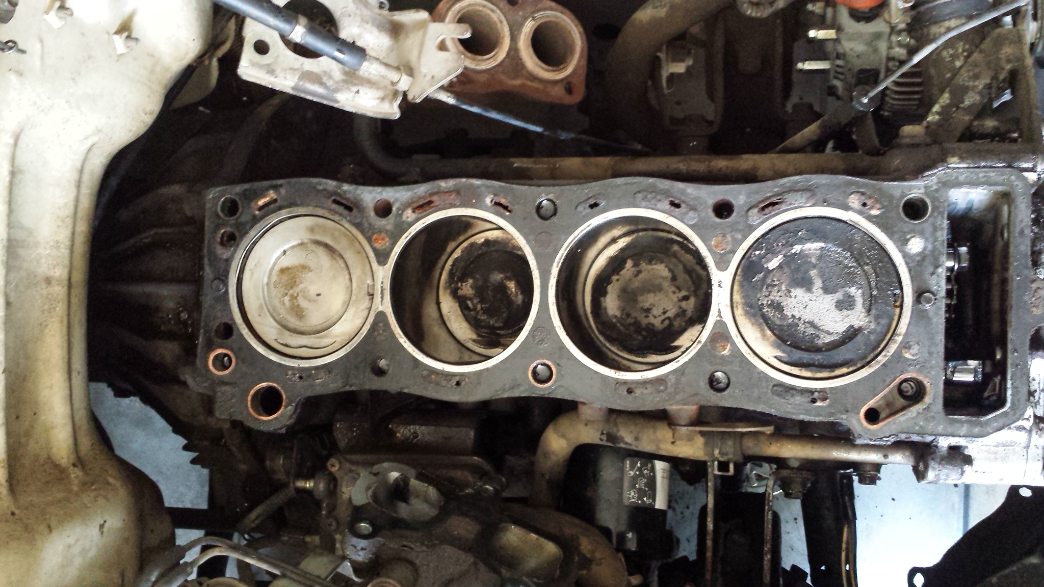

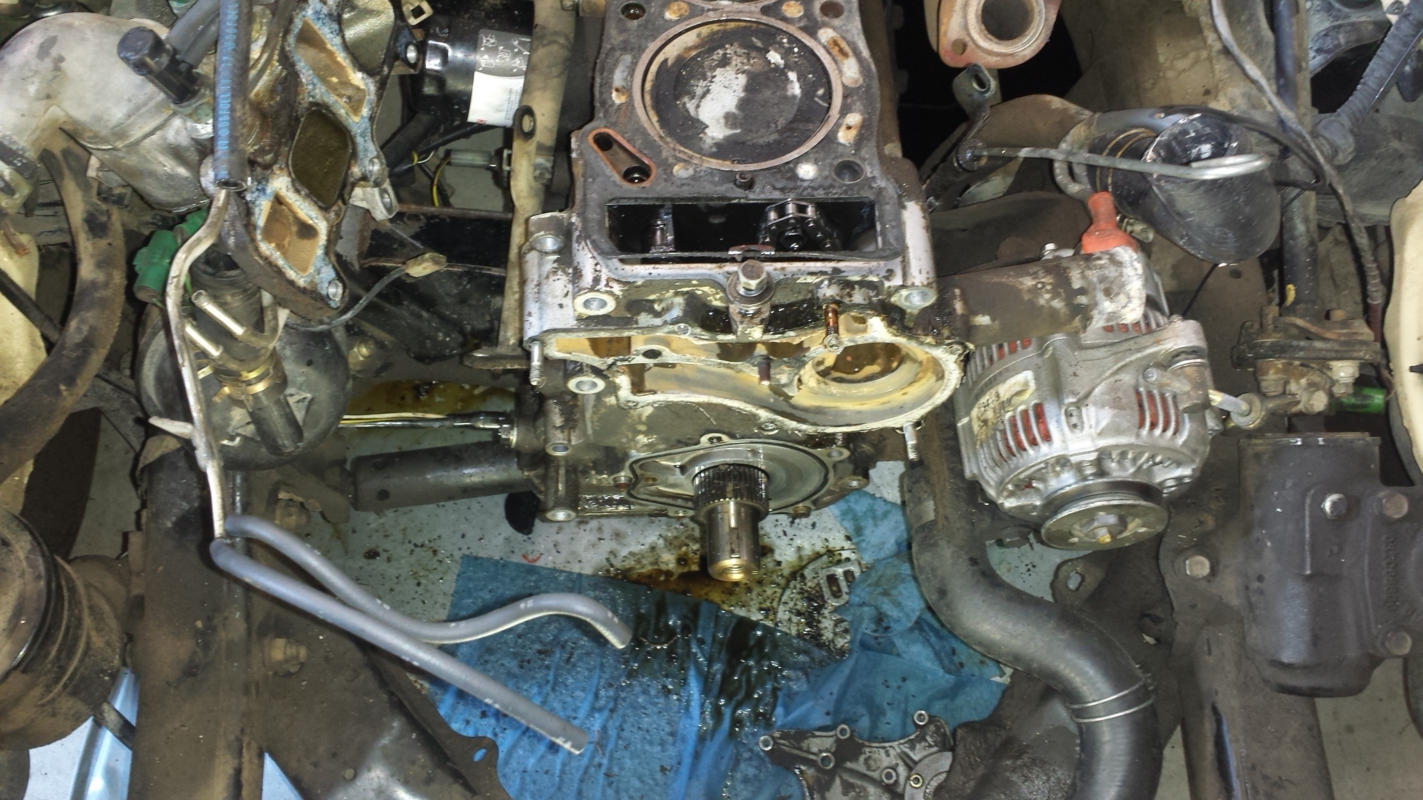

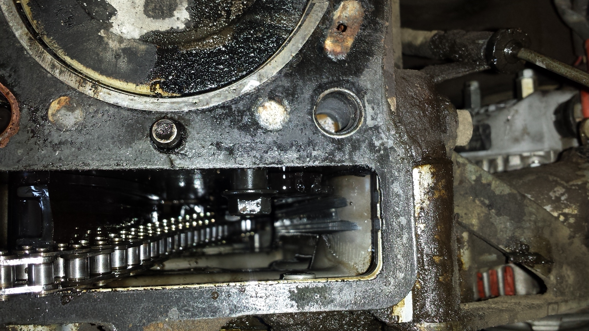

I took off the head this morning but I fell asleep when I was resting.
Piston #4 looks clean but I'll guess the coolant leak did that. #3 had the exhaust valve leak and that valve had a ton of build up on the valve. Way more than any other exhaust valve.
Before I removed the head I was worried about breaking a head bolt from the horror stories I've read on cylinders 2 and 4 being seized often.
I was lucky enough that I didn't have any problems whatsoever with the head bolts.
Both plastic chain guides are broken and I have some nice train tracks on the timing cover. This engine is beat up!
I will remove the oil pan tomorrow morning and I hope to get the chain replaced tomorrow also

I hate to see another 22RE rebuild but it looks like you are doing every thing right. At this point you may want to consider just pulling the motor and doing every thing I the engine stand. Trust me you will save your self a lot of time and head ache.

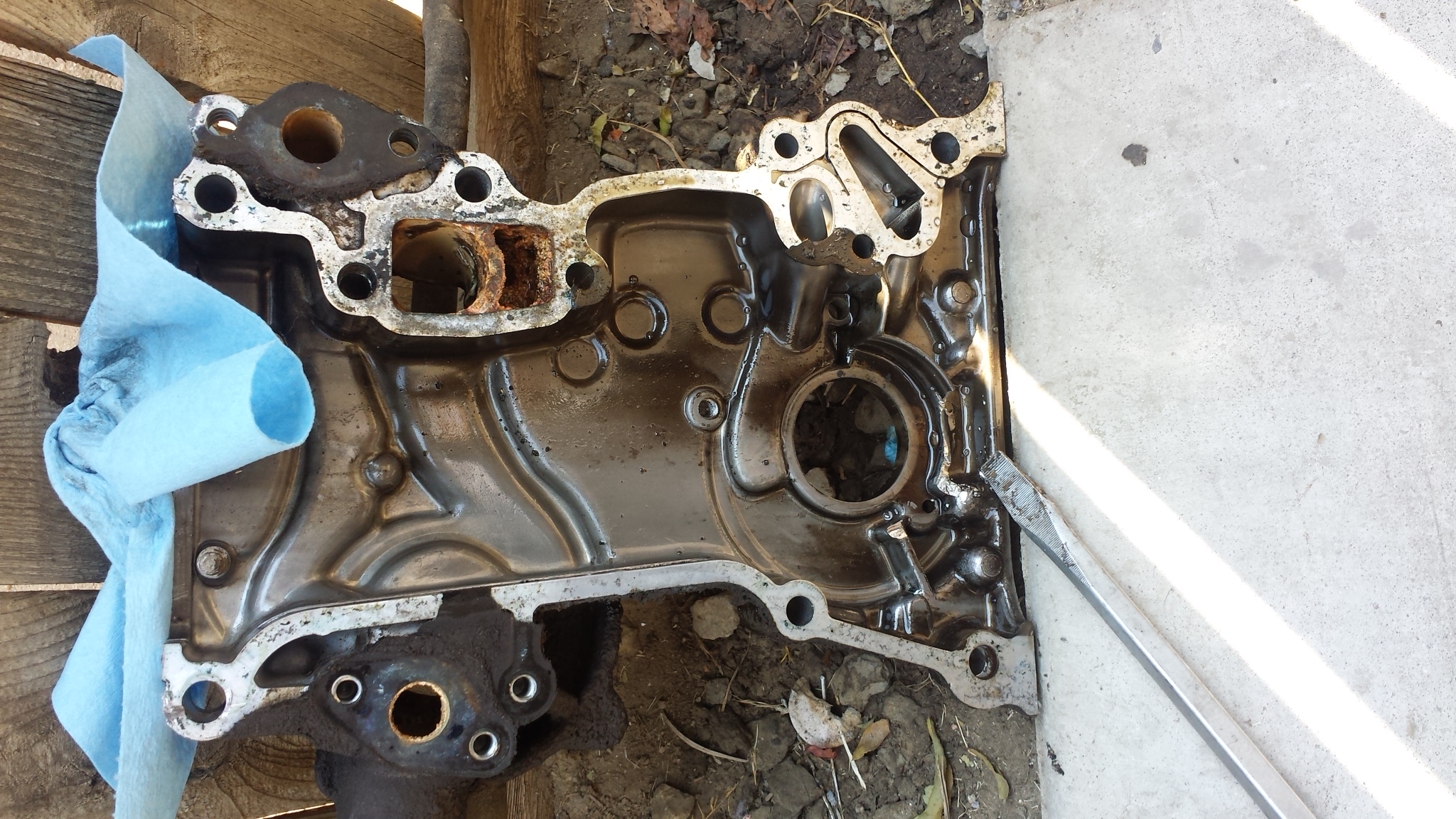

My supposedly powerful impact wrench didn't have the power I thought it had to take off the crank pulley bolt ( aircrat 1150) but the socket swivel and 12" extension probably didn't help. So I used the starter with the breaker bar. But I think since I had the chain somewhat loose I think I broke my timing cover on the bottom. Here's a pic
I am replacing the water pump after all. The old one looks tired and has a little play.
Do you guys think I'll be OK using this cover since I broke a small area off in the of the timing cover with the flathead pointing at it?
I don't see how that guide is needed if the chain is on with tension but I don't know for sure.

Trust me. Pull the motor. If the clutch is good then don't worry about it. If it needs to be replaced then now is as good of time as any.

what do you think about my timing cover issue?

I just ordered a new timing cover. I didn't want to chance if my cover was still good with the broken lip. Plus either a stud or bolt from the middle of the water pump broke in the cover.
