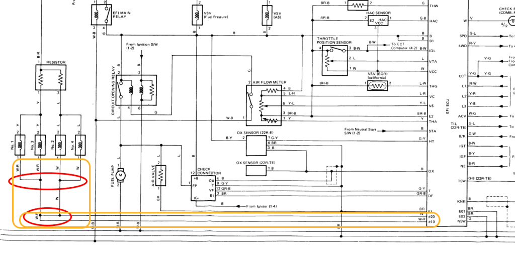

You mean one side of injector connector has 12V and the other also has 12V? There will always be 12V on both sides of the injector when IG is on, unless the ECU pin 10 or 20 connects one side to ground (split second) to fire injectors.
Did you inspect the crimp(s) in red and the wires (in orange)? they connect to ECU so it can ground the negative side of injectors. They're tucked hear hot intake manifold, get corroded and stiff and easy to break.

Yes, both sides of the injectors connection has 12 volts. Are the th wires in the diagram connecting the injectors to the ECU? I haven't checked those connections but will do that next.

I checked all the wires and terminals that RAD4RUNNER mentioned but everything seemed to be in good shape. I was told that I could test the injectors by removing the distributor and rotating it while listening to the injectors. As I rotated the distributor I could hear all 4 injectors making a clicking sound. I don't know if fuel was passing through them but it sounds like they were opening and closing. I am getting fuel to the cold start sensor but not sure where to test for fuel past that point. Another question I have concerns the timing. I have been told to set the timing mark that is located on the harmonic balance to "0" others say to set it on "5". I've also been told that setting it on "0" is for the engine with a carburetor and setting it on "5" is for EFI. I have a four cylinder that is fuel injected, which mark should I place the timing mark on? And will there be enough difference between the two marks to keep the engine from starting? I placed a screwdriver in the #1 spark plug hole and when I reached TDC the timing mark was on the edge of the metal plate that is used for timing. Mine doesn't have the numbers written on it like the ones online has but it would be on the edge near the "0". And the marks on the cam should be straight up,12 o'clock, right? Thanks for all the help i've been receiving.
