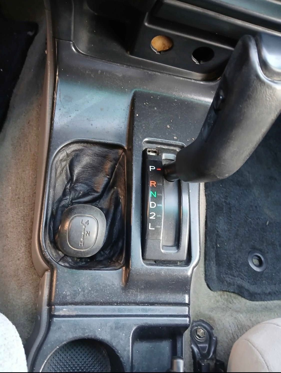

From this set up:
to this set up:
I’m thinking measure the width and length of the auto set up to see if I have to cut to fit the shifters into the manual cab opening……

The only thing I can offer is that I had two 1986 Xtra Cab trucks. One was manual trans, 4WD and the other was an auto trans 2WD. The trans tunnel was definitely different as far as the shifter hole. I don't remember if the rest of the tunnel was the same. I also don't know if the 2WD cab has provisions for the clutch and brake pedal bracket and things like that. Just stuff you need to be ready for so don't get rid of anything until you're done with your swap.

The colored plastic trim bits are the same for both auto and manual, the plastic piece surrounding the shifters will fit into the trim bits/ oe dash bezel whether auto or manual. same goes for the center console. I'm not sure about the tunnel itself, been awhile since I've seen an auto tranny tunnel in the naked. If they are different it shouldn't be by much given the trim limitations. I know the transmission mounts are different, but don't know about the cross member(s), and the drive shafts are different length too.
Maybe look into what has to be done for the auto to manual trans swap that people have been doing for ideas on what you need to do to make the reverse happen?
