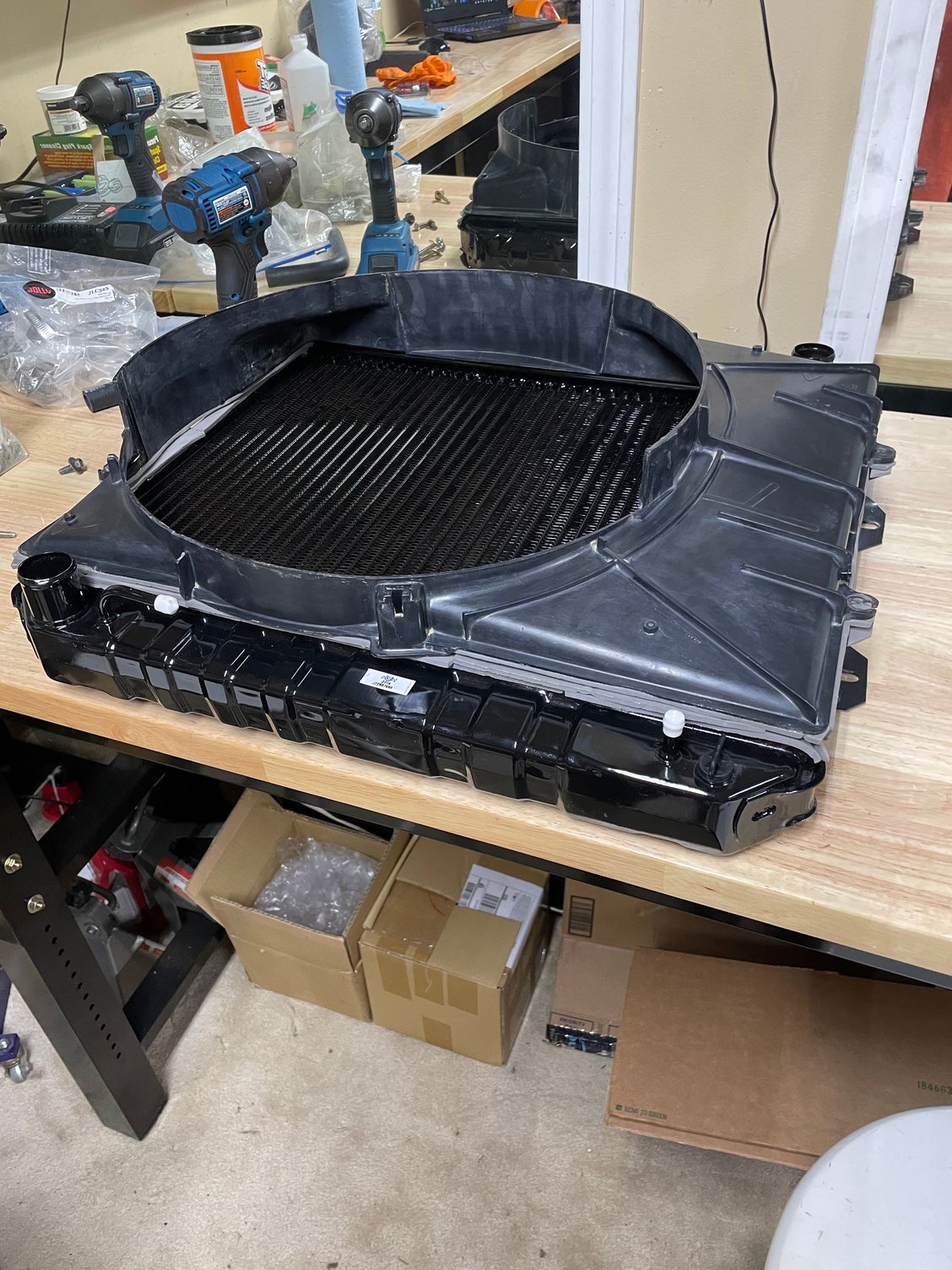

I'm in the middle of swapping a CSF 2314 radiator into my '94 XtraCab 22RE manual in place of the no-name eBay all-aluminum 3-core that started leaking after ~5 years.
While I've got the rad out, I'm looking to seal up the airflow between the rad and the A/C condenser so that the stock mechanical fan and shroud will draw more air across the condenser (rather than some air pulling from around it).

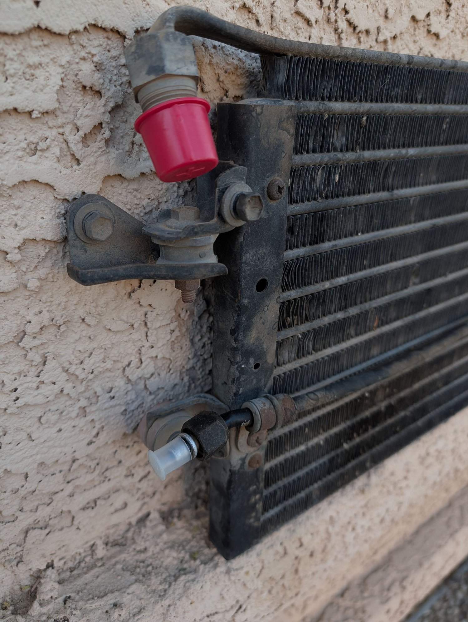

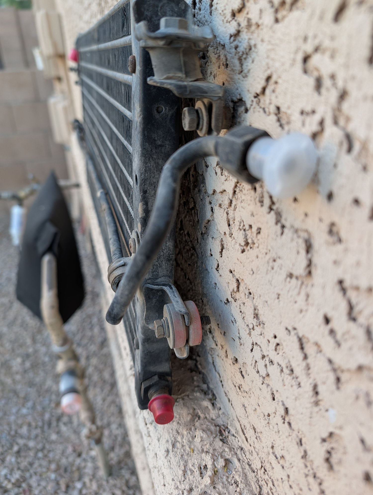

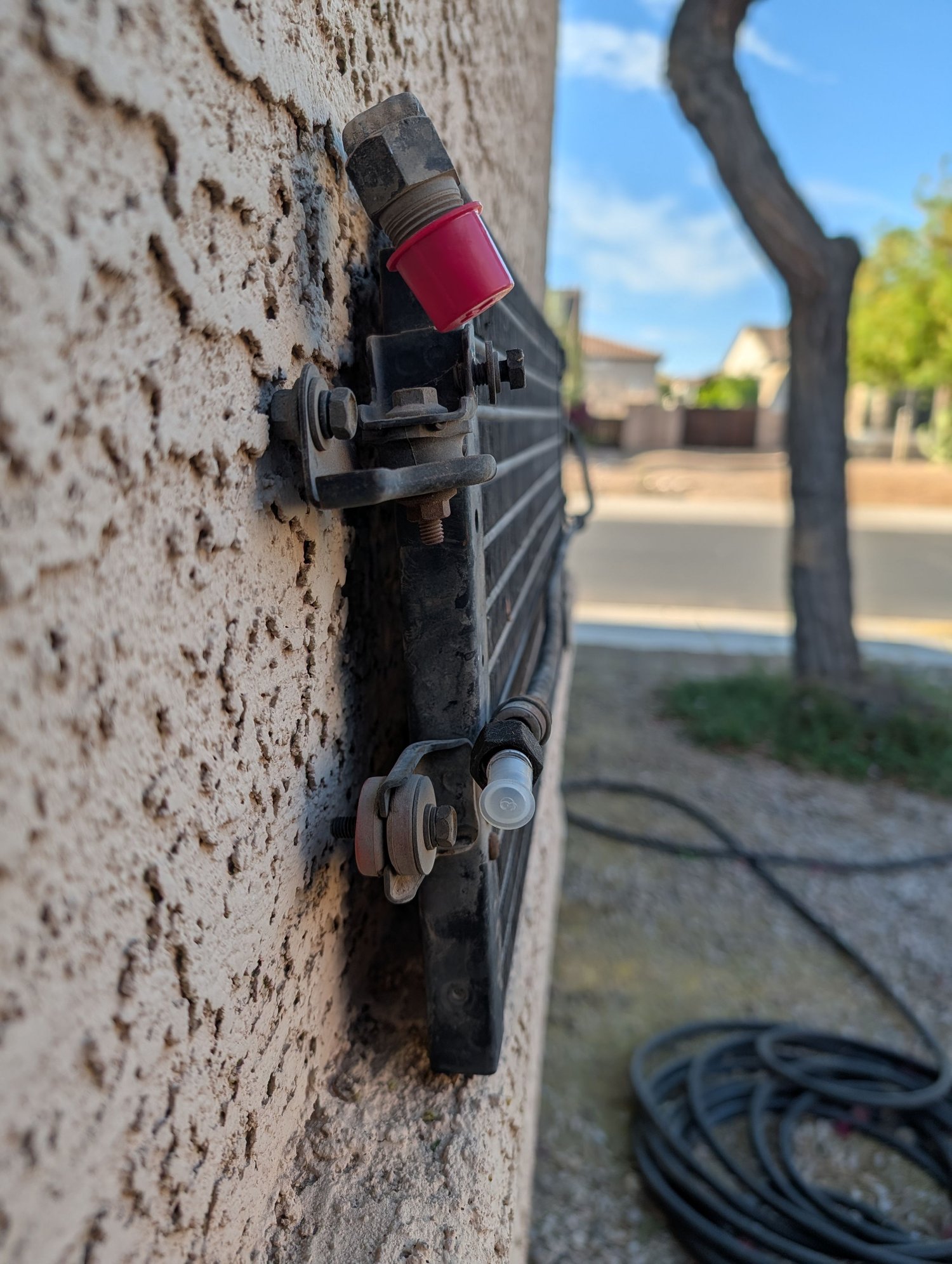

Here's a few pics of my OEM 84-88 condenser.

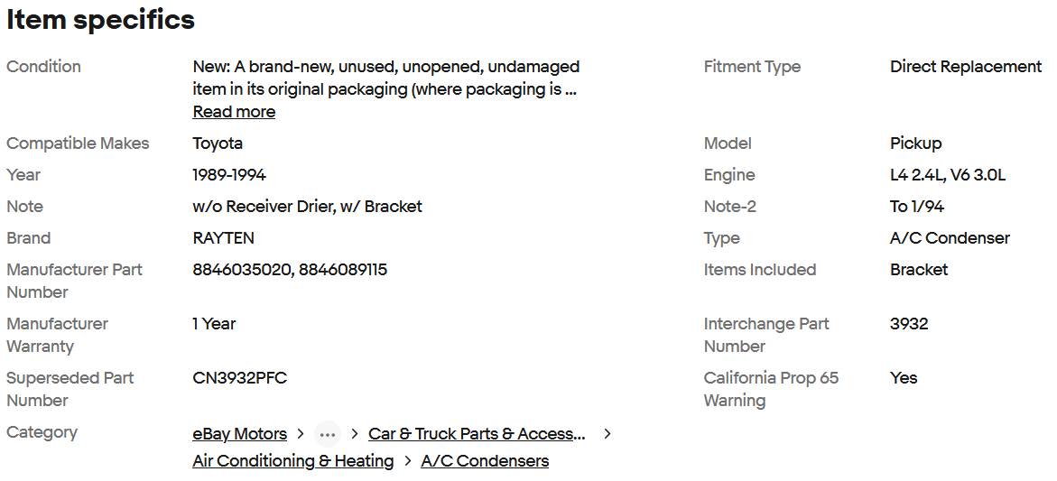

That 7013932 part number still brought up serpentine style condensers for me, but on eBay, some of the related items were showing parallel-flow condensers with different part numbers, so it ultimately lead me to a PF replacement! Thanks man! One of the reviews for one of the ones on eBay says it didn't fit his '94 4x4 pickup though, so that's a bit concerning.
Can't help but wonder if that dude's '94 was a build date after 1/1994 and that caused the incompatibility, or maybe something to do with dealer-installed A/C vs. factory-installed A/C since, from what I think I've read, the connection fittings were dreadfully all different between the 2.

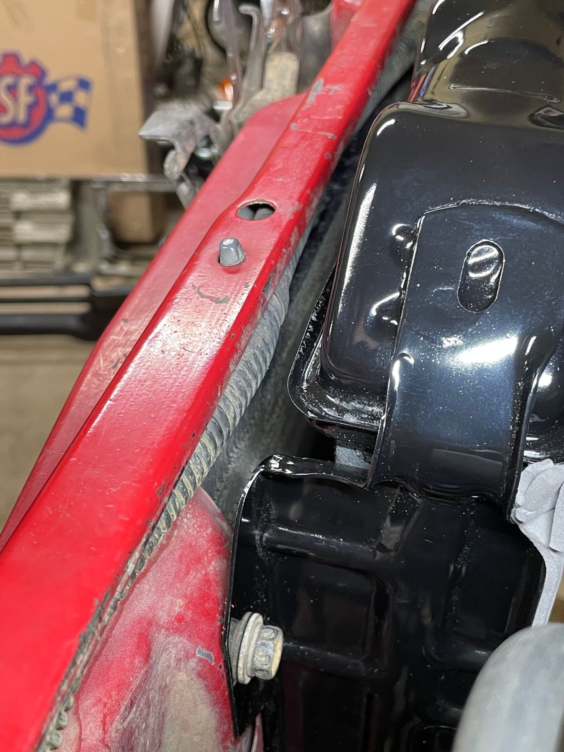

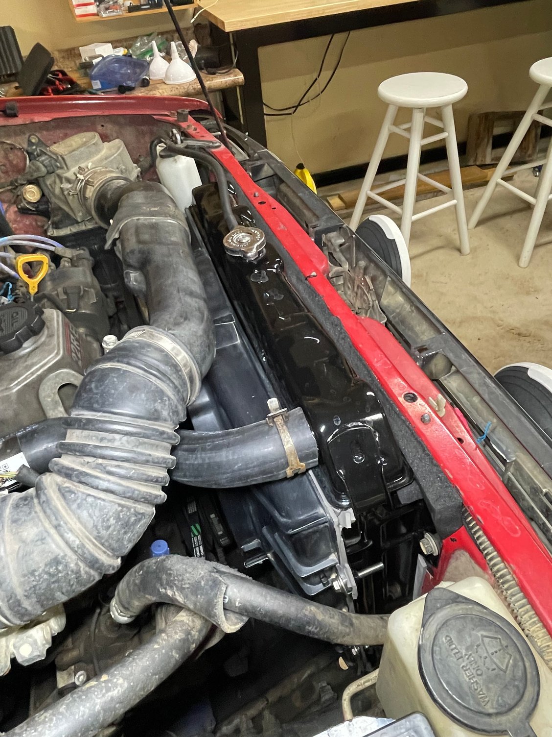

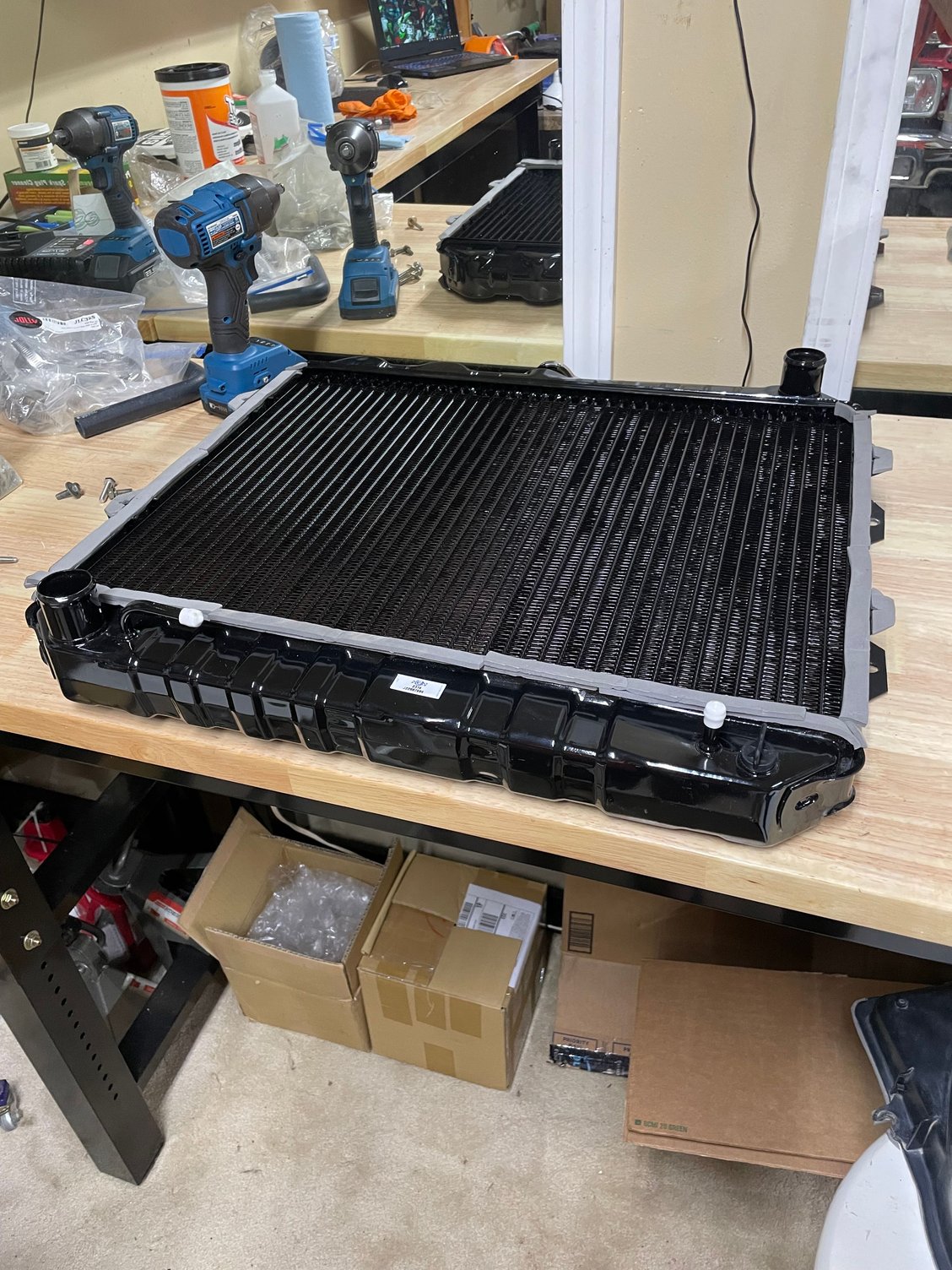

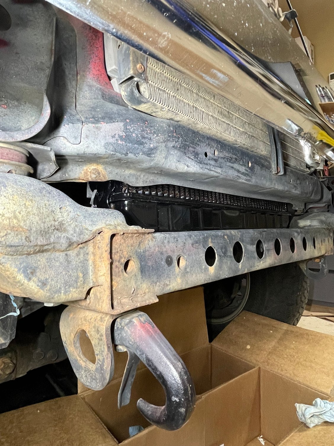

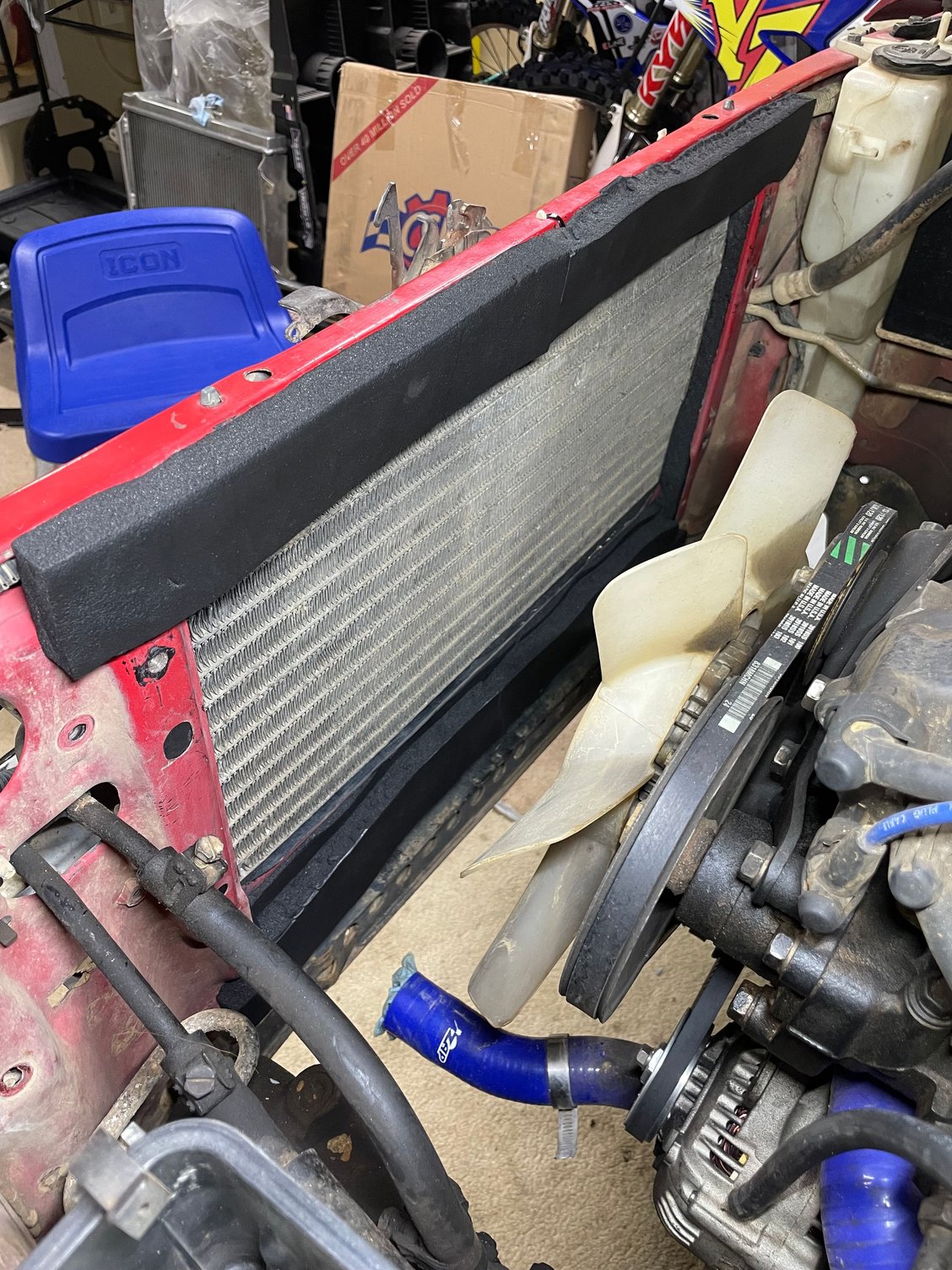

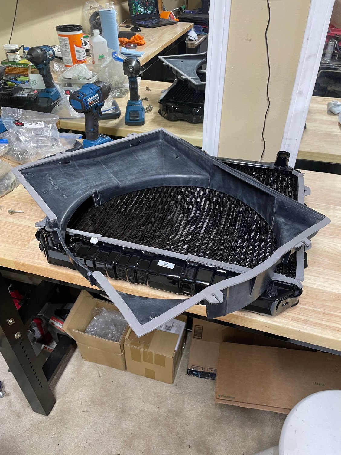

I’ve finished adding foam to the new radiator and surrounding areas and it’s all reassembled. Figured I'd update this thread with some pics of my work.
^^Radiator and shroud foamed.

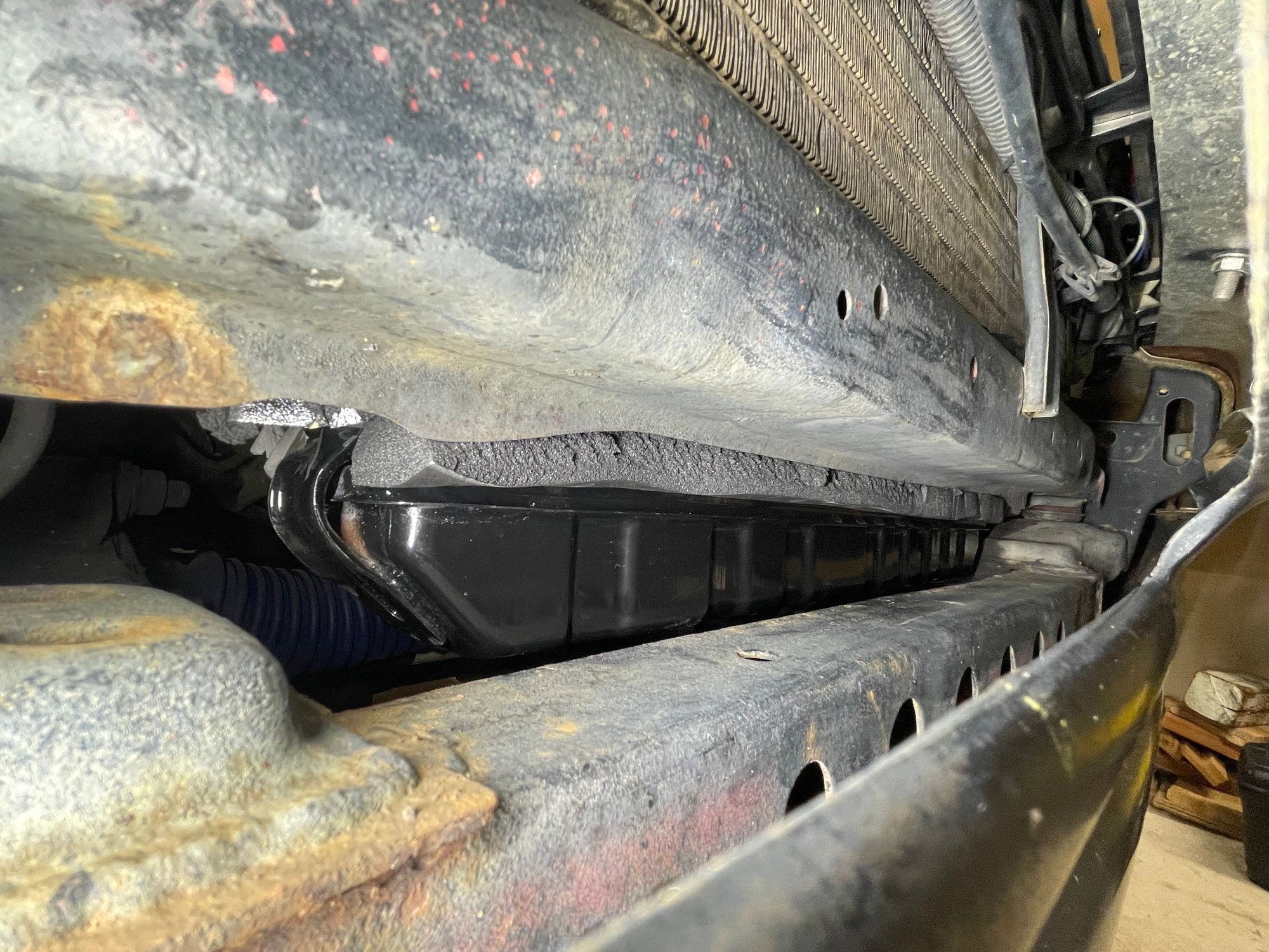

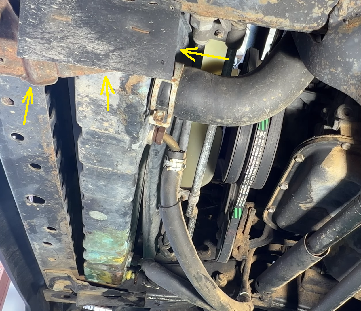

Foam needed to seal bottom edge of radiator core to core support.  This is with the CSF 2314 radiator.  The taller 2306 radiator extends further down here, which negates its usefulness if it’s gonna get blocked off with foam anyway.
^^Before foaming. Disregard the light grey foam tucked in on the sides of the condenser as it didn’t fit as well and was just test fitting at that moment. I believe it’s visible on a pic or more in an earlier post I made in this thread, along with some packaging foam I used for mock-up before the nice black foam arrived in the mail.
You can see how foam’s needed to seal bottom edge of radiator core to core support. This is with the CSF 2314 radiator. The taller CSF 2306 radiator extends further down in this area (bottom tank is 1” lower, top tank is in the same location), which negates its added usefulness if it’s gonna get blocked off with foam anyway.
^^After foaming.

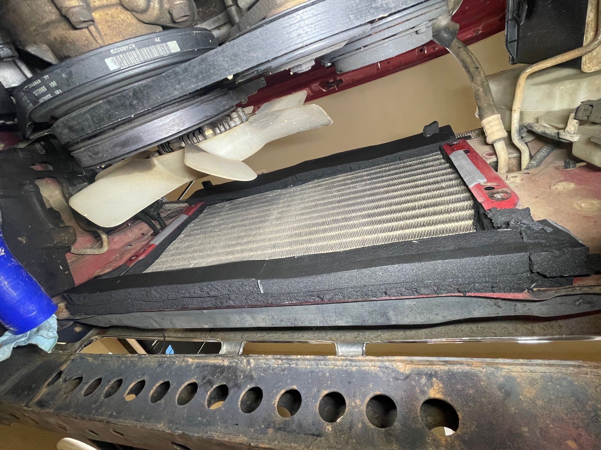

Before adding the thin grey vertical strips that seal the thin gaps of the radiator’s mounting flanges to the core support.
^^Most of the way done adding foam but not finished. This is before adding the thin grey vertical strips that seal the thin gaps of the radiator’s mounting flanges to the core support.
Note the black foam filling in the lower core support channel underneath, and the black strips sandwiched between the back side of the A/C condenser and the core support. You can’t see it here but there’s foam along the top and bottom edges of the condenser as well.
^^After foaming. Notice the 2 wedge shaped pieces on the sides, near the bottoms, to fill in the triangle shaped openings of the radiator mounting flanges.
Before adding top foam.
^^Before adding top foam. This top gap is big, but I believe it was even more obnoxious with the eBay aluminum radiator.
^^Fully assembled.

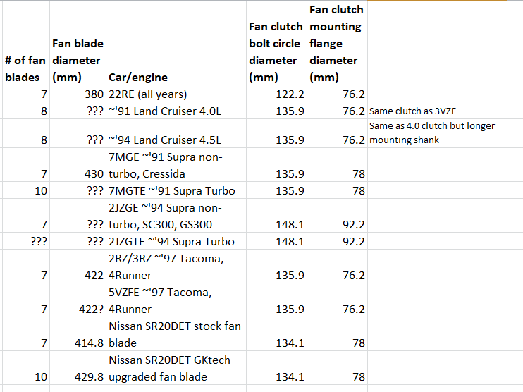

I’ve tried to be pretty thorough to get as much airflow from the stock fan across the A/C condenser as possible.
Perhaps the stock fan and fan clutch could be improved upon if I modified the clutch by swapping in some really thick, viscous RC differential fluid. Something to consider for sure.
Makes me wonder how the airflow compares at idle between the stock fan clutch setup, a modified (thicker oil'd) fan clutch setup, and the LCE Flex-a-lite fan setup, although I'm not sure what the current consensus is on those units.
It’s tempting to try to reduce the shroud diameter around the fan a bit with a thin layer of foam lining the shroud’s “bore” since I think that’d also help make the fan more effective, but don’t know how close the blades get to contacting the shroud as-is when the motor mounts flex under torque, bumps, etc. Might look into it. Maybe I could experiment with some flaps made of blue painter's tape stuck inside the shroud bore, then drive around for awhile and see how much length of tape-flap gets chopped off to get an understanding of how much it all moves around Lol

So is this going to force ALL radiator airflow through the condenser only? This will be a good test for your cooling system and your A/C. I'm looking forward to seeing how it works out.
I have seen the thicker fan clutch oil mods on some 80 series Land Cruiser posts and they work for those guys. I saw some posts on swapping in fans with more blades from other models Toyota's. I'll have to see if I can find it. I think they were fans from diesel powered Land Cruisers.

Yep, ideally all or like 98% of the air moved by the fan will be forced to pass through the condenser first.
I had the thought cross my mind about there possibly being some superior fan blade that'd fit on the stock 22RE clutch, or perhaps a different clutch would be needed for said fan blade yet that clutch can fit the 22RE water pump pulley studs (even if drilling 4 new holes would be required).
I poked around on RockAuto looking at a few different specs for fan blades and fan clutches. Nothing I've seen so far appeared to be a purely bolt-on affair, but maybe an adapter could be used to put a better fan on (one with more blades) but there might need to be some trimming of the blades to fit. At that point, I'd be curious to know if it'd be moving that much more air to make it worth the effort.
For whatever it's worth, I upgraded the fan blade on my '92 Nissan 240SX (which I swapped the Japanese market SR20DET turbo 4 cylinder engine into over a decade ago) to the aftermarket GKtech fan blade, which moves much more air than the stock one. I put the specs for that fan on this little list just in case that'd potentially be a viable option to adapt to a 22RE.
