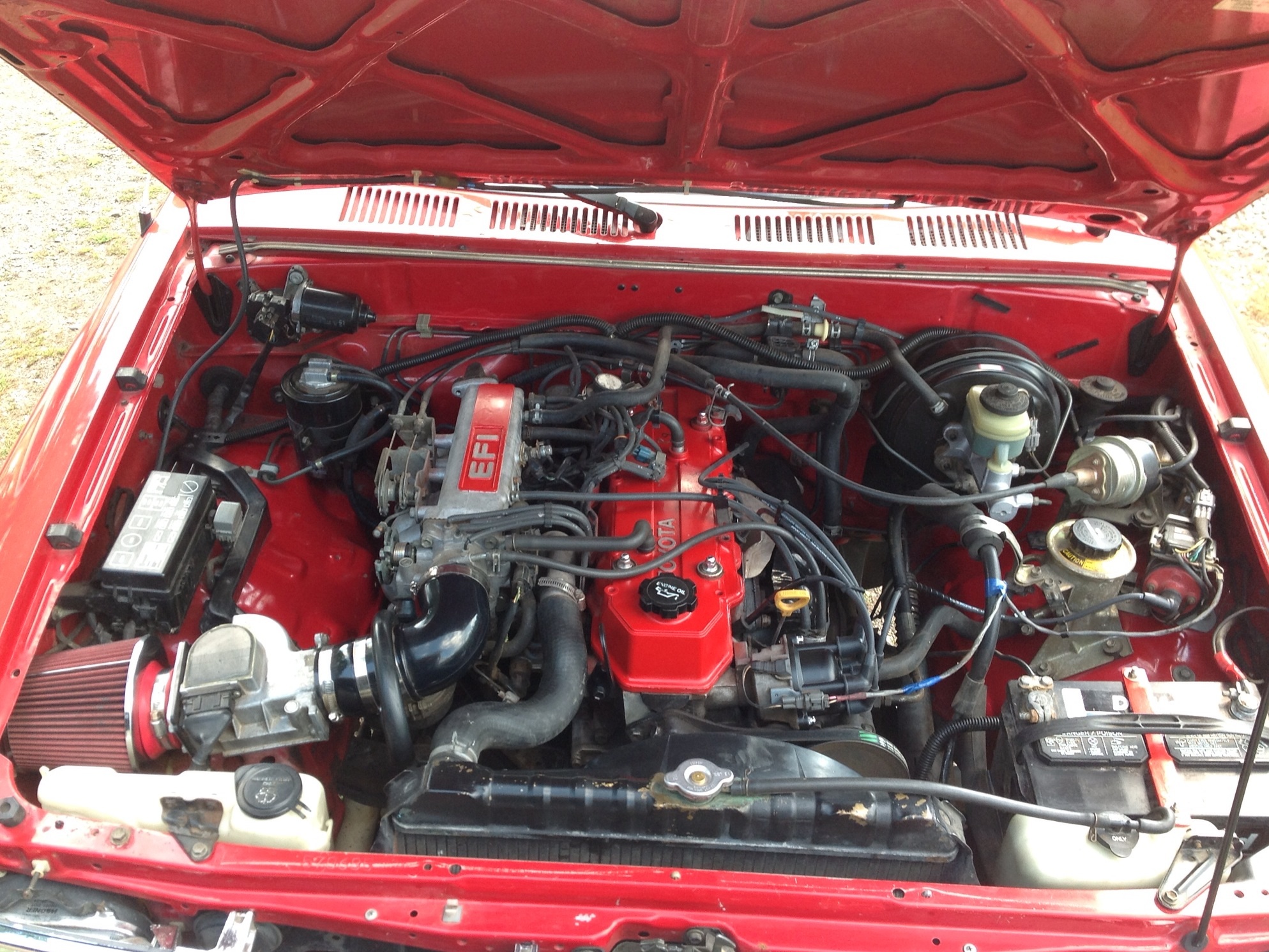

been thinkin of a better cold air intake setup...

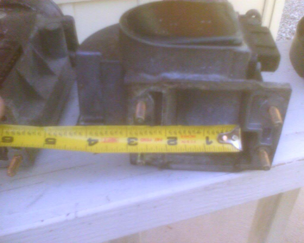

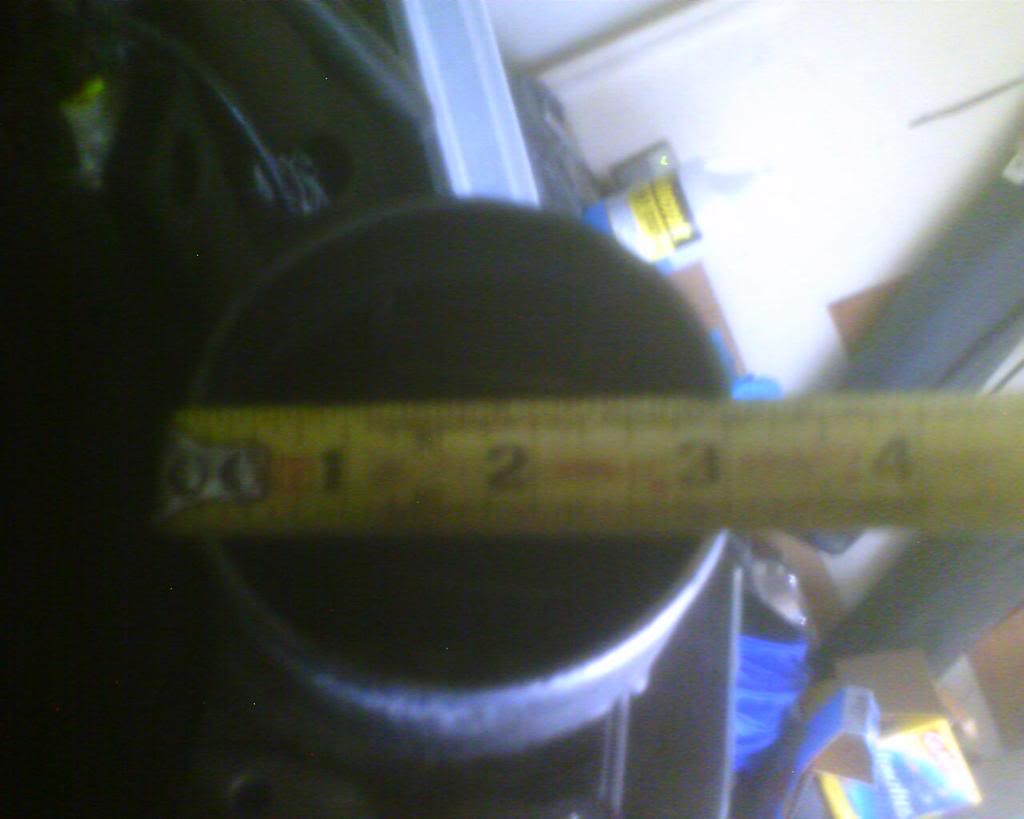

I love it when mods are backed up with real data! Yes, at WOT the stock 3VZE air intake setup is not efficient.
skipper0802 and RSR, You both have identified the exact restrictions I've replaced for those same reasons. All openings should be the at least the same size/volume of your throttle body, any less than that and you have a restriction.
Following the path of the air (with priority 1-10 and cost):
1. First is the spoiler since there's too much restriction of airflow by the headlight. RSR's drilled holes fix that. However, if you want to correct the second restriction the AFM, it won't apply since the spoiler doesn't fit anymore. Priority: 6, Cost: free.
2. The AFM. I've this photo a couple of times showing the size comparison. The AFM exit opening is SMALLER than the Throttle body, and the square intake plate is just as small. Seriously, who designed this one? Replace with a Supra/Cressida AFM to maximize airflow (see my sig). However, I'm yet to figure out how to draw in cool air (you have to either make your own air box or use the Supra/Cresside one which isn't the same as stock), I might fabricate something out of plastic/tubing if I can find an adequate location to pull cool air in from. On hot days in Cali (up to 110) you really feel the drag when the engine warms up. Idles low too. Priority: 8, Cost, $50 - $100 depending if you go DIY or use Spectre kit for air intake.
3. From there you've got the "accordion" hose and the ISR pieces. If you keep the stock AFM, 2.5" piping works. If you swap with Supra, go 3" since 2.5" will be too small. Remove all those silly chambers and just tap into the tubing with nozzles to hook up your PAIR, PCV, and A/C hoses. Priority: 4, Cost: maybe $20.
4. Then you've got the Throttle body, air chamber, intake, etc. etc. Like RSR already said, they are way too expensive to port and you're better off saving your money, it's not going to do much. I didn't do any of these, nor plan to. Priority: 3, Cost: anywhere from $500 to $2000, don't bother.
5. Then you've got headers. I didn't do this one nor plan to. Some people claim great results though! Priority: unknown (search around first), Cost: $500 DIY, $1000 for a shop.
6. The last bit is a cat-back system (meaning everything downstream of the catalytic converter). This is the single best airflow mod you can do. I went with 2.25" piping and Magnaflow muffler and I'm very satisfied. It really woke up my engine. Got 20% better MPG's and a good HP increase (no dyno though). Lots of threads about it, search it up! Priority: 10, Cost: $275 installed by a muffler shop, I've made it all back in gas savings and then some so essentially, it's FREE!

3VZE AFM - P/N 197100-2920
Inlet Dim: 1.91"h x 1.93"w
Outlet Dim: 2.585" inside diameter (2.8" outside)
Overall Height: 3.28"h
7MGE AFM - P/N 197100-3630
Inlet Dim: 2.48"h x 1.93"w
Outlet Dim: 2.9" inside diameter (3.15" outside)
Overall Height: 3.88"h
Camry: https://www.yotatech.com/forums/f116.../#post50864156

This is the AFM I have in there off a '90 Supra with a 7MGE:
It's the exact same size as the Camry one and I used the air box too since it fits the 3VZE air filter. Like other threads have said there's only two sizes, the ones we have and the larger ones in the beefier V6 engines. That Camry setup looks real sloppy, I'd be worried the intake is partially blocked and would negate any air flow gains. I'm sure the AFM works fine though.
Also, you have to open up the VAFM by cutting the silicon and adjusting the cog (once again, see link in my sig). These are not plug and play but it's not anything crazy, no wire splicing or soldering. Once you get it close, the ECU takes over and adjusts the fuel trim.
