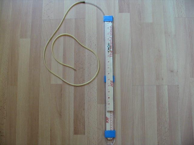

Following the information provided by the Autospeed.com articles, I've constructed what's called a "slack-tube manometer" to measure the pressure drop in my intake system. This instrument reliably and accurately measures the pressure drop in units of "inches of water." Additionally, it will give me a measure of how restrictive my intake is in comparison to atmospheric pressure. I also built in a "zero calibration" feature that allows me to align the "0" of the ruler with the left-side meniscus.
Materials needed:
The first data collection point. This location will provide the total pressure-drop in the OEM intake system (includes the drop-in K&N filter that I bought 24 years ago.) Materials: 3/16" hose barb, 3/16" cap, and a bit of silicon sealer.
I'll add at-speed, real-time driving data as I collect them. (Sorry about the table format. I'm not able to use HTML code at the moment.)
Initial measurement and instrument setup results:
Speed (mph).....Pressure Drop (inWC).....Ambient Air Temp. (°F)
idle...................................1-1/4................................73
65-70................................1-1/4~1-3/8¹...................71
WOT..................................6~7²......... ......................71
¹Level highway, 5th gear
²Highway on-ramp, 2nd gear, 0.21654 to 0.25263 PSI maximum restriction
Materials needed:
- Common wooden yardstick
- ~4' of 1/8" aquarium clear tubing
- Masking tape or clear tape
- Vacuum (or surgical tubing in my case)
- Hose/tubing union (mine was a brass fueling connector from my R/C stuff)
- bolt, washer, and wingnut

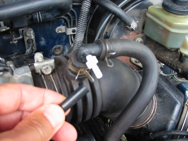

The connection hose for the manometer; routed through an uncovered port in the firewall.

The manometer. The adjustable ruler's "zero point" is positioned at the meniscus (blue arrow). Negative pressure in the intake will cause the meniscus to climb higher. In a perfect world, the meniscus would stay at zero because there would be no restriction in the intake, with the engine breathing freely.

The airbox temperature probe routed through the air box inlet (red arrow).

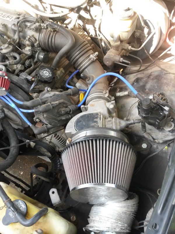

Original K&N Intake
Hmmmm look at all the goodies inside...
Contents of Package...
Unhook battery...
unfasten K&N filter clamp...
Remove the filter...
Filter Comparison...
Unhook distributor spark plug...
tuck under wires near cap so they stay out of the way...
Remove VAFM meter plug.... i gettem confused you know what I mean...
unplug and move out of way...
loosten screw on main intake elbow...
remove the one screw for the coolant reservoir and other 2 screws that held the main cover over the headlight...
what it should look like after you remove remainding...k&N mounts that your removing...
install circular piece with foam gasket onto filter box...
fasten the piece like so...
screw all holes for the piece nice and firm, but not to where it breaks lol
its a 10mm if ya was wondering...
I've got breather filters and thats why I never used this hole in my old K&N, so I guess I'll just transfer over the plug..
you may want to have lil threadtape to make sure airtight seal..
install long bracket on side in picture with one of the three nuts with washers provided....
and the smaller one on this side...
Drop the box in and line her up to roughly match...
re install coolant reservoir...
attach air flow meter to box similar to way k&n did it and you will be useing the same hardware you had before...
Now Mount those brackets we installed on box earlier, their will be factory holes already...
Plug air flow meter back in...
sometimes easier if you put retaining clip on plug before you slide it on...
install distributor cap wire back in..
refasten intake clamp...
I found you kinda have to wiggle it in theough the top in a weird way but itlls go eventually..
fasten filter clamp...
get glass and screws ready!!!
self explanatory..
FINISHED!!!!
where it draws air from directly behind headlight...
Keep in mind this is my setup for it, you may have resonator boxes still there or whatever the case is but this was mine... Now the real test comes and thats to drive!!!
Unhook battery...
self explanatory..
FINISHED!!!!
#58
oh yeah big difference from k&n to S&B... main difference thats helping is the enclosed airbox.. I noticed when my rpms were around 3500 seemed alot more power was available... I was passing people uphill with no momentum from any downhill in 5th gear... yes I'm geared for bigger tires but when I went from 35"s to 37"s I did lose some gettup I had previously but after I changed this setup out I've got it back like I had 35's again if not more... I still need to drill some holes out like you did though that should net an improvement by itself... overall I'm very pleased with the setup... I like the fact I'm getting less hot air from the engine like I was... for some reason its so much hotter under the engine area you can hear a big difference in the way the truck idles when hot... It ran fine by all means but just somethin was off in those hot days.. ready to do another test run at peak of day when its the hottest... especially here in texas it should show some difference lol
#59
I can plainly see the difference in air pickup point opening size. The OEM air box opening has about a 2"~3" diameter with a venturi shape (IIRC) while yours looks like a 2"x4" square opening. Wouldn't it be something if it were easy to move the headlight so we could duct the opening directly to the front of the grill? Better yet, a venturi--shaped inlet.
I'd really like to know the pressure drop in your new setup. Do you have any thoughts on measuring it?
#60
Nice sequence of pics and explanatory notes! I'm curious as to why S&B didn't shape the filter adapter from round into square in a venturi-style. (I'm going to presume that they measured the air flow resistance to be minuscule at that point.)
