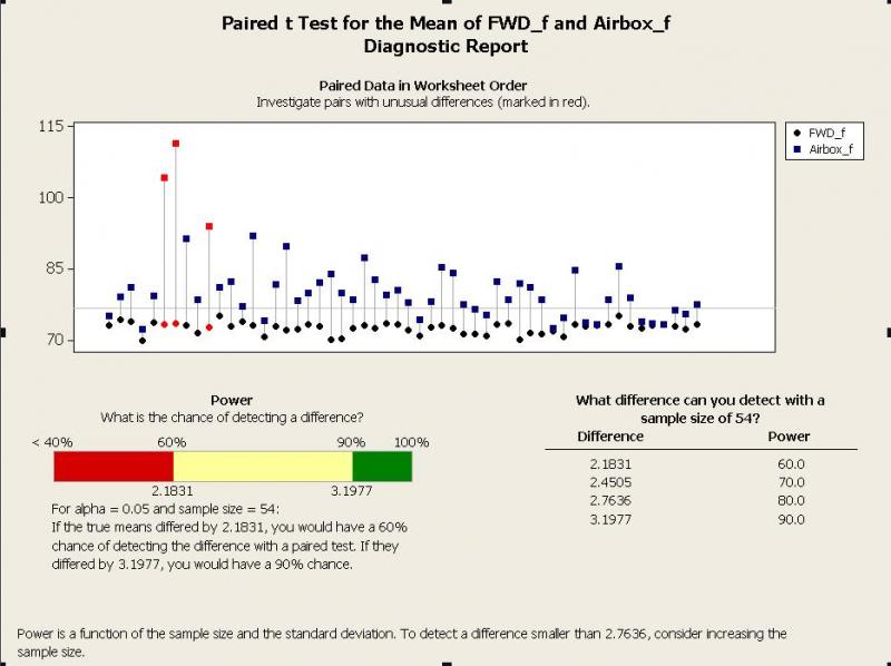

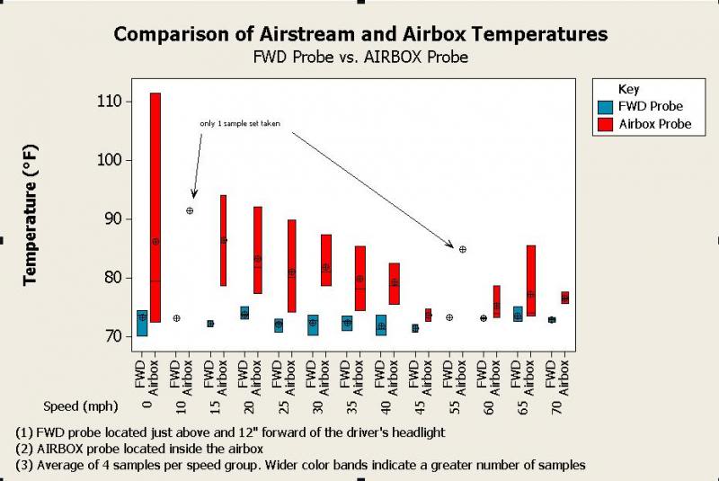

Alright,
After getting the temp. probes setup and my "data recorders" briefed we set out on our information collection adventure. We drove around for about an hour collecting data points both in-town and on the highway. There was roughly a 60/40 mix of hills to flat lands on our route. One recorder monitored pressure-drop readings, the other monitored temperature readings. Sample sets of data were desired for every five mph increments from 0 to 70 mph.
Lessons learned:
Real-world conclusions:
Now we know that a properly designed cold-air intake will make a difference to benefit beyond the OEM intake system (K&N drop-in filter included).
Next, we should investigate the cost-benefit relationship for the many cool ideas presented in this thread.

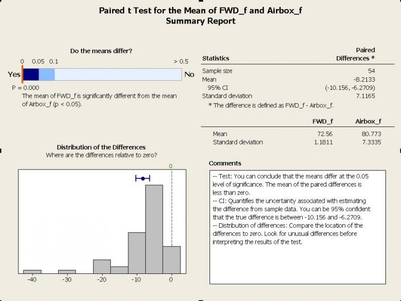

A paired-t test was calculated for the means of the FWD probe and the AIRBOX probe.
Statistical conclusions:

Alright,
Lessons learned:
- The number of sample sets depended on available terrain and traffic congestion.
- A sufficient number of samples were not obtained for certain speeds based on the flow of traffic. Additional sorties would be needed to round-out the missing data sets.
- A data recorder such as this system, would be much less demanding with a trade-off in cost. This system would also reduce possible transcription error.
- The inherent variability between the two temperature instruments was present but would not alter the conclusions of this study.
- The next study should include engine rpm also collected in real-time.
- The next study should consider the boundary airflow pattern for this vehicle when locating the external (FWD) temperature probe. An assumption is that turbulent air will adversely affect true air stream temperature.
- That having an intake fully sealed from the engine bay with an external pickup point will make a substantial difference in intake temperature.
- That ambient (external airstream) temperature generally remains constant or slowly changes throughout the day.
- That time spent at a slower speed, i.e. zero mph, will also see an increase in airbox air temperature. For example, sitting at a traffic light.
- That increasing speed will also decrease airbox temperature to a certain extent. This is most evident between 0 and 45 mph.
- That a higher speed, that is to say airflow, does not automatically mean lower airbox temperature, e.g. at highway speeds going up hills or inclines meant a greater load on the engine with a subsequent higher range of temperature in the airbox.
- That the average air stream temperature for the test was 73°F, and the average airbox temperature for the test was 81°F.
- That some data pairs are unusual compared to others, could represent special cause variation. Upon inspection, these pairs occurred while waiting at traffic signals; airbox temperatures increased dramatically
- That since sample sizes (sets) were greater than 20, normality is not an issue
- That the sample is sufficient to detect a difference between the means
Last edited by skipper0802; Aug 26, 2013 at 03:17 PM. Reason: Added prior links to project setup
#83
Someone was paying attention in stats class!
That seals the deal for me. I'm loading up on supplies and going to find a way to open up the air passageways and get COLD air in my supra air box. I looked over it again and it shouldn't be too hard, just cut out some foam, seal it and drill some holes like RSR did.

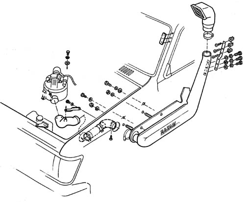

If you're looking for outside air only and avoid water, a snorkel setup is your best bet.
I suppose some sort of ram air hood scoop would work, but our engine is pretty tight to the hood over the intake plenum so might be tough to execute.
You could go like the next generation and route the air intake into the fender -- but note you'll lose any rammed air function/benefits of the factory setup at high speeds.

Interesting correlation between their temp. data and mine concerning factory air setup vs. an external CAI pod filter. About a 14 kw (~18.8 HP) difference.
Concerns:
I like the factory intake system because it's a good design considering ALL environmental factors and intended usage. I don't classify it as a CAI because it still draws engine bay air. Still, I still like to see an integration of a dedicated external air pick-up point, and a reduction in pressure restriction.
What's the bottom line? Can you really make a change to your system and claim a particular effect? Not without backing it up with proper information IMO. Let's continue with due diligence and make some good decisions, and of course, continue to have fun.
Concerns:
- Is the car driveable with the external pod? Not really. You could mount the pod on a boom, but you might get some strange looks
- What about driving in inclement weather? Better consult with the Navy about IC engines and weather--your car's about to become a submarine
- Is a 8.3% improvement noticeable on the road? That would depend on the driver's perception. Still 8.3% though.
- How would this improvement affect mpg? Unknown. We'd need a longitudinal study for that answer.
