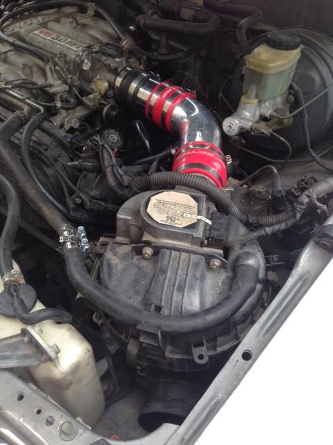

Old Aug 29, 2013 | 12:24 PM
  #241
Redeyejedi's Avatar
Joined: Mar 2007
Posts: 210
From: SoCal

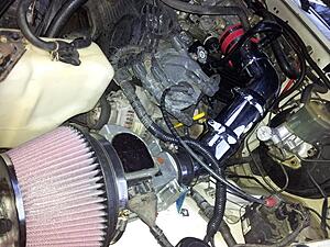

Originally Posted by clok
can some one please tell me if this isr mod will give the same results as this k&n intake kit does minus the cone k&n filter because i have this k&n intake on my 3.0 already just wondering if i would notice any differance with the 3 inch spectre kit from autozone plus my k&n cone filter ? or should i just leave it the way the k&n kit came, as you can notice this kit came with the bent plastic tube already it was kinda pricey thou....
k&n kit replaced oem air junk. then replaced k&n tubing with spctre, kept k&n filter and mount, opening clearanced to match cressida AFM

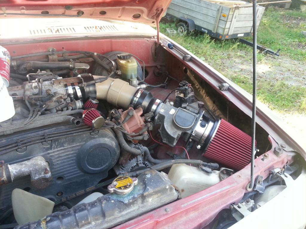

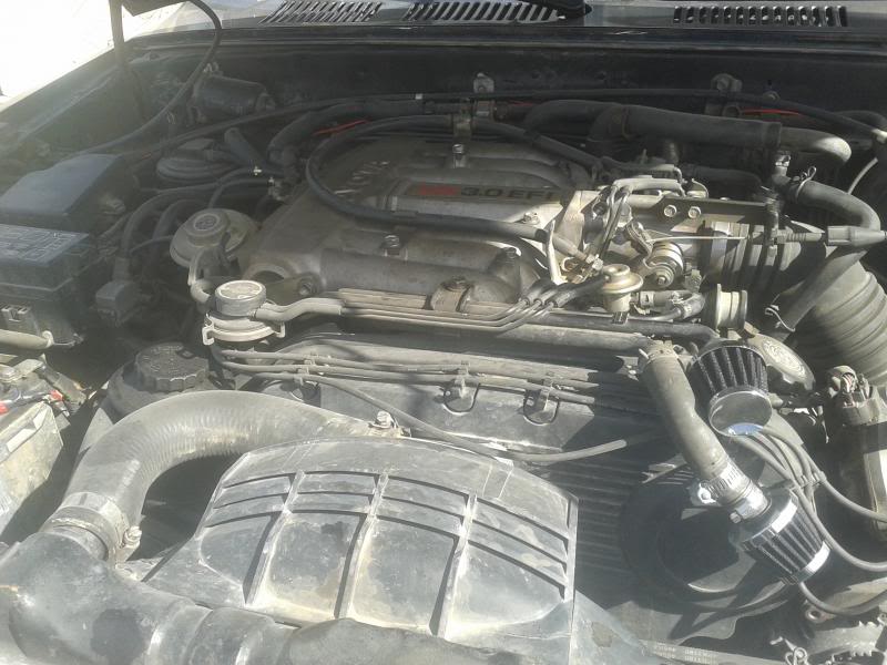

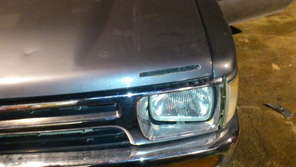

  #254
pajamawally04's Avatar
Joined: Sep 2013
Posts: 24
From: san luis rio colorado, sonora..mexico

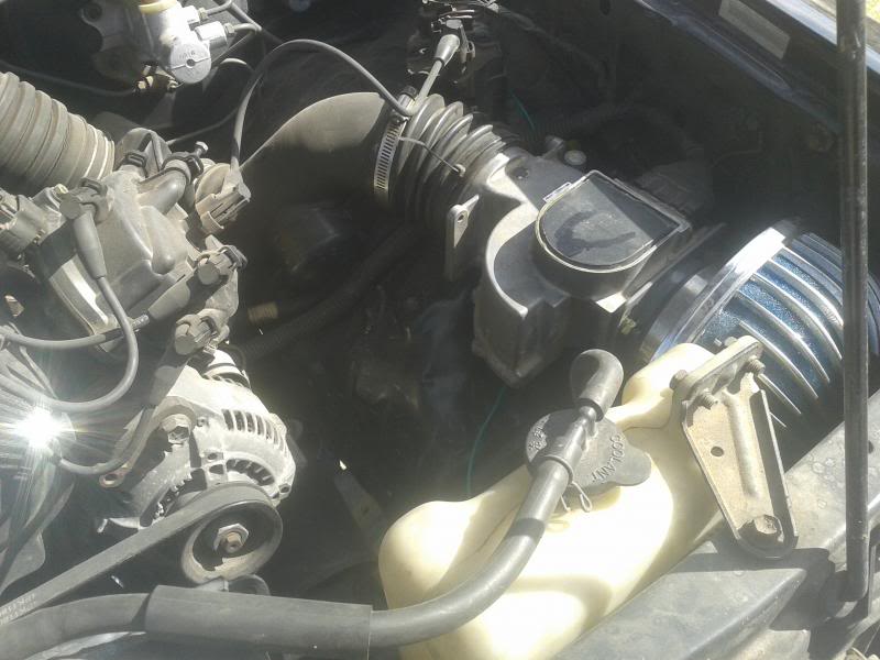

Old Dec 28, 2013 | 09:40 PM
  #255
Xeo's Avatar
Xeo
Joined: Mar 2009
Posts: 291
From: Toronto, Ont, CA

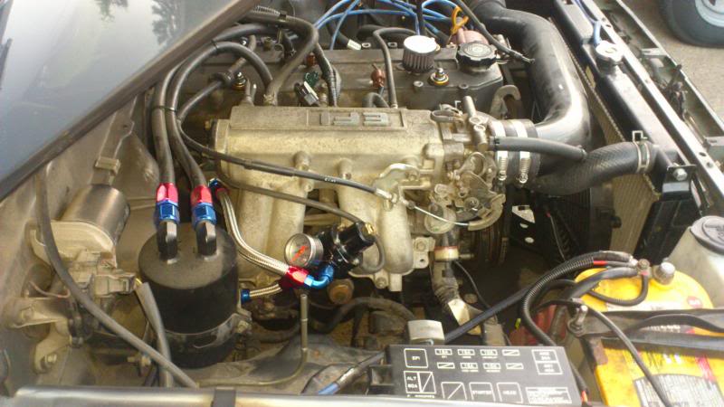

Nashman00's Avatar
Joined: Mar 2009
Posts: 136
Well this is my new 22re in my auto cross truck
what it looks like now

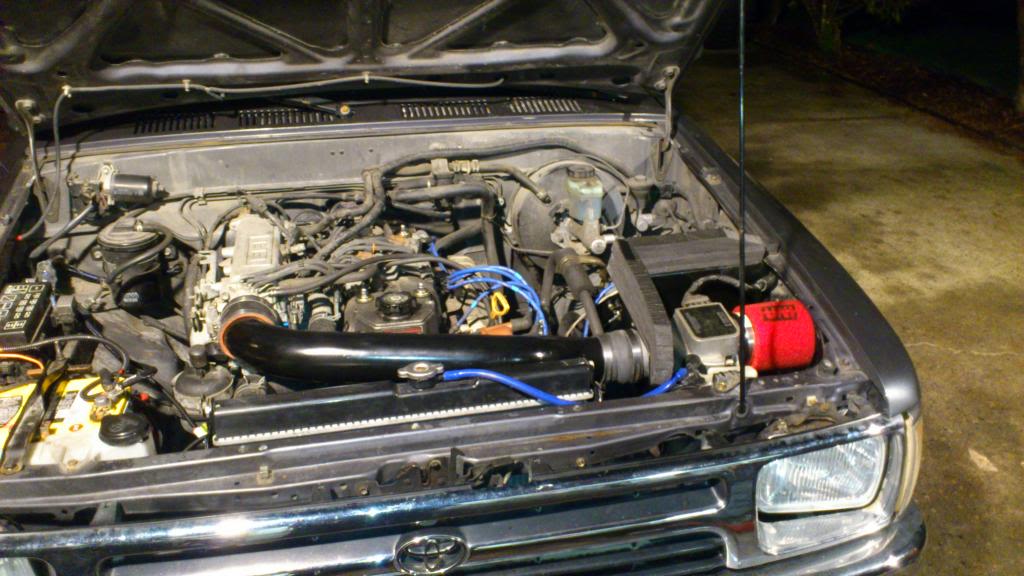

My ISR.
My ISR pretty happy with it, don't know if I should go with the open filter.
Does it add anything?
I don't really drive through rivers, and live in Texas, we do have pretty good rainstorms but that's about it.
Cost a bit more than I would have hoped but got everything at Autozone and earned my Reward.
Long bent 45 deg. piece 40.00
2.5-3" adapter
3"-3" adapter
6" straight piece.
2 ft 3/8 hose
Attachment 98839

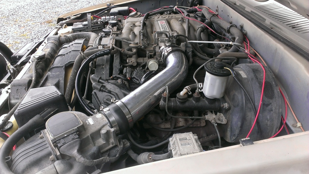

Old Jul 9, 2014 | 11:17 AM
  #258
Roark's Avatar
Joined: Jan 2011
Posts: 1,051
From: Memphis, TN
Originally Posted by iamwieb
My ISR pretty happy with it, don't know if I should go with the open filter. Does it add anything? I don't really drive through rivers, and live in Texas, we do have pretty good rainstorms but that's about it. Cost a bit more than I would have hoped but got everything at Autozone and earned my Reward.
The open filter doesn't really add anything.. It does increase the chances of hydro locking. Unless you're just that concerned about aesthetics, just leave the stock airbox.

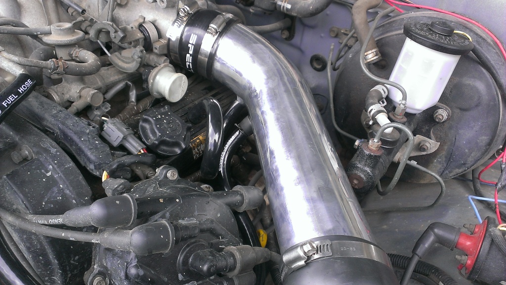

Old Jul 14, 2014 | 01:49 PM
  #259

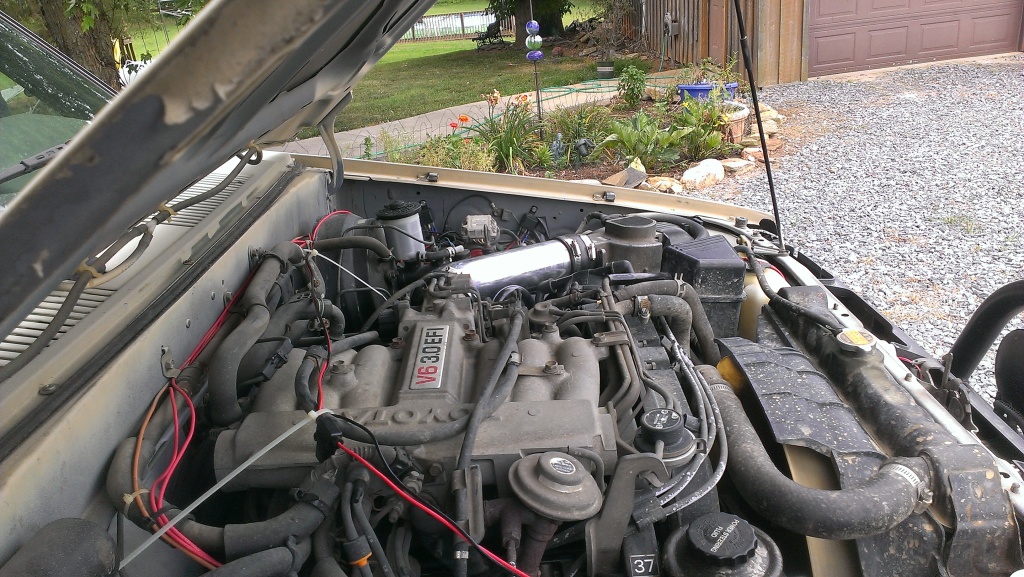

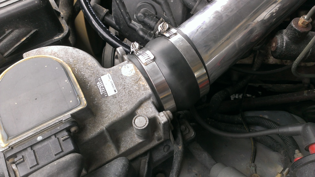

BioHazard050's Avatar
Joined: Aug 2013
Posts: 84
From: Lincoln County NC, USA

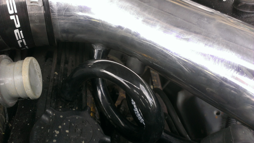

Just ISR'd my '89.
Used a Spectre kit I got from autozone for 50 bucks (hey, its an aluminum pipe), along with an extra coupler, a set of vaccuum hose attachments, and a bit of fuel hose I had laying around. Total cost is around 65.
I had to cut the pipe down by about 2 inches and the pre installed vacuum ports are a PITA , but otherwise its an almost perfect fit. Damn clean looking install to boot! (now if only the rest of my engine looked that clean.)
