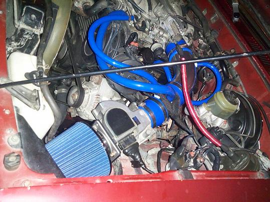

Here is what mine looked like before i needed to crawl through water and mud:
Today I came across some scrap diabond which will improve cooling and reduce heat. My plan is to constructing a surround for the filter and duct through some stock components to reduce risk of waterlock or any other contaminants while driving through mud, deep puddles. Eventually i'll come across a piece of lexan to cap the the top of the filter with a latch/hinge/gasket setup so I can open her up for easy access to the filter. Let me know what you think, and how I could improve it:
