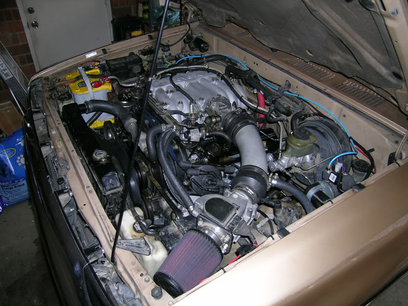

Originally Posted by aviator
Soooo... Post it already... we're all waiting on you... lol
lol, oh, sorry, here it is...
Threw it together after pulling off and cleaning my intake.
Took all of about maybe $60 in the end to put all together.
As you can see, it's the only clean shiny thing under my hood... I call it the diamond in the turd...

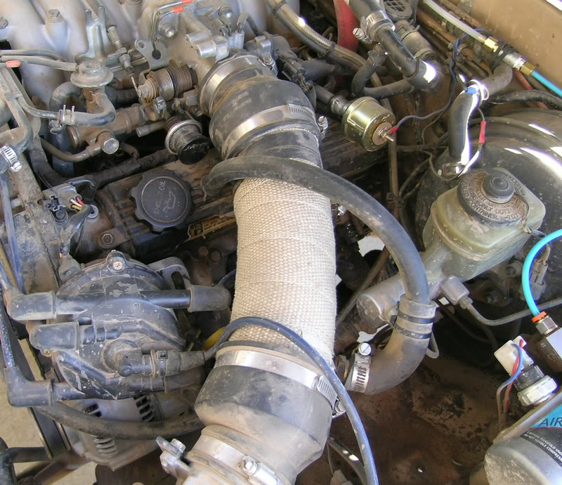

Mine was in the Home Depot plumbing section.
Electrical underground 3" sweep and two 2.5" to 3" plumbing couplers. Brass elbows with barbed ends then threaded in for any additional connections I needed. Then I wrapped it with header wrap because I had some left over.
Maybe $40...
AutoZone sold an adapter for the K&N filter.
