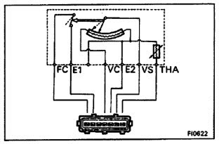

That's exactly what he's saying. However, I'm unable to verify if what he's stating is totally correct. But assuming that those particular VAFMs have the same pinout as the one for the 3VZ-E, they should work without wiring harness modifications anyway. Though he hasn't used the proper terminology to label the individual pins, nor are they all accurately labeled in regards to their true functions. Close enough so I know what he means atleast.
The 3VZ-E VAFM pinout is actually as follows:
FC = Fuel Pump Control(Fuel Pump Switch)
E1 = Engine Ground
Unused
VC = Voltage Constant/Control(Regulated 5V reference voltage from ECM)
E2 = Earth Ground(Sensor ground return to ECM)
VS = Voltage Signal(Signal voltage representing air flow to ECM)
THA = Intake Air Temperature Sensor voltage signal(IAT THermistor signal voltage representing Air temp. to ECM)
From the 93 and/or 95 FSM.
