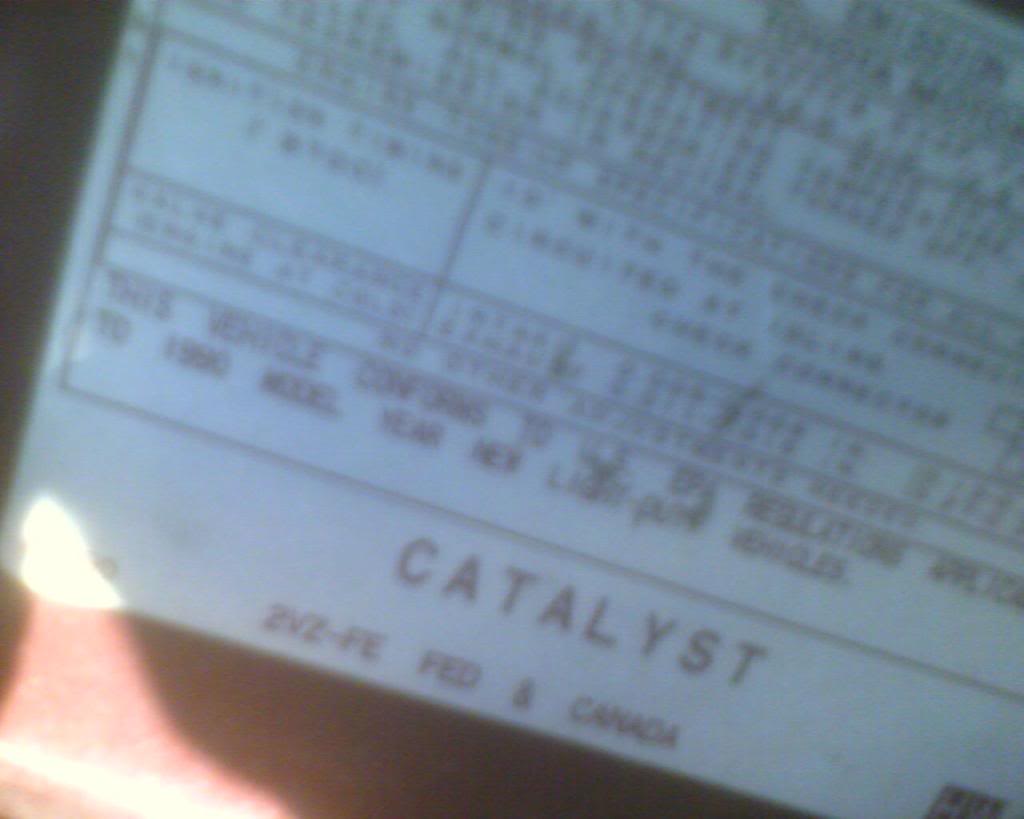

Went to the junk yard and found this beauty! Name:  IMAGE_00178.jpg

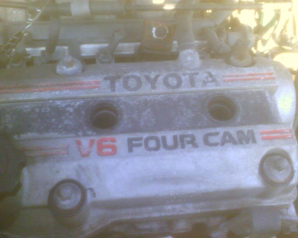

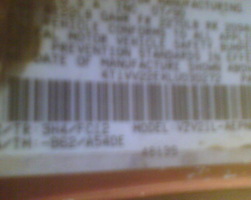

As you can see I took care to show the engine and vin for everyone wanting to use this mod! Name:  IMAGE_00173.jpg

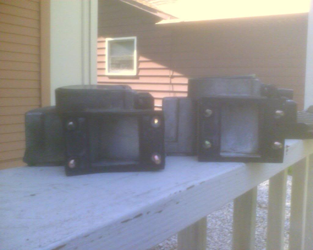

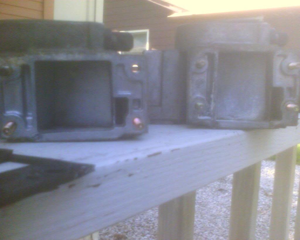

Heres the old one and the new one!

the outlet end of the afm is bigger on the new one ! so the tube is now inside the hole instead of outside this is wear the ducktape is! just to make it air tight i think i have a pic hang tight!
