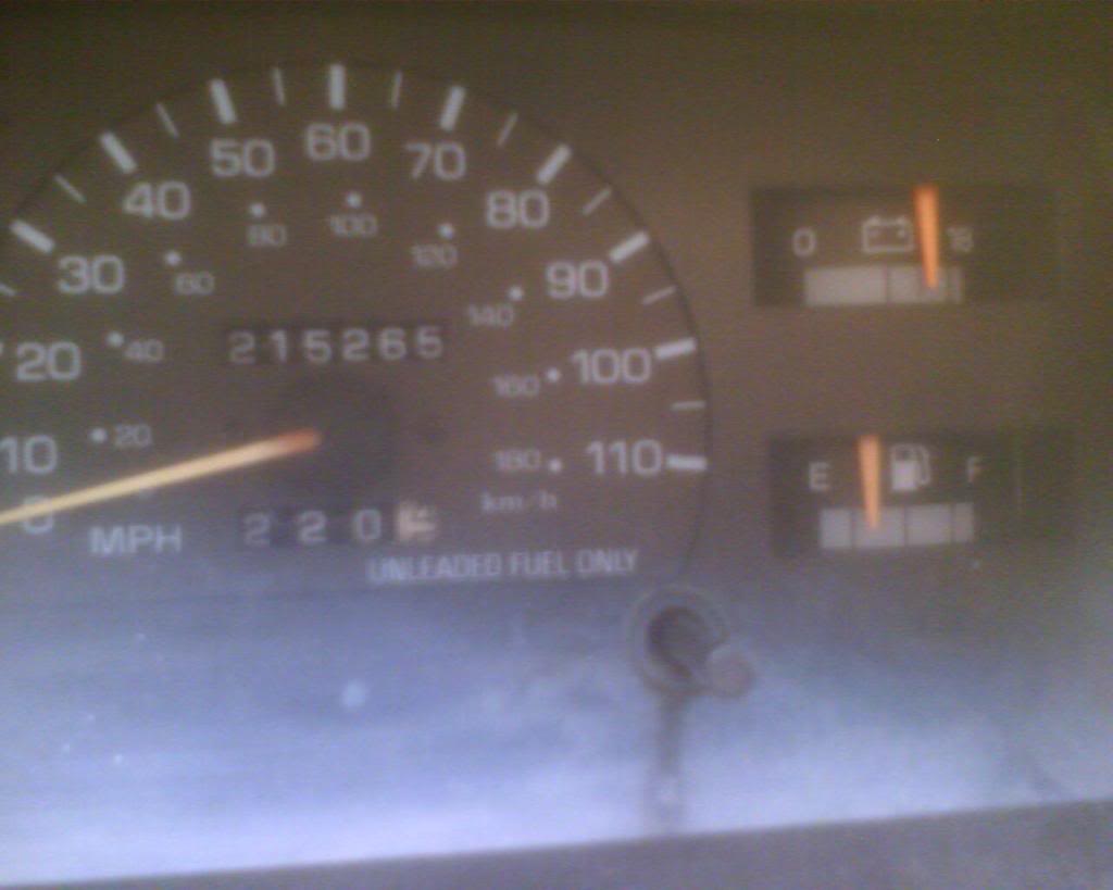

afternooon boys and girls
im back to post todays mileage and tell you that this is gonna be hard keeping my foot out of it! its not the low LOW torque thats the issue its 2nd gear and up really want to PULL
sooo much better then before!
so heres todays mileage!
now the ductape thing is just temp things fit fine! also if you wanted to pull the whole airbox off the camry donor everything would still fit fine!
the hose isnt a problem either
i would like to see better milage however i got stuck for an hour in traiffic drove a mile in 45 mins NOT good for gas
also remember im running 33s with 4.88s and an auto i should have atleast 529s to get back to stock! so some lwill get better then me !!

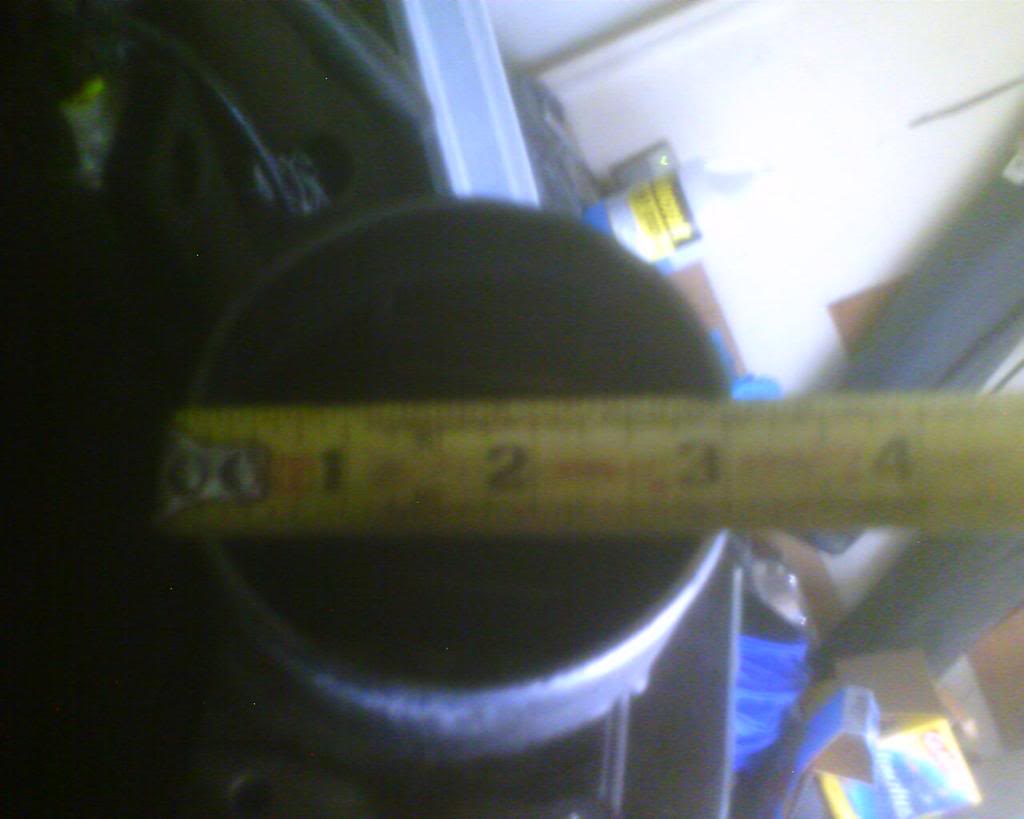

Well, if Im going to do this mod, I don't want tape holding it together. I just want to know what the OD is of the tube comming out of the VAFM. Everything else seems to be covered...

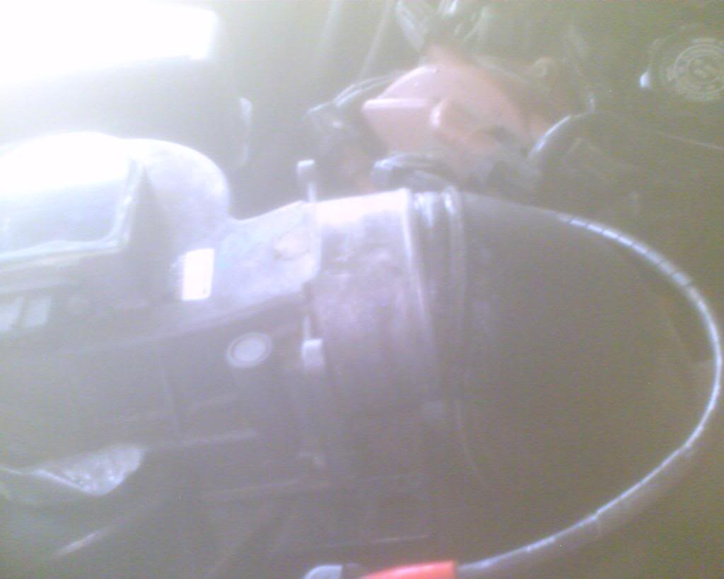

so as promised heres the pics of the hoses and were they meet the afm. the smaller one is the old one and the new one is bigger and you can see how i just stuck the hose INSIDE the new afm i wont be using duck tape to hold theis together very long i will be doing the isr mod to clean everything up !

3", thats perfect! I did my ISR mod with 3" exhaust pipe and 3" rubber hose. This should button up quite nicely.
Did you use your stock Airbox or the camry one? I just like to get all the angles figured out

stock air box is round camry is square dont get me wrong the camry air box will fit in the space the round one was in i still might do that ! n i wanted to get the other part out of the way first lol
