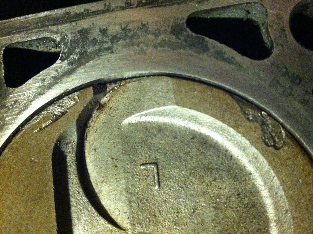

I'm in the middle of a 3vze HG job right now. My intake manifold came off pretty easy. Not sure about after market wiring harnesses? Toyota will rape you $$$ for anything you get from them. While you're at it... check the valve clearances. It's a real PITA if you need different sized shims. I'm also replacing the knock sensor wiring harness, Fuel injector o-rings, PCV valve and grommet. I also had a few chunks missing from the #6 piston. Cylinder wall looked fine. So I'm replacing #6 piston with new rings. Crossing my fingers nothing else needs needs replacing.

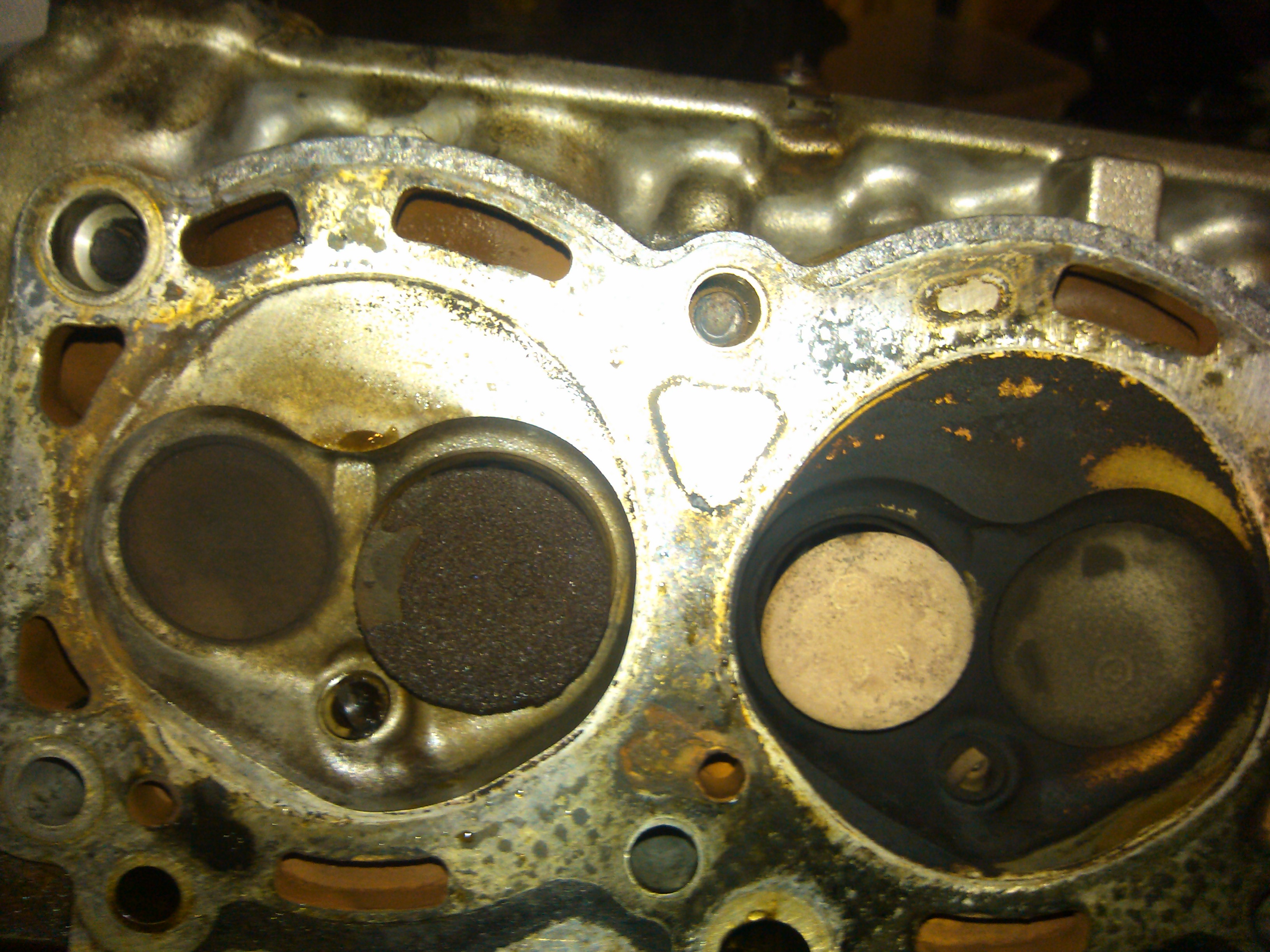

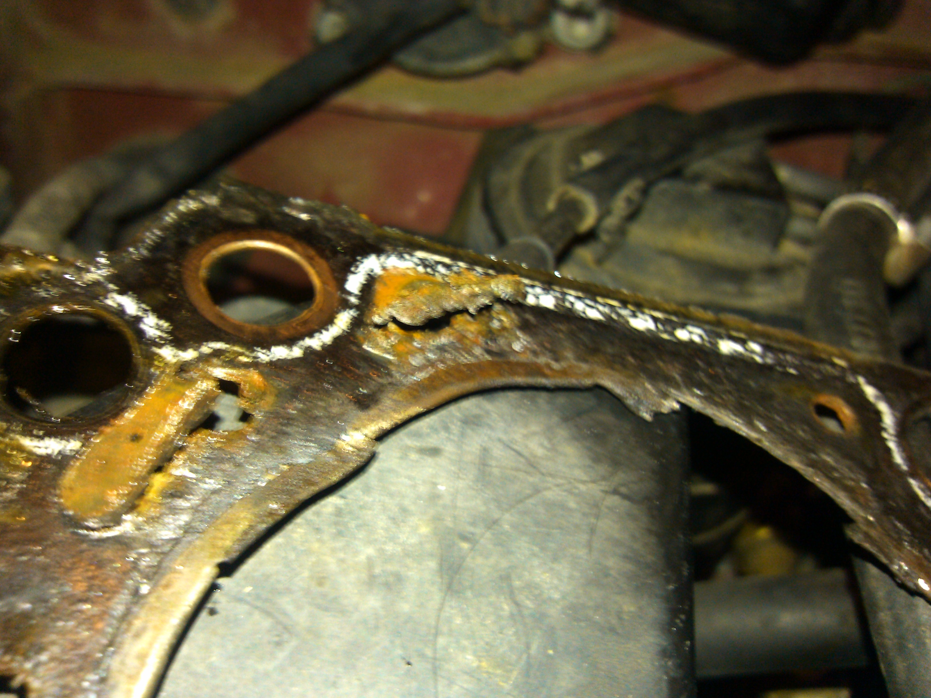

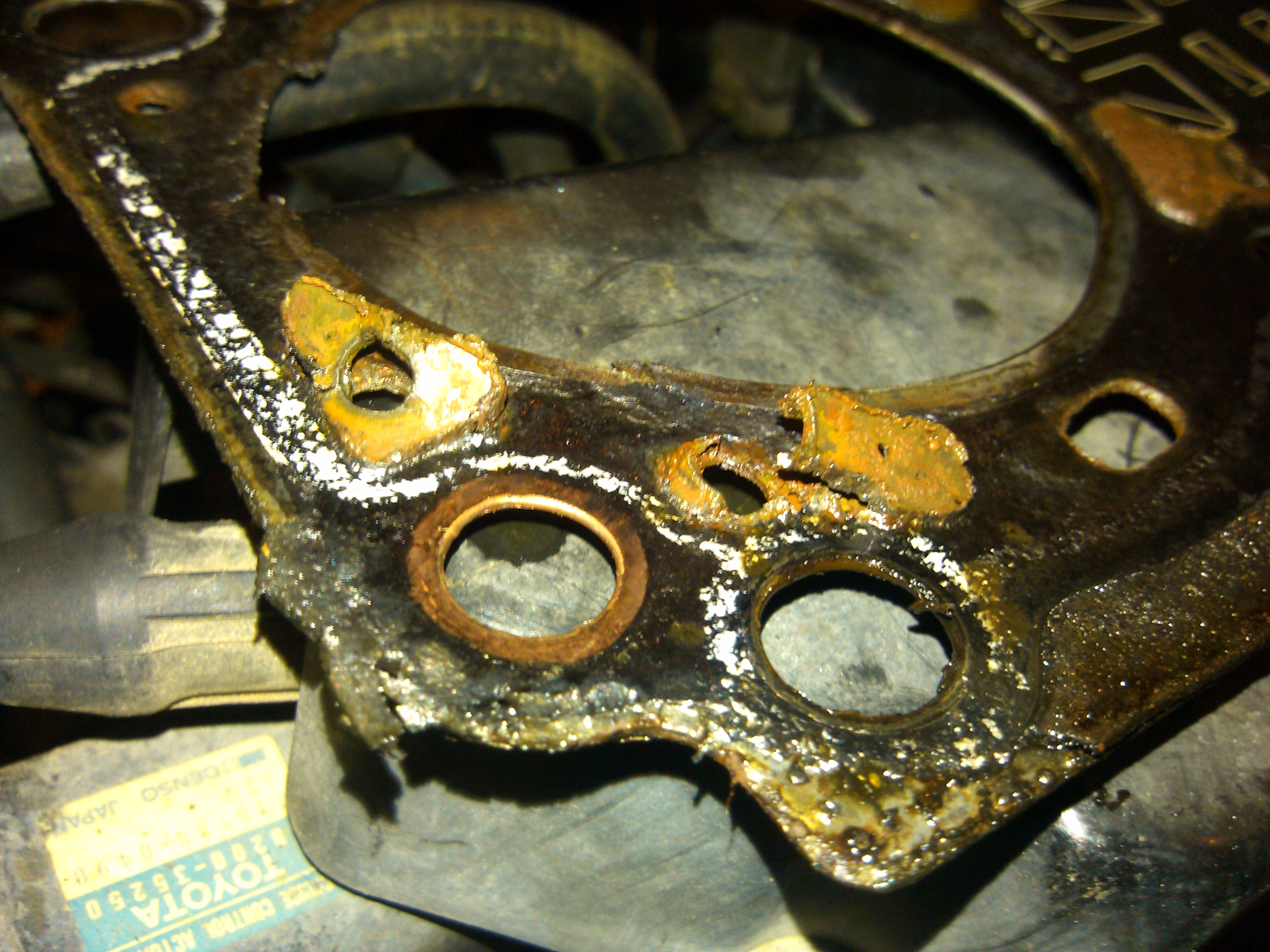

headgasket pictures
Here are pics of the head gasket. I am going to Toyota Dealership to tomorrow to order the gasket. Not sure if I will replace the bolts, I now its not a bad idea but we will see what the price on the gasket is. I also need some new exhaust bolts and I am also going to price a wiring harness although I know it will be too expensive.
