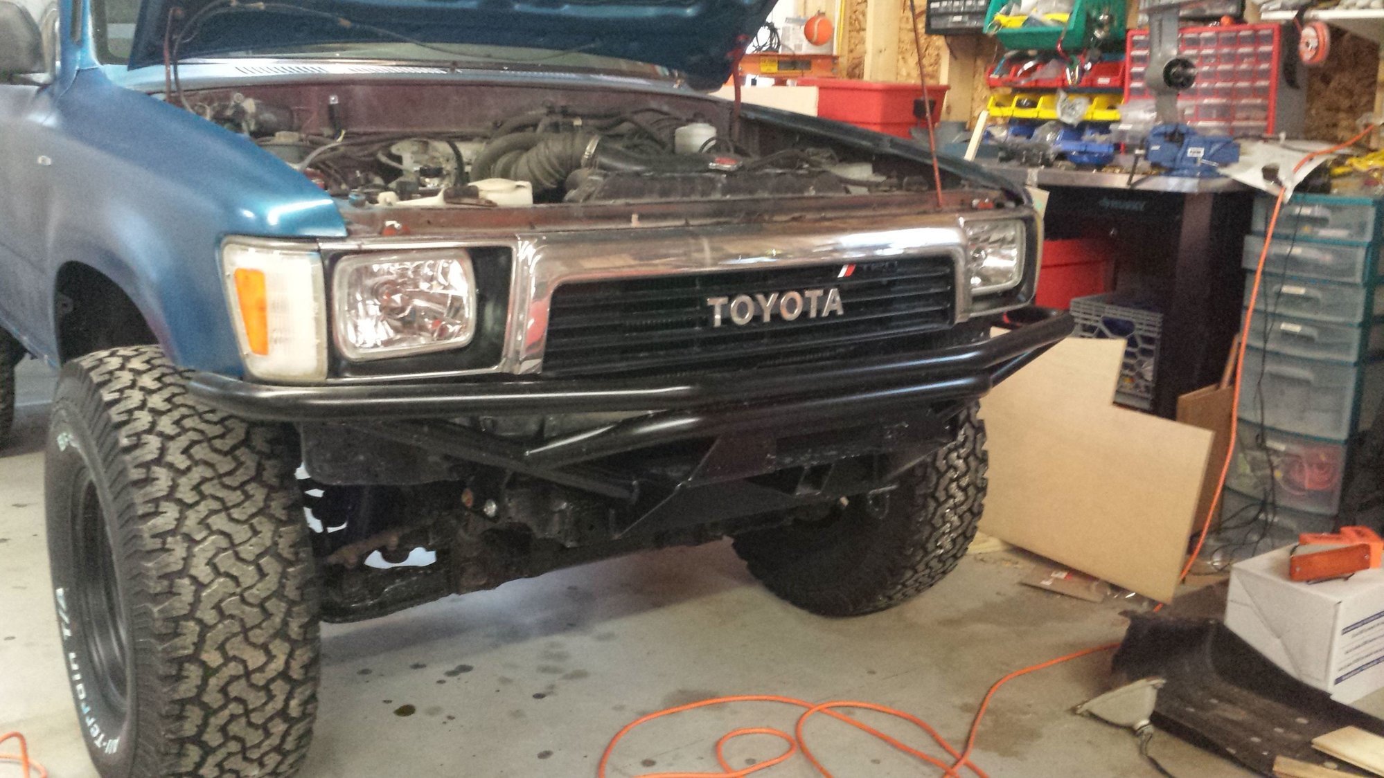

LED corner turn signals
After a long break to work on other projects I've finally gotten back to working on the 4Runner...
First up I decided to get rid of the turn signals I had zip tied onto my tube bumper. I saw a few people on here had added LEDs to their corner markers so I decided to do that.
Before...
New LEDs for the corner markers
After

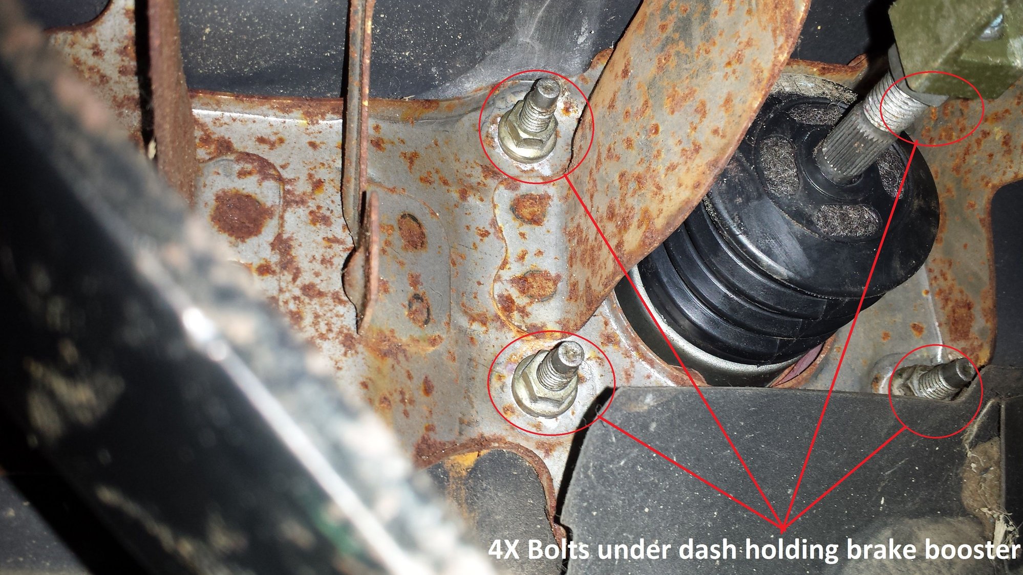

Vacuum Brake Booster
I also needed to replace the Vacuum Brake Booster. I have had the part sitting in my garage for about 4 months now and decided it was time to replace it.
I knew it was leaking because the idle would go up and down when I hold in the brake pedal (after warm up), but it would idle fine with no brakes applied.
To remove the vacuum booster you need to first remove the large vacuum line going to it in the engine bay. You also need to remove the four bolts that hold the master cylinder on. I managed to get it out of the way without removing any brake lines. Be careful moving it that you don't kink or break any brake lines.
To get it out you need to remove the four bolts in the picture which are underneath the dash
You also need to remove the brake pedal return spring, and a spring clip and pin that hold the bracket that connects the pedal to the booster rod.
Out with the old, in with the new. You need to swap over the pedal bracket (on the top of the left one) and make sure it's adjusted to the same length
Put everything back together as you found it. Don't forget the gaskets.
Done!

And a couple pictures of how the whole thing is coming along:
