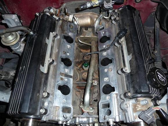

Hey bud,
Here is a shot of the knock sensor and pigtail in it's installed location. It's under the lower intake manifold and the pigtail comes out from under the intake between the #4 and #6 injectors. The connector on the sensor is green and it's in the center of the photo.
The sensor with the vacuum hoses is a vacuum switching valve for the EVAP charcoal canister. My PDF FSM calls it a TVV (thermal vacuum valve) for EVAP and shows it on page EG2-142. Shouldn't be too expensive.
The other broken sensor is the Start Injector Time Switch, which unfortunately, is pretty expensive. You can see it on page EG2-247.
Good looking engine! I wish I would have pulled mine and rebuilt it completely but it's running really well so I can't complain. Take care,
Bugs

OHHHHH YEAAAAAA i remember unplugging it now!!! i think i just didn't label the plug on the harness
thanks for the info on the sensors bud!!!!!
