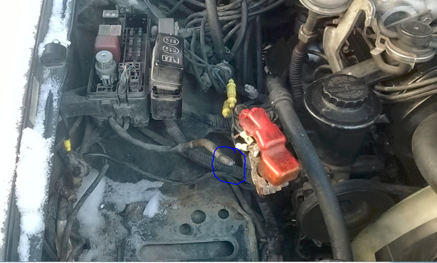

Bigger issue though w/ the cold and age of the wiring, the large gauge wire coming from the fuse box snapped, while working the battery terminals

That's not cold; that's corrosion. You can stick copper into liquid nitrogen and it will still bend pretty easily.
Examine the other nearby wires carefully. Now would be a good time to fix all the bad ones.

Here is a pic of the severed wire, thanks for the follow up as well
Yep definitely needs replacement. Depending on your truck year-model, that may not just be plain wire; it is a fusible link wire. See Philbert's thread on proper replacement.

First off thanks again to all that chipped in.
On the wire, trimmed it back added a 3/8" ring connector crimped, applied heat gun to activate solder and all is good.
Good that you were able to re-connect without having to replace the wire.
