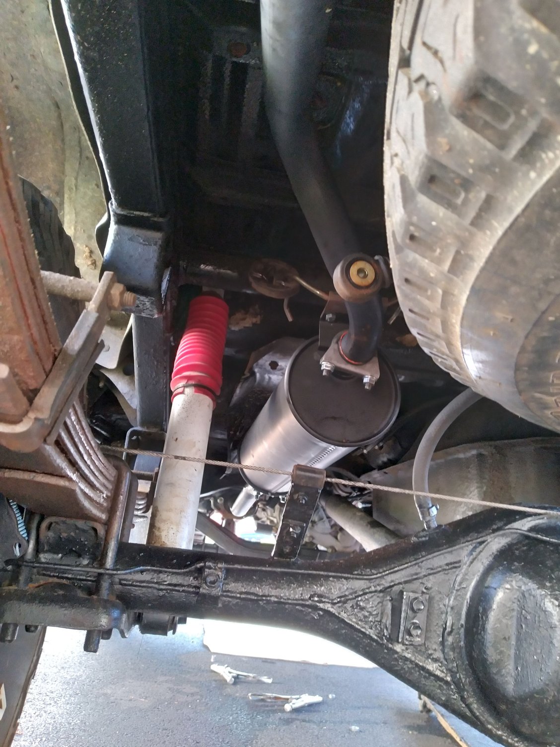

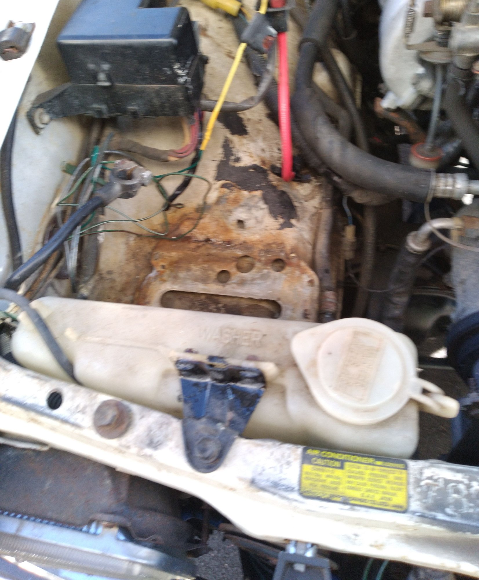

So after doing the headlight relay harness I decided to change the negative battery cable. It was just a big wire going to the fender secured with an 8mm bolt. Until I get ambitious enough to build my own cables like mentioned earlier I found a negative battery cable more like what we have in the FJ and echo. It goes to the block and fender. Plus I left the old cable from fender to block. It is in kinda tough shape but I figured I would leave it there as well.

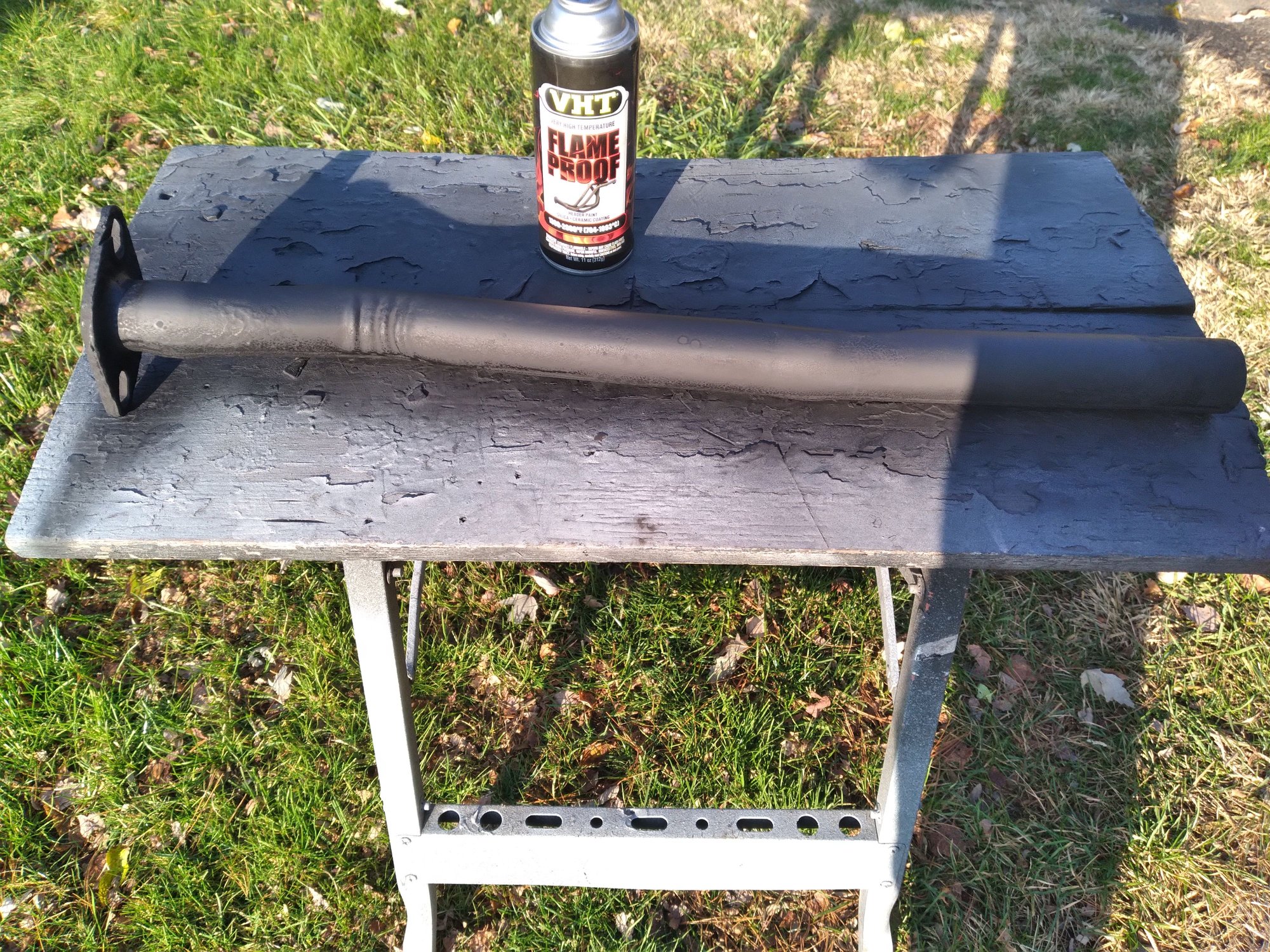

luckily the weather is beautiful today so I painted the last remaining section of original exhaust pipe between the cat and muffler. I'm in the process of replacing the muffler again as well. The last one leaked right from day one.

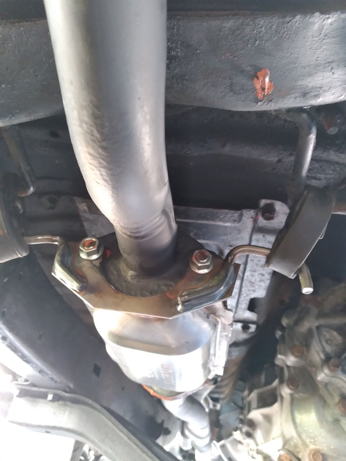

Another job done before breakfast. One of the reasons I wanted to replace the muffler was because the pipe going into it was moving and seemed loose. I think partly because the bracket was missing for the catalytic hangers. The truck came to us without that bracket. I made something but found one better and modified it to fit. I think it's for a Toyota Camry. Of course pulling that Pipe out of the muffler that made it really tight and had to fight to get it apart though. I really thought I was going to have to do some welding on that old pipe. turns out it's really solid and I thought it was rusting . That's why I thought it was moving so much inside the muffler.
