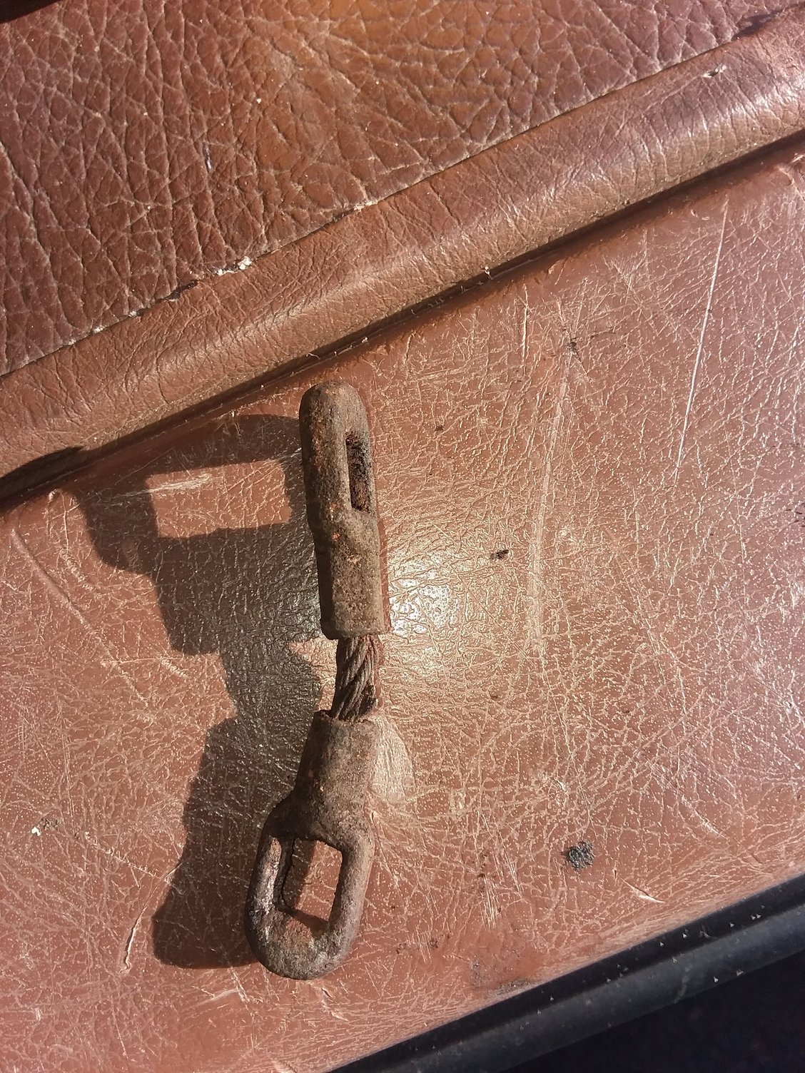

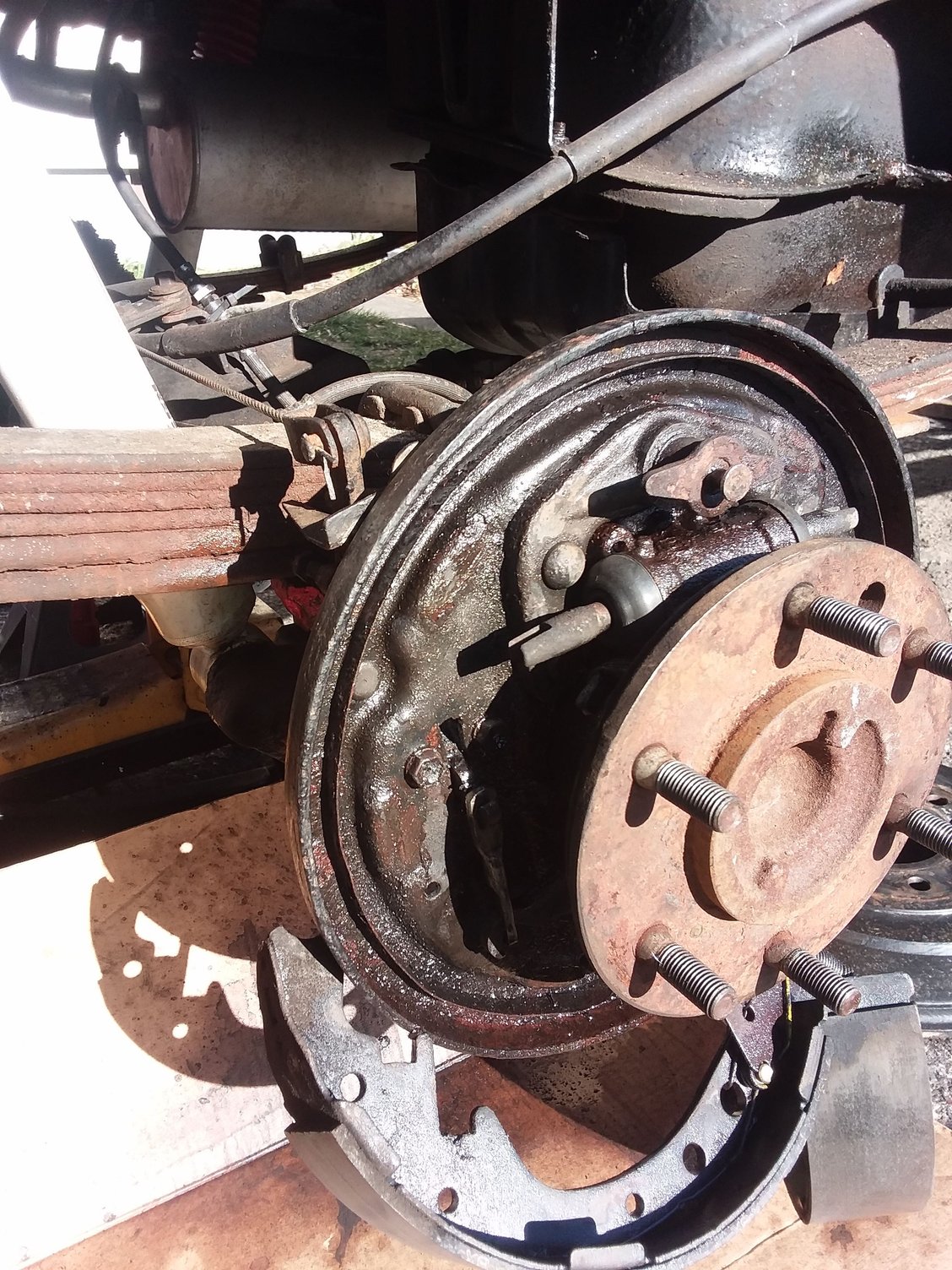

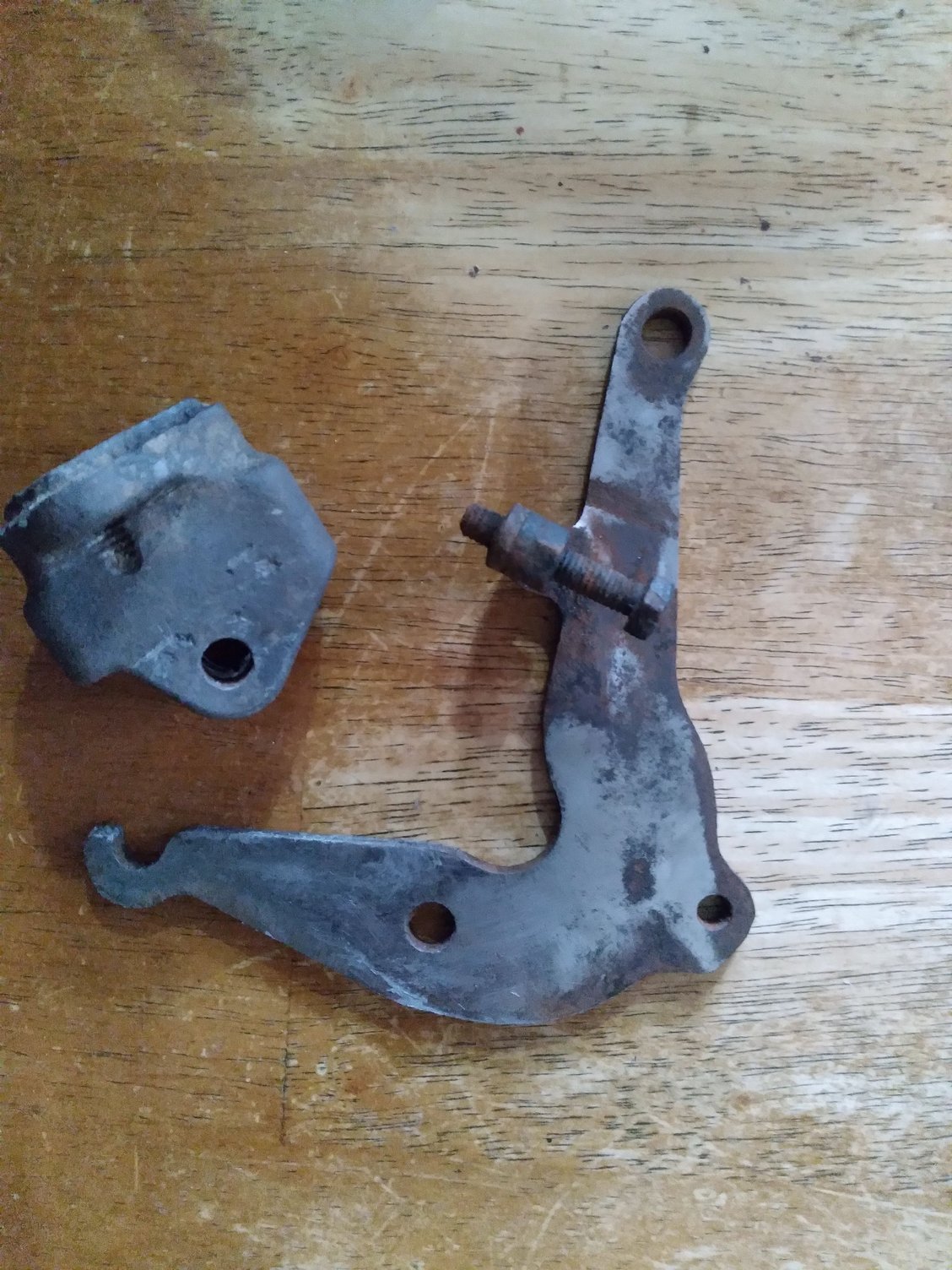

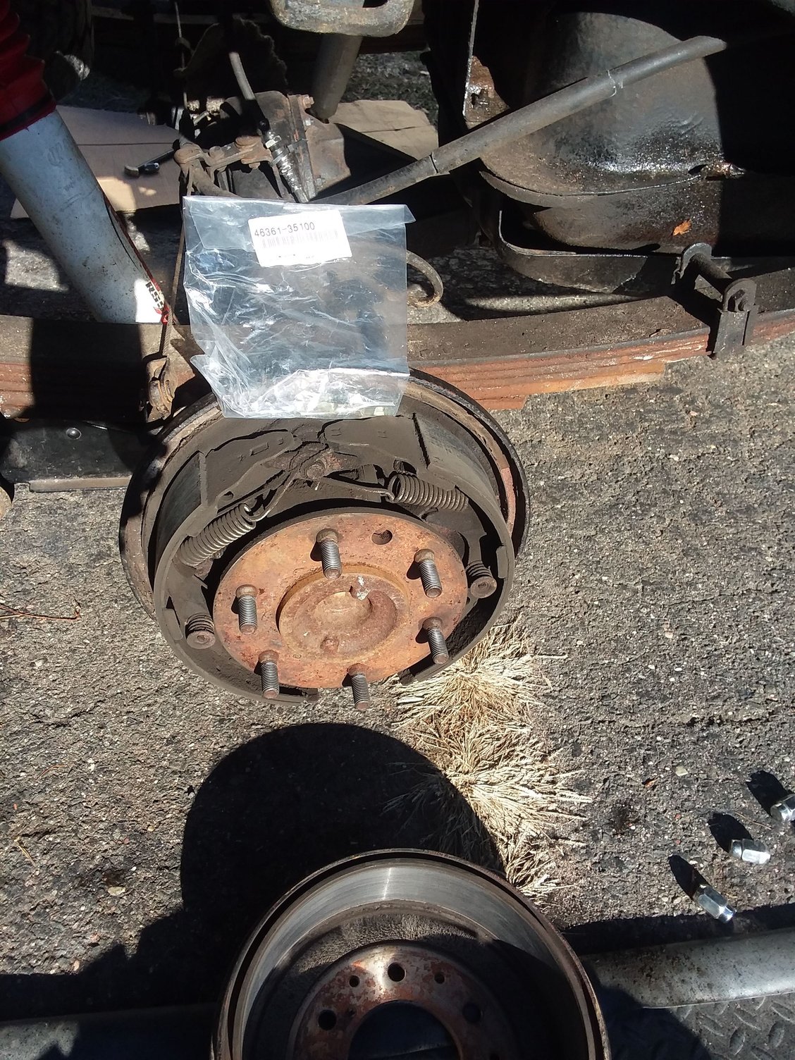

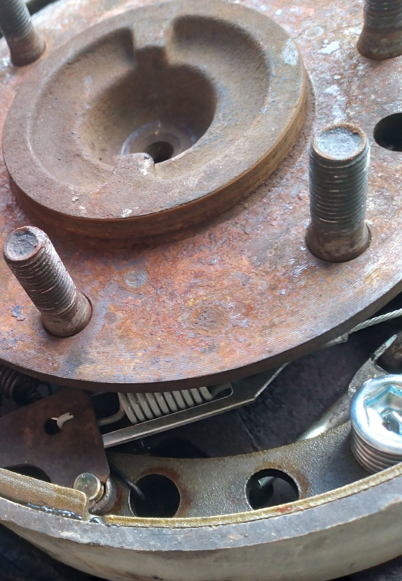

Anyway new brake shoes and hardware plus new inner e brake cables are installed. I didn't want to put it off anymore so I was out there in the rain and all. I really thought it was going to stop.
It turns out that it was only the driver side bell crank that was getting stuck. It was really corroded. All cleaned and I greased it up with some marine grease.

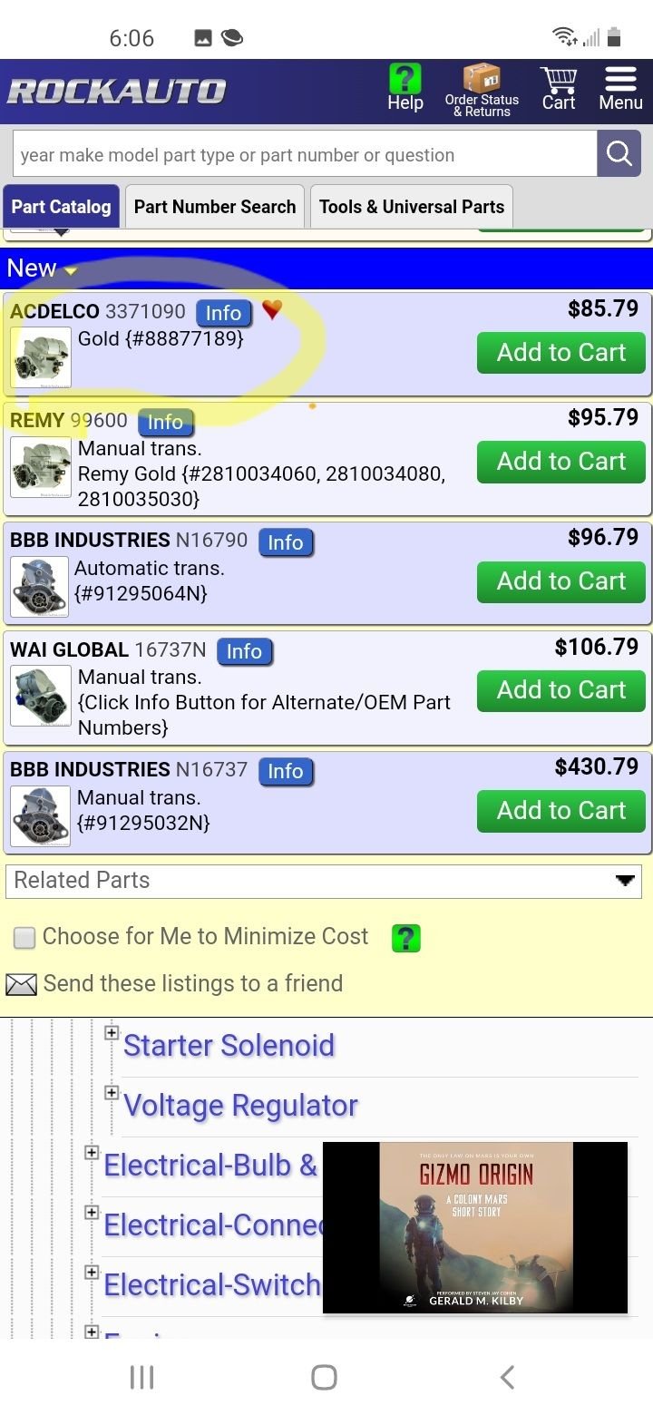

Also I went with an AC Delco starter this time. New starter is in and no grinding.

In the "before" pictures of the rear brake area, it looks "moist". Like there was differential lube, or brake fluid, leaking into the drum. If it's diff lube, you may have a bad axle seal, possibly caused by a clogged differential breather.
If it's brake fluid, it might be the cylinder leaking. Easy to check, just push the brake pedal, and see if you get any leakage.
Either way, the after picture look much drier I would check again come spring, at the latest, to see is the fluid intrusion happens again. If so, you will definitely want to solve it. The shoes don't work well at all when contaminated. Recently, I had to have my rear axle seals, and brake shoes, replaced, due to, yes, clogged differential breather. Went ahead and replace the slave cylinders that actuate the rear brakes as well. Won't hurt. I was amazed at the sudden improvement in stopping power. I almost threw my lovely wife through the windshield first time I stopped! Thank goodness for seatbelts. I won't start the engine without seatbelts on everyone.
Just be careful about the leak you had, in any event.

Both before and after shots everything is wet. I sprayed it down with a degreaser to hopefully eliminate any dust. Kinda why I did like doing this job in the rain today. Thanks to them yearly asbestos awareness meetings I have to go to for work. It seems every time I'm about to fall asleep at the meetings they bring up another product manufactured with...... no surprise in brakes though.

back to the starter turns out AC Delco made in China for Michigan and a Chevy product works. The remanufactured and Mexico starter didn't work. It said in the paperwork it may look different but doesn't work but it really is different. Stay away.
I was really hoping to get a rebuilt starter from a place called Maniac Motors. That's the one we went with for the Echo and it has lasted longer than the original now. I placed the order they refunded my money so I'm guessing they didn't have it. But they do have parts to rebuild the old one.

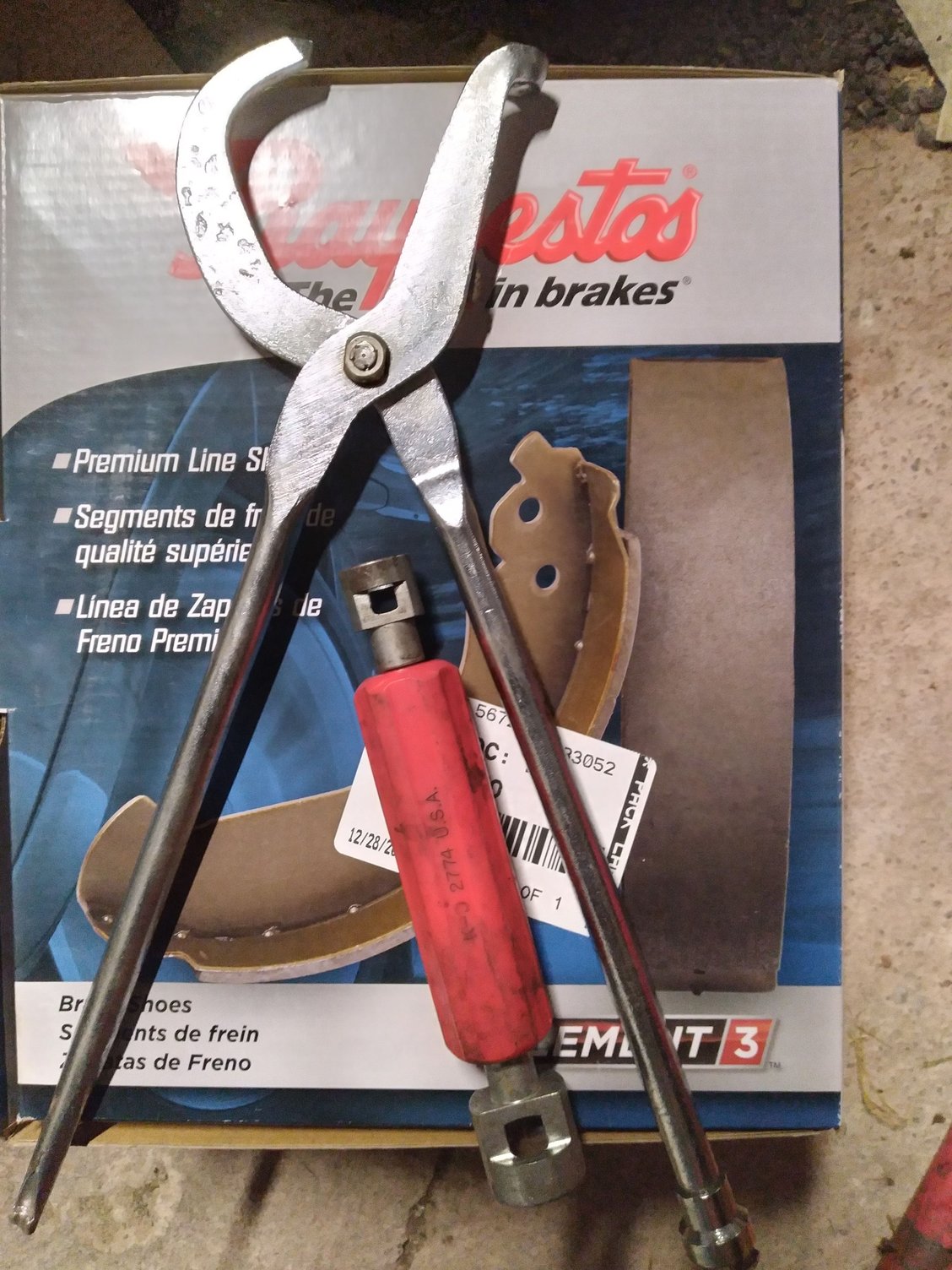

These are my allies with all them springs in the drums. I have 16 drums to maintain. The rear disk with drums inside on the FJ are just about THE biggest challenge!
I had to look up the video on how the hook part works on the pliers. It's been too long since I used that part. I don't think it could be used on the lower springs of the 4runner.

Yep, I have a set of those pliers. They make it LOOK easy, but they've done a few (million) brake jobs more than I have. I replace the shoes and springs on my 87 4Runner, 20-some years ago. I don't think I had the pliers then. I got them after to do the next brake job I still haven't done
I used a pair of needlenose pliers. Probably why I have such terrible memories of the job. They worked...eventually.

ROC starter wasn't my first choice but since Maniac motors was a no go that's what I came up with for a fast option. it shows on the Maniac motors website that they have rebuild parts for the old Toyota starter so I was planning taking care of the old one myself. I did consider taking the cheap starter apart for that idea but it's just too different. the description in the paper work that came with it stated that "it may look different but works". ha! I've heard that before. On the up side I can change the starter in 10 minutes now😆
