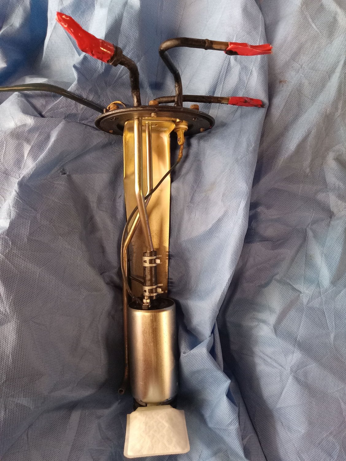

Fuel pump swapped and bracket cleaned up.
another good video that helps, of course it's an Alex Man vid😅
https://youtu.be/MPfZyWt1QFo

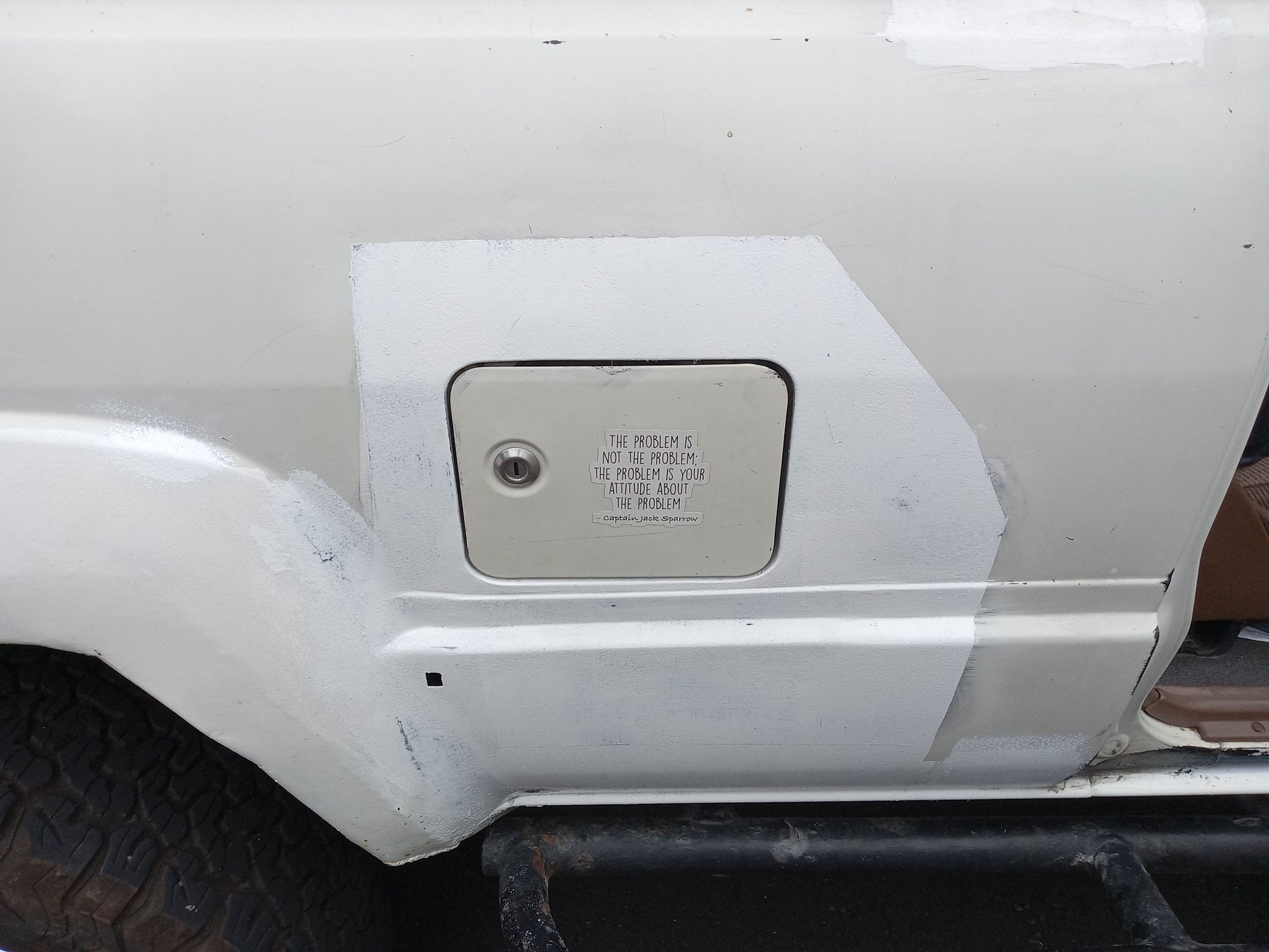

The fuel tank went in without issues and I hooked up all fuel lines. First trip was to the gas station where I watched intently when filling up 😄
I still have a lot of sanding to go but for now I covered it with some rust preventative for now.

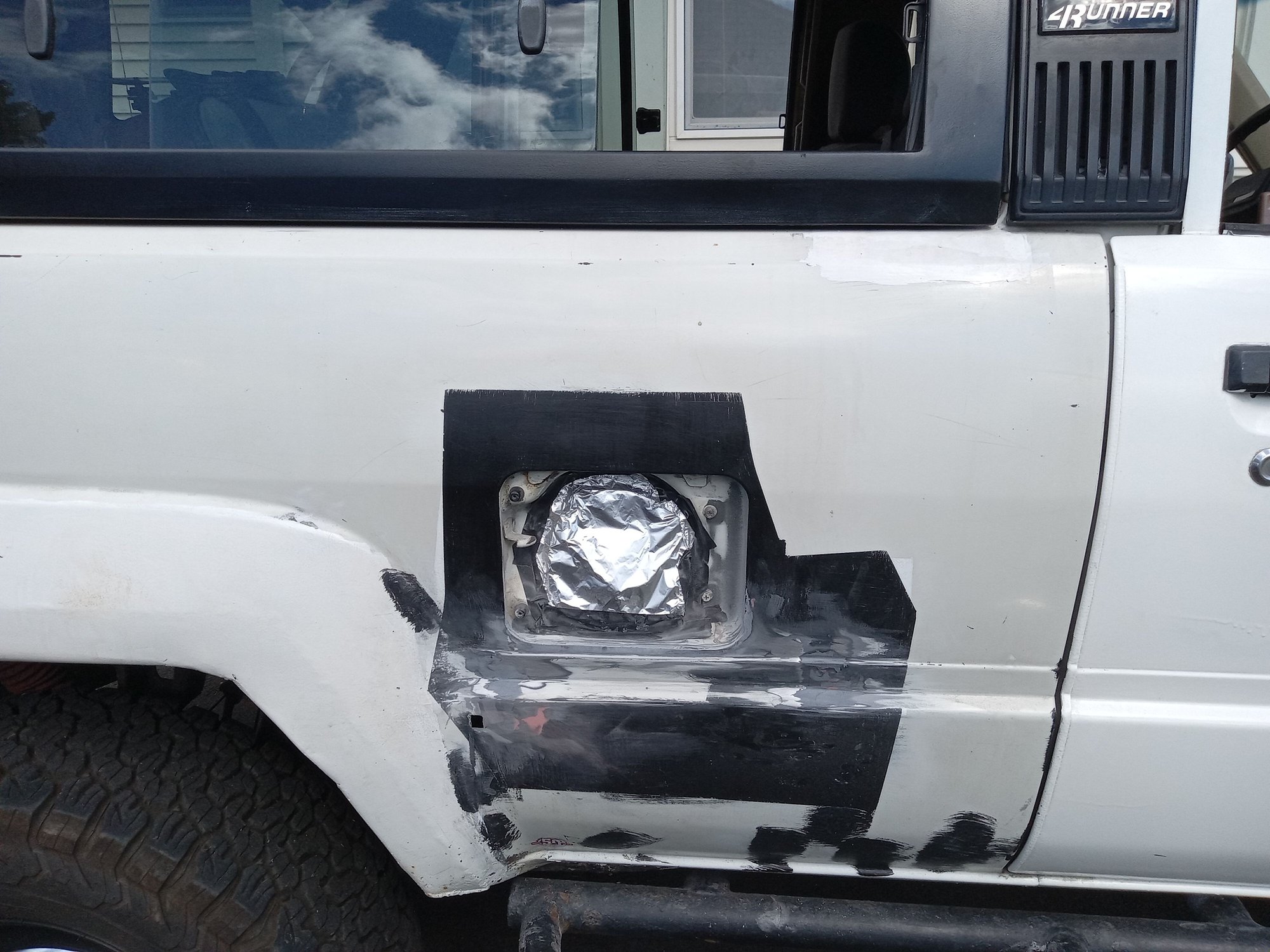

Nice work. I was going to ask if you cut that patch from a door, and then I saw yes, yes you did. LOL. I wonder why so many rust in that area?
Old Sep 18, 2022 | 03:47 PM
  #810
Damion812's Avatar
5 Year Member
Joined: Dec 2018
Posts: 1,080
Likes: 646

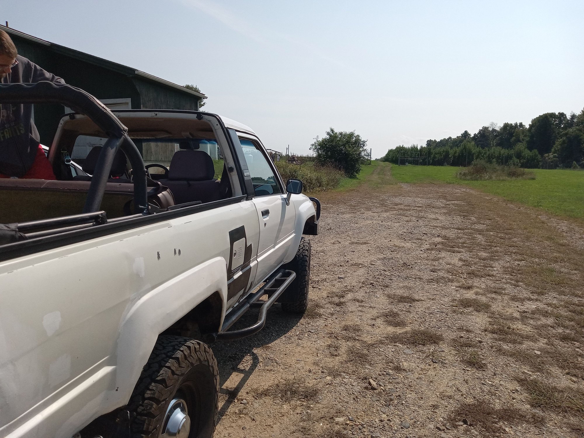

Salt brine, that's what's killing my favorite vehicles here! I've got to really start addressing my 08 FJ Cruiser soon. Today I had to fight the good fight to get one of the skid plate bolts out that snapped off. It Isn't even original and I've added antisize before! No use using SS bolts either. They are just too soft and rust just as fast here.
The door s a great piece for the repair! Once in a while I get a good idea then there are the other crazy ideas I come up with. Ha ha. Like 4 wheeling to the apple farm again today.
who would have thought we would see an even older yota pickup on the road today! besides the FJ 40 we passed at a local automotive shop.

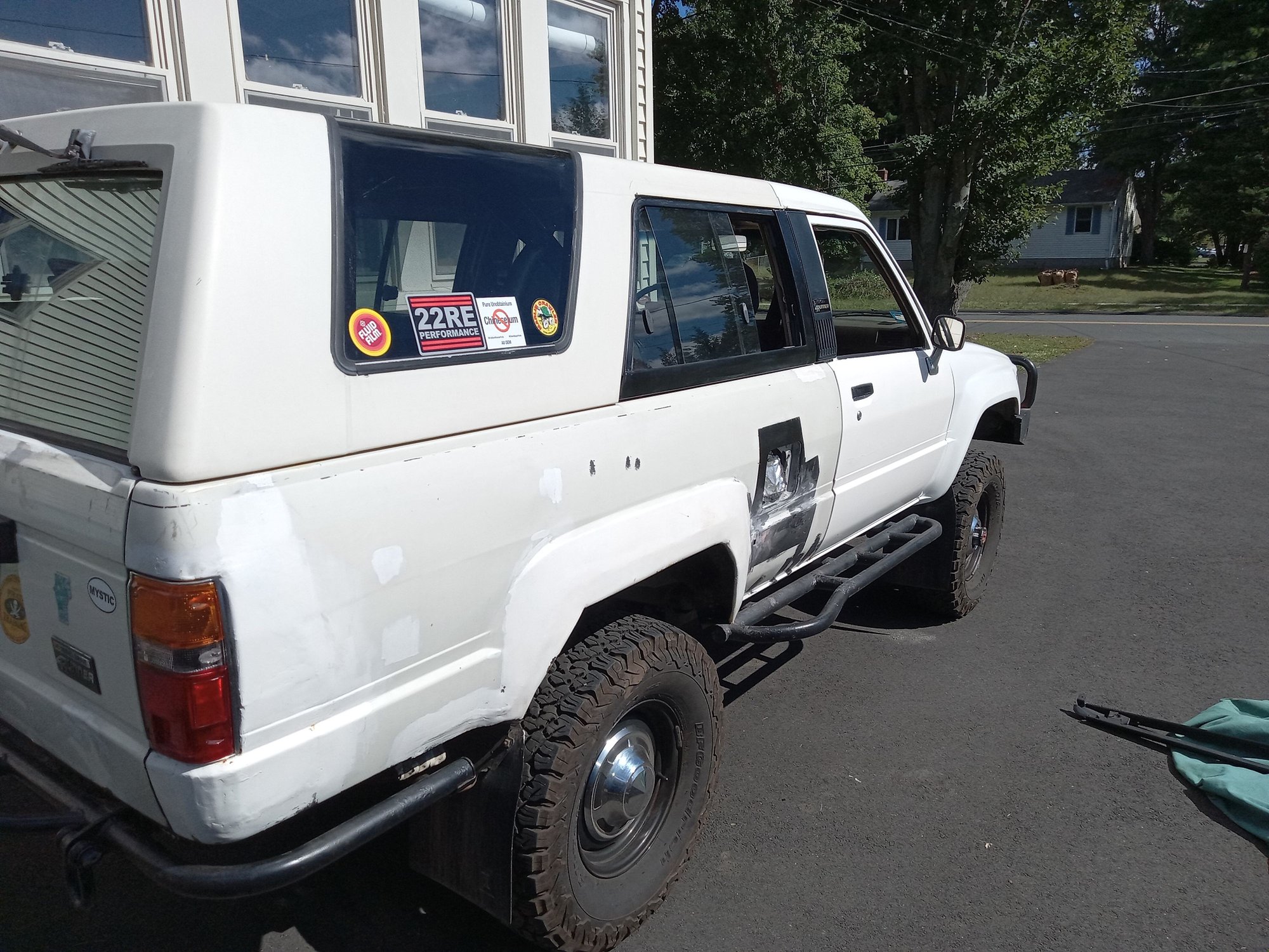

So this is where it's at so far , a little more sanding and filler and it will be done.
and the hard top is back on.
don't you just hate when someone is standing around doing nothing? This just happened to be a byproduct of the modification I did to the top.

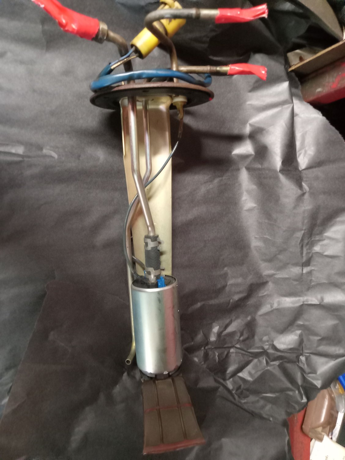

Just did mine as well, with aid from our very own Alexman.
Found the prefilter sock screeen torn.
Also found old pump resistance very low @4.5 ohms, while new pump's was at @49 ohms - went down to 23.3 ohns once installed and submerged in fuel.
Somehow, the Denso replacement kit only came with one hose clamp. Old clamp is too loose so I backed up with worm-gear hose clamp.
that's awesome, great videos by him! That stinks about the clamp missing and the sock tore though. The fuel pump and sock looked fairly clean when I pulled it out. I was so nervous that main fuel line would break off and then it would be dead in the driveway. I then would need to figure out how to get it in the garage to get the top back on it or get a couple neighbors to help lift the top. Good times!
