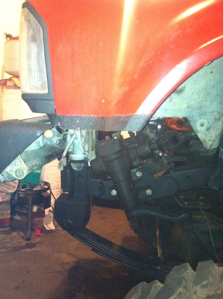

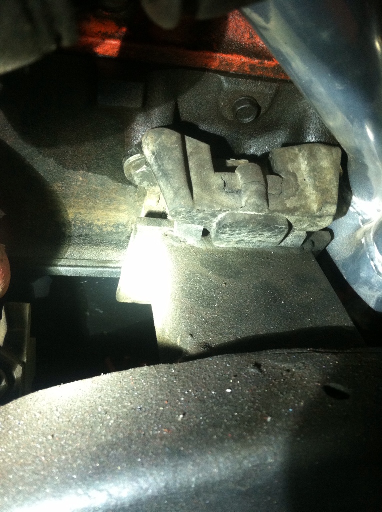

The steering box is on the outside of the frame. Should be easy to get to know matter what engine you have. Here's mine and I have a v8.

well my plans of having it running this weekend came to a screeching halt i have to wait til tuesday to get a new pilot bearing. the one that was in it was seized up good thing i checked it. another question travis on your motor mounts the stock 22r mounts have the mounting plate that sticks out off the frame did you have to cut them off or did you mount your mounts on them? I figured i have to cut them

I cut them off and built new mounts.

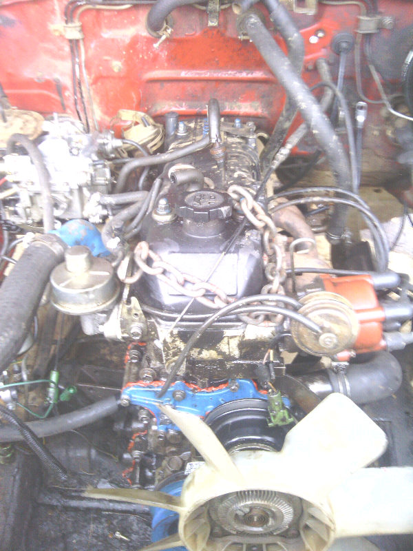

Last day with the 22r in it

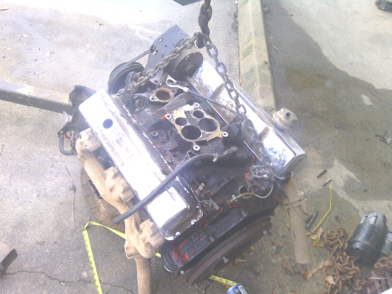

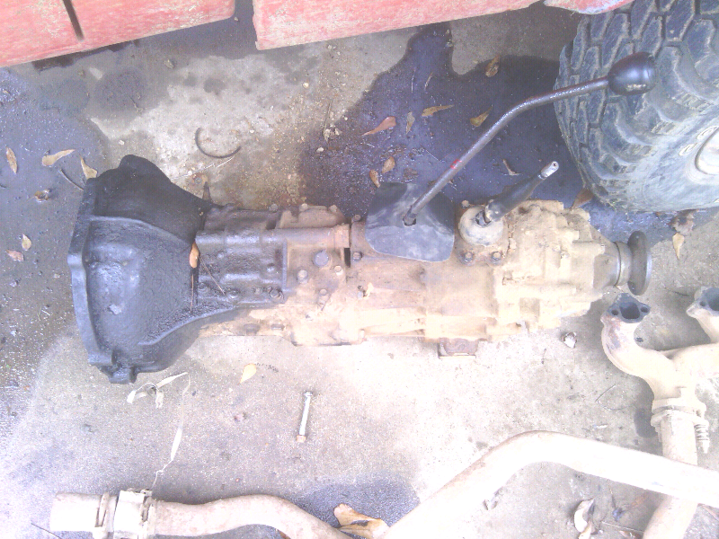

What came out of it

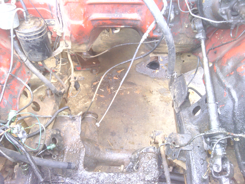

One empty truck

Here are mine I have in my truck they are the old chevy style mount with a single bolt comes up from the bottom to the center of the mount

Here are my brothers mounts that are a solid mount off the engine with a rubber bushing at the frame

That helps a lot i was having problems getting motor in to see where mounts go now i see what's going on
