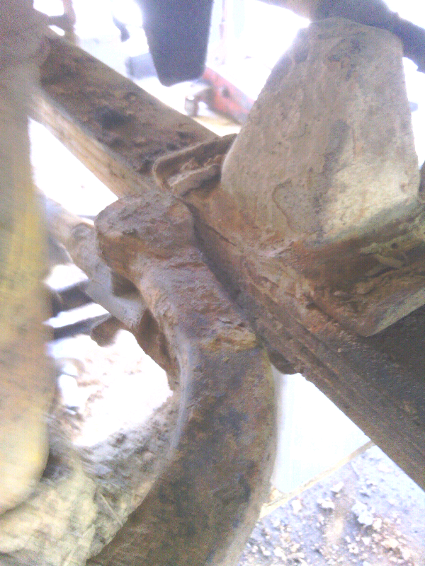

Ok i got lift blocks on my truck to clear the oil pan better i didn't like how close it was to the front diff. Now the steerin is stuck on leaf springs do i need high steer

Should use shackles instead, cost you less than hi steer and a lot less work too.

Remove lift blocks, add longer shackles. Will keep the extra lift you wanted without dropping the axle relative to the leaf springs which is causing your current steering issue.

Of course the amount of lift you can get that way is limited, but its cheap and easy.

This is what I'm facing

Check online vendors, pretty sure you can get shackles in just about every length.
Attachment 91548
Precisely what I Was describing with too thick a front leaf and stock steering, BTDT. Crossover steering is the fix if you need that thick a leaf pack. ANopther option if it is u-bolt clearance issue is to get the OME front u-bolts. They make a set with the side of the u-bolts flattened for a bit more clearance and maybe get their heavy duty front springs:
