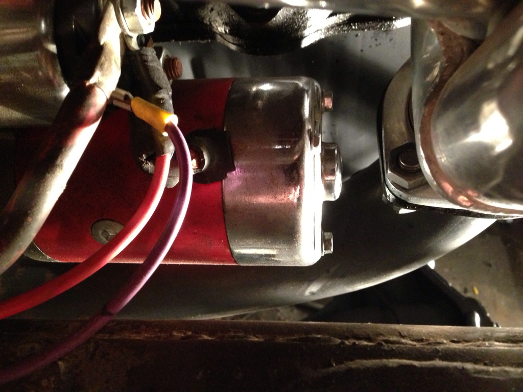

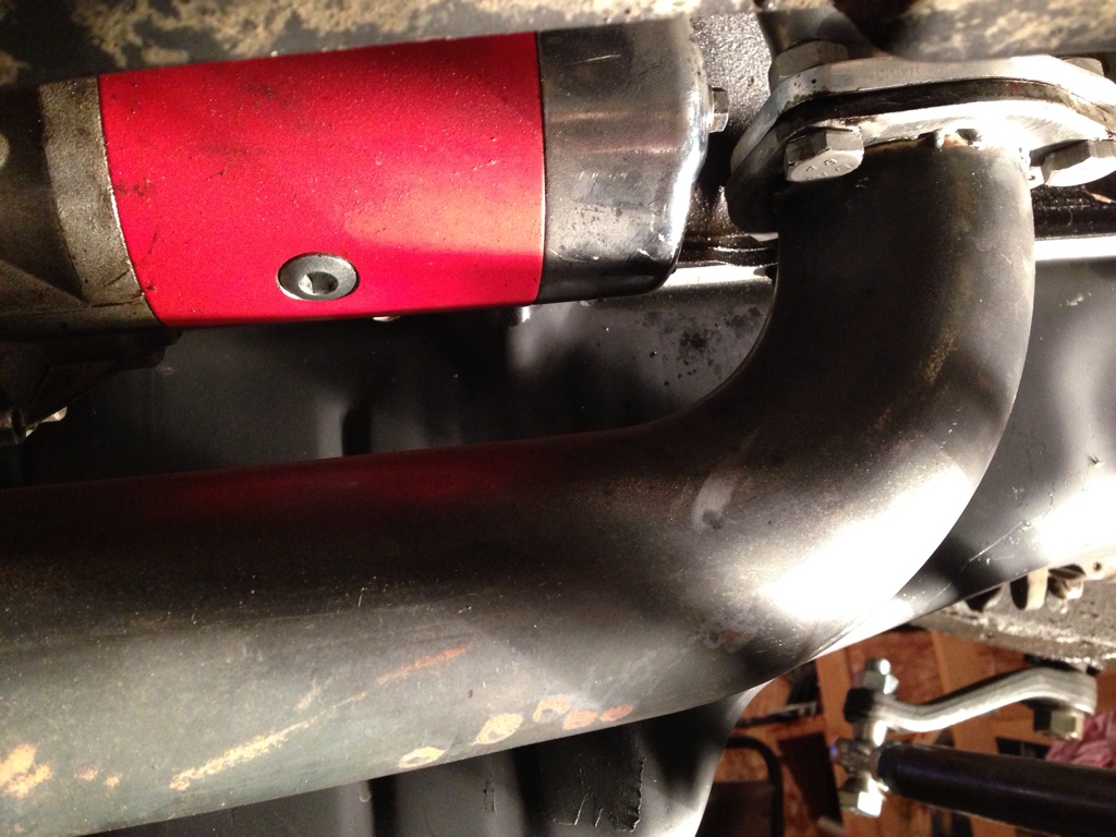

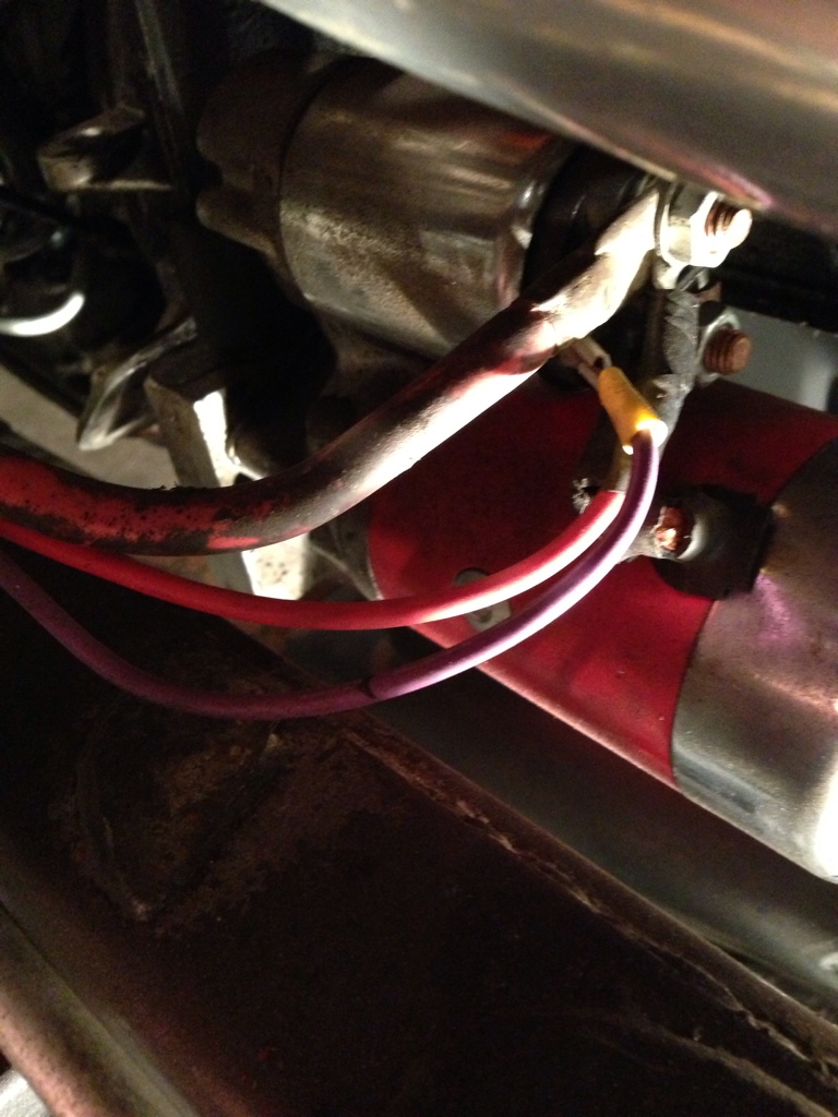

Travis do you have trouble with your headers getting your starter to hot

Yeah I have some trouble with it getting hot. Always starts but I had cooked some insulation on my wires to the starter. I have now changed my starter to a mini and changed my exhaust. It's got a little more room now so I'll see if it helps when I get it running again. I thought about wrapping the starter or exhaust. Might still do it later.

well i thought the mini starter as well but with the toyota slave cylinder where it is i can't put a mini starter on because of the line running to it. I have manifolds on it now but frame is in the way of running any exhaust past that so i have some shorty headers i'm going to put on and guess do some wire wrapping starter and header
I'll post a few pics of how my starter and exhaust are when I get home tonight.

Old Feb 19, 2013 | 05:43 PM
  #131
travis_h's Avatar
Joined: Nov 2010
Posts: 301
From: matawa,wa
