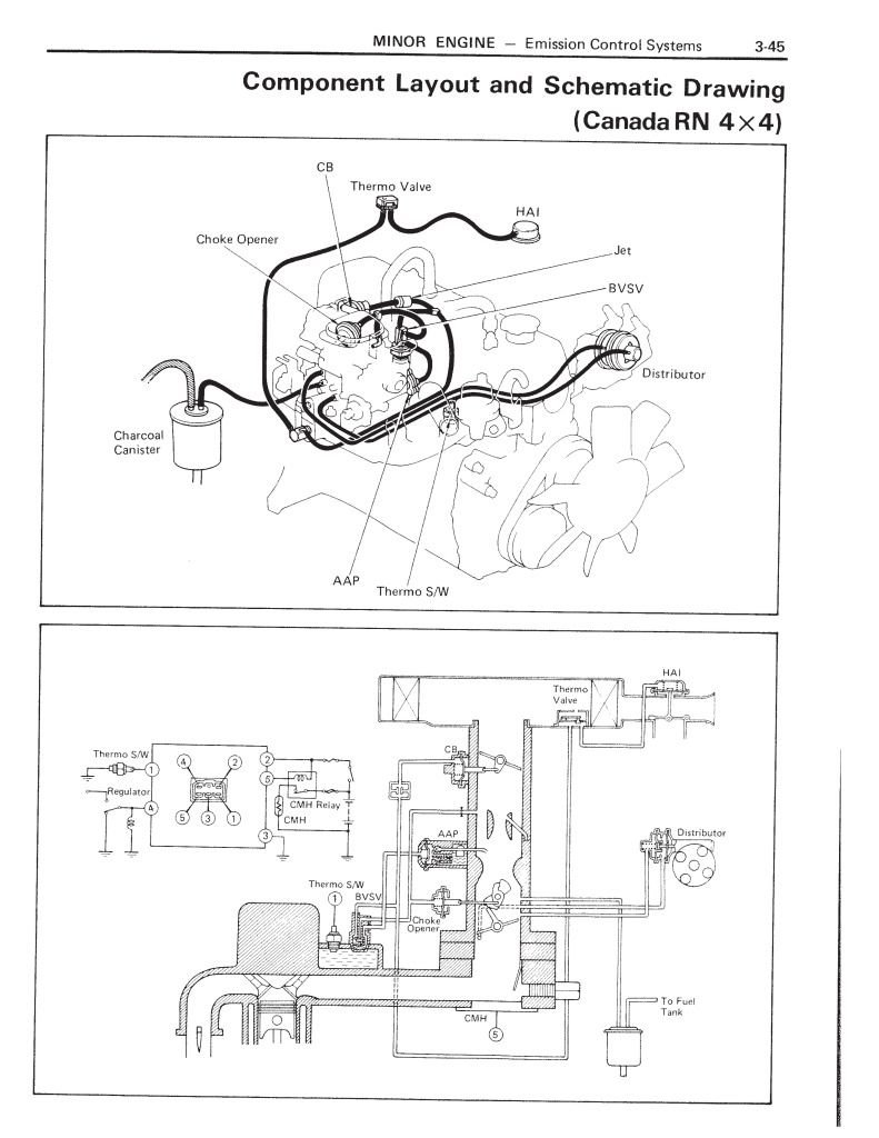

3 quick questions for the experts.
I have 4 sensors around my thermostat housing. I know one is the BVSV for EGR. I know one will be for the temp gauge, but what are the other two? Green/red and yellow wires in the pic.
Next, is this little length of hose correct? I cannot remember if it was there before I started. It also looks like it has some liquid (gas I think) leaking from the hardline when it is disconnected. Is that the symptom of a torn AAP diaphragm? Idle is high with it disconnected and capped off.
Finally, is it possible to remove all the vacuum hardlines while still keeping EGR and the stock carb? The hardlines make it impossible to trace where vacuum is going. I have read that EGR is only a good thing and would like to keep it intact. I know this is a controversial opinion.

Looks like you have yourself a California emissions truck - my answers below are based on that assumption.
In the first picture:
*Green w/ red stripe --> thermo switch #2
*Green solid --> thermo switch #1
*Yellow w/ green stripe (should have a green stripe on it) --> Water temp sender to the gauge cluster
In the second picture:
*I'm not 100% sure, but it does look correct. Also, If you pull that vacuum hose (or any other vacuum hose) and your idle goes up (not down) then it is likely that your carb is tuned too rich and the vacuum leak is actually adding air to make a more combustible air/fuel mixture.
Yes, you may remove everything but the EGR and retain the stock carb, but why? Typically the EGR on an older vehicle is completely clogged and actually counterproductive. Also, you would have a whole lot of vacuum hoses to cap which will likely lead to vacuum leaks when those caps deteriorate and crack. I would suggest that if you are going to remove some, you might as well remove it all.

Ah, I had it backwards. I guess the two thermo switches are just different set points for when to maybe turn off the CMH or start an evap purge? I always like to understand why things are done the way they are before messing with it. Not easy as every single year seems to be different.
I think mine's a federal, as it looks like the 1988 federal was the only one to have the below unnamed air pump can thing on the fenderwell. I also definitely don't have an EBCV or EACV.
Looking back at your first posts, it looks like the Canadian 4x4 didn't come with EGR from the factory. That's wild, so maybe EGR isn't as essential as I thought? The Canadians also don't have the OVCV or FCS, two things I need to kill on the stock carb.

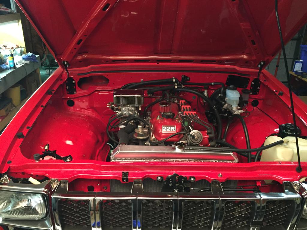

Working on the 100% desmog now, I already did weber and plunged all hoses, now I have the water plate for bottom of intake manifold and just a couple of questions.
My 4Runner has rear heater to. Can I still block the pass side water pump behind timing cover and the water plate in center of head? I'm just little confused what hoses I can keep vs block to keep my heater.
Also what did you use for the awaken on the intake manifold plugs? White thread tape? Or some sort of pipe dope stuff at Home Depot?
I can take pictures of my water hoses in engine bay if needed. I just have a few more than the pickups so wanted to make sure I did it right.
Also I have a conplete smog set up with converted ac to the new stuff. Worked great last three years. Just let me know it all came off a California model 4Runner (22R)

Hi I am confused where the heater runs. one side is from the intake manifold barb that came with the lce block off plate (input). But where does the other side go (output)? do I not use one off the block off plates and run it there? thanks for the great write up
Originally Posted by kawazx636
NOTE (11/30/2015): I talked with a tech from LCE a few weeks ago about the timing and advance on my truck and he said that the idle/manifold advance (port closest to the head) on the distributor is not necessary to use (#1 in the pictures below). I have since removed that vacuum hose and plugged the fitting on my setup and my truck is running well with a a more appropriate advance at higher RPM.
You now only need TWO, 2, DOS, DUEX vacuum lines!
1) Main/Port Advance - From the vacuum port on the distributor closest to the radiator to the vacuum port on the Weber.
2) Sub/Idle Advance - From the vacuum port on the distributor closest to the head to the vacuum port on the intake manifold. For the manifold port I installed a 1/4" NPT Male to 3/16" barb fitting on one of the existing holes on the intake manfold (temporarily plugged earlier).
You will only need about 6ft of 5/32" vacuum hose. See below:
Also in the picture above, you can see the 90* barb I installed for my brake booster (you can use the factory barb, but I wanted the hose to be better routed) and the 90* barb for the heater core that comes with the LCE Under Manifold Water Block Plate Kit.
