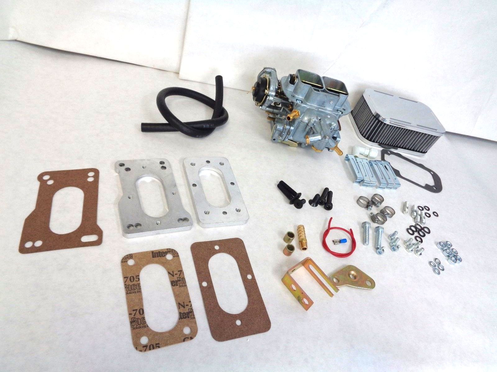

Hey guys. I have an 83 pickup that I want to desmog and convert to a Weber. I attached an image below of a Weber conversion kit for the 22R that shows all the parts that comes with it. I was wondering if someone could PLEASE tell me what parts I will still need from the list above? (I would prefer the manual choke but don't know yet if the kit in the attached image includes a manual or electric choke.)
Thank you very much.
Holley Fuel Pressure Regulator 1-4 PSI (12-804) - $28.95
Mr Gasket Fuel Pressure Gauge 0-15 PSI (1563) - $29.95
EGR Block Plate Kit (Cyl. Head) – 20R/22R/22RE/22RET (1016009) - $10.95
Air Injection Block Plate Kit – 22R/22RE (1045014) - $14.95
That is all you really need if you want to keep it simple and inexpensive. Many of those block plates you don't need to bother with. The EGR crossover block plate, for example, does not need to be blocked because it is already effectively blocked when you remove and block the EGR valve itself. You can even find some of these block plates for cheaper on ebay. Buying everything on that list is a waste of money. Unless you've got income to spare and want shiny block plates that aren't completely necessary. Also, you can buy various plugs, hose and fittings as needed locally.
Also, your picture is of a Weber with an electric choke.
Right, thanks for pointing out that the kit in the image had the electric choke. I found another kit with a manual choke for only $202.00 with free shipping (see image below.) I contacted the company that makes these kits (www.webercarbsdirect.com) and the guy there pretty much corroborated what you said. He said I will need the Holley fuel pressure regulator (part 12-804) but to leave it alone because it comes from the factory at 2.8 psi which works for the Weber. He said I only need a fuel pressure gauge if I buy a fuel pressure regulator that isn't the Holley. And like you said, he also said the EGE Block Plate Kit isn't needed and neither is the Air Injection Block Plate Kit.
Thanks again.

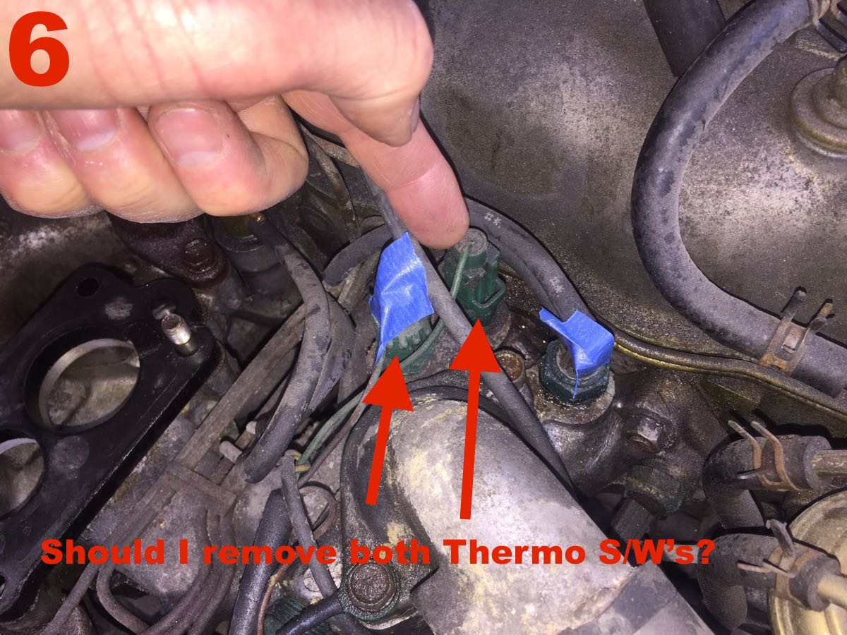

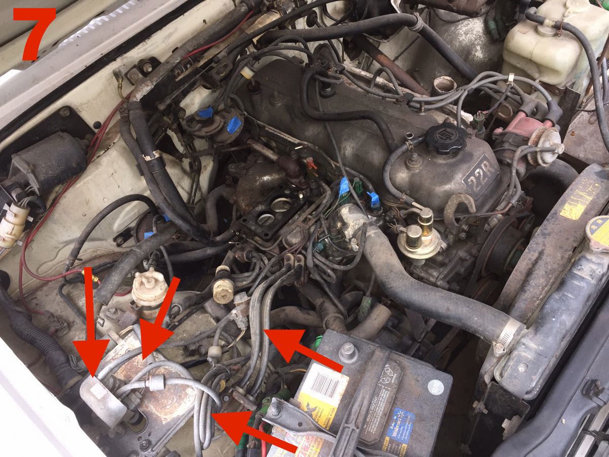

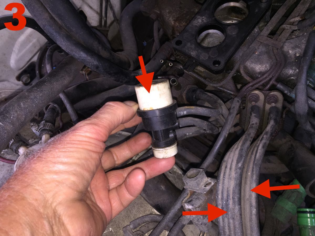

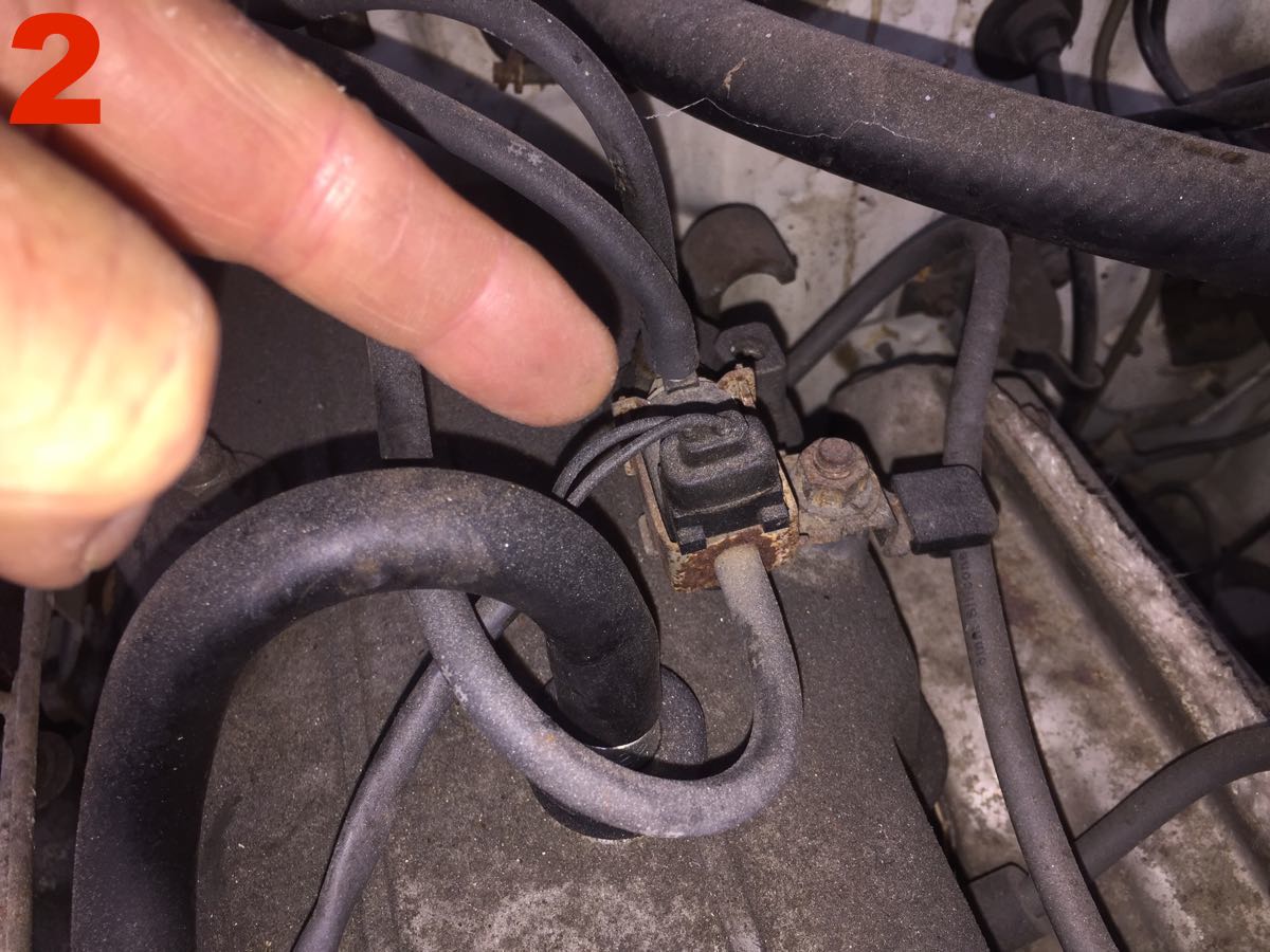

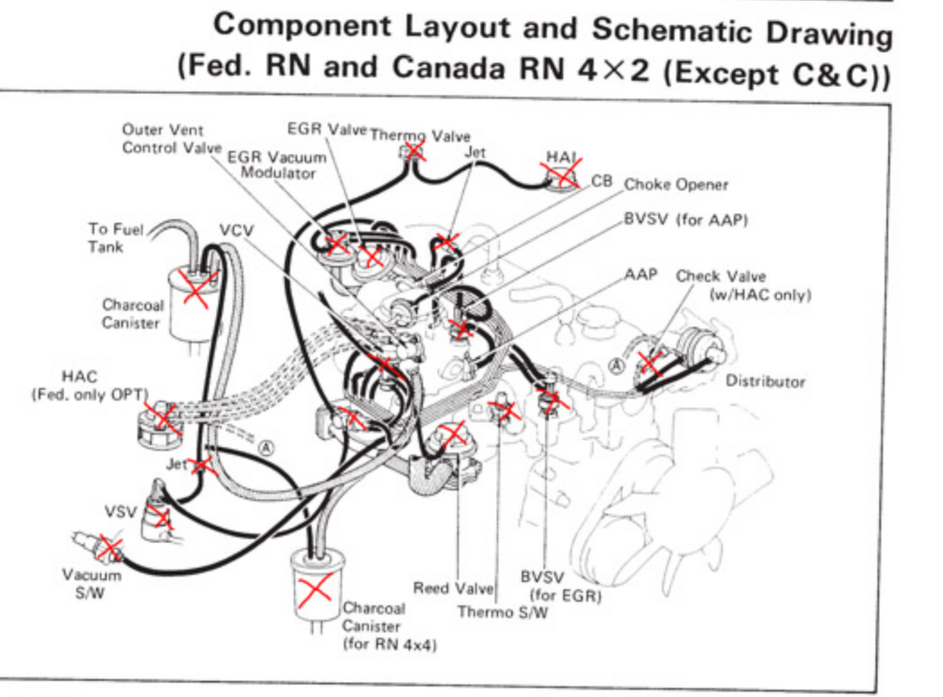

I'm not a mechanic so please bear with me. I'm installing a new Weber 32/36 with manual choke. There are a few parts on my California 83 22R that aren't shown in the image of the emissions on page 1 of this thread, or they just look different than what I'm seeing, so I have a few questions, please.
Image #1: My 83 California 22R.
1) IMAGE 1: I see the charcoal canister on the firewall but I don't see the second one. Was a second charcoal canister not used in the 2WD California 22R?
2) IMAGE 2: Should I remove the part located on the valve cover behind the PCV valve and all the hoses attached to it?
3) IMAGE 2: Do I still need the PCV?
4) IMAGE 3: Should I remove the thing I'm holding and all the hoses attached to it?
5) IMAGE 3: Should I remove all the hoses that the two red arrows are pointing to?
6) IMAGE 4: Should I remove the two parts I'm holding and all the hoses attached to them?
7) IMAGE 5: Where is the Check Valve near the distributor that's supposed to be removed?
8) IMAGE 6: The image of the parts to be removed from page 1 of this thread (see "Component Layout and Schematic Drawing" below) show only one Thermo S/W next to the BVSV but my California 22R has two Thermo S/W's next to each other. Should I remove both?
9) IMAGE'S 7 & 8: Should I remove all the hoses and parts including the bracket the arrows are pointing to?
THANKS!
Attached Thumbnails 22R Desmog Tutorial-smog-remove.png   22R Desmog Tutorial-california-smog.png   22R Desmog Tutorial-1.jpg   22R Desmog Tutorial-2.jpg   22R Desmog Tutorial-3.jpg
22R Desmog Tutorial-4.jpg   22R Desmog Tutorial-5.jpg   22R Desmog Tutorial-6.jpg   22R Desmog Tutorial-7.jpg   22R Desmog Tutorial-8.jpg
1) IMAGE 2: Should I remove the part located on the valve cover behind the PCV valve and all the hoses attached to it?
2) IMAGE 2: Do I still need the PCV?
3) IMAGE 3: Should I remove the thing I'm holding and all the hoses attached to it?
4) IMAGE 3: Should I remove all the hoses that the two red arrows are pointing to?
5) IMAGE 4: Should I remove the two parts I'm holding and all the hoses attached to them?
6) IMAGE 5: Where is the Check Valve near the distributor that's supposed to be removed?
7) IMAGE 6: The image of the parts to be removed from page 1 of this thread (see "Component Layout and Schematic Drawing" below) show only one Thermo S/W next to the BVSV but my California 22R has two Thermo S/W's next to each other. Should I remove both?
That's a pretty confusing post and I didn't try to read through it all and match with pictures. But the overall answer is YES. You can rip all that ˟˟˟˟ out of there. The only vacuum line you need is one to the distributor and the large one for the brake booster. PCV valve is optional. You can put a little breather filter on top of the valve cover instead.
The truck will run great without all of the smog equipment but many people overlook that some of this stuff is of benefit and makes the engine run more efficiently. I made a diagram which is a few posts back which includes emissions items I reinstalled after doing my engine rebuild. But for simplicity sake, yes you can rip out all the things you're asking about. One of those temperature sensors is likely for your dashboard temp gauge though.
I made a couple edits while you were replying I guess, but thanks for getting back so quickly. One question: Does removing all that stuff even include the parts, bracket and multiple hoses that I have arrows pointing to in images 7 and 8?
Yup! Rip that stuff out of there! You can literally rip out every single vacuum line. And every single switch a vacuum lines runs to. I know how you feel, I was there once too and I was hesitant about pulling certain things out. I asked very similar questions on this forum. It really is true that you can rip every bit of that stuff out. Rip it all out and it'll be pretty satisfying. Then you can simple reinstall the things you need.
Here are a couple pics of the engine bay of my 89 after I removed all emissions stuff and installed the Weber. I had 2 lines running to the distrubutor and one line going to the brake booster. That's it. All of the other items you're asking about are removed.
EDIT: PCV valve and the other valve cover breather hose I kept intact. They just feed raising gases in the engine into the carb to be burned. I just did an engine rebuild in my other truck and kept the stock carburetor and I also decided to keep a number of other emissions items. However these pictures are appropriate for the weber.
