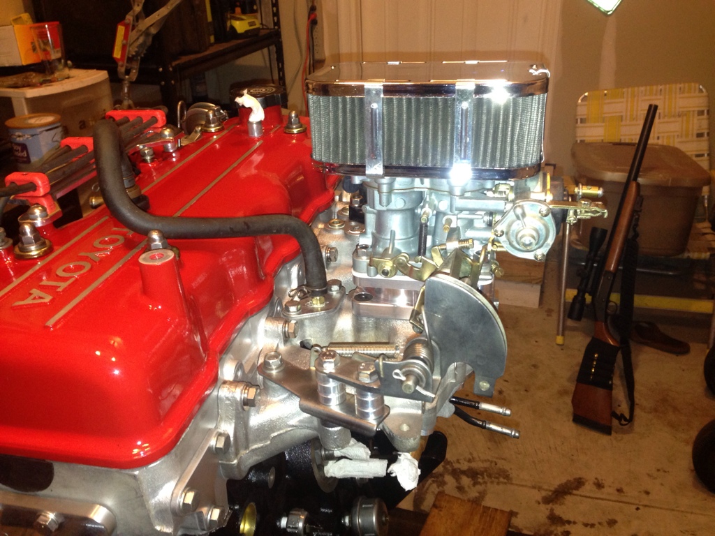

I also got the lce spiral adapter but can't seem to figure out how to mount the throttle cable back kn now. Well the half circle piece is the problem. I'll call lce in the morning Hopfully they have answer. But thanks for all your help. I'll report back with some pics when it's running. It's looking really good so far tho.

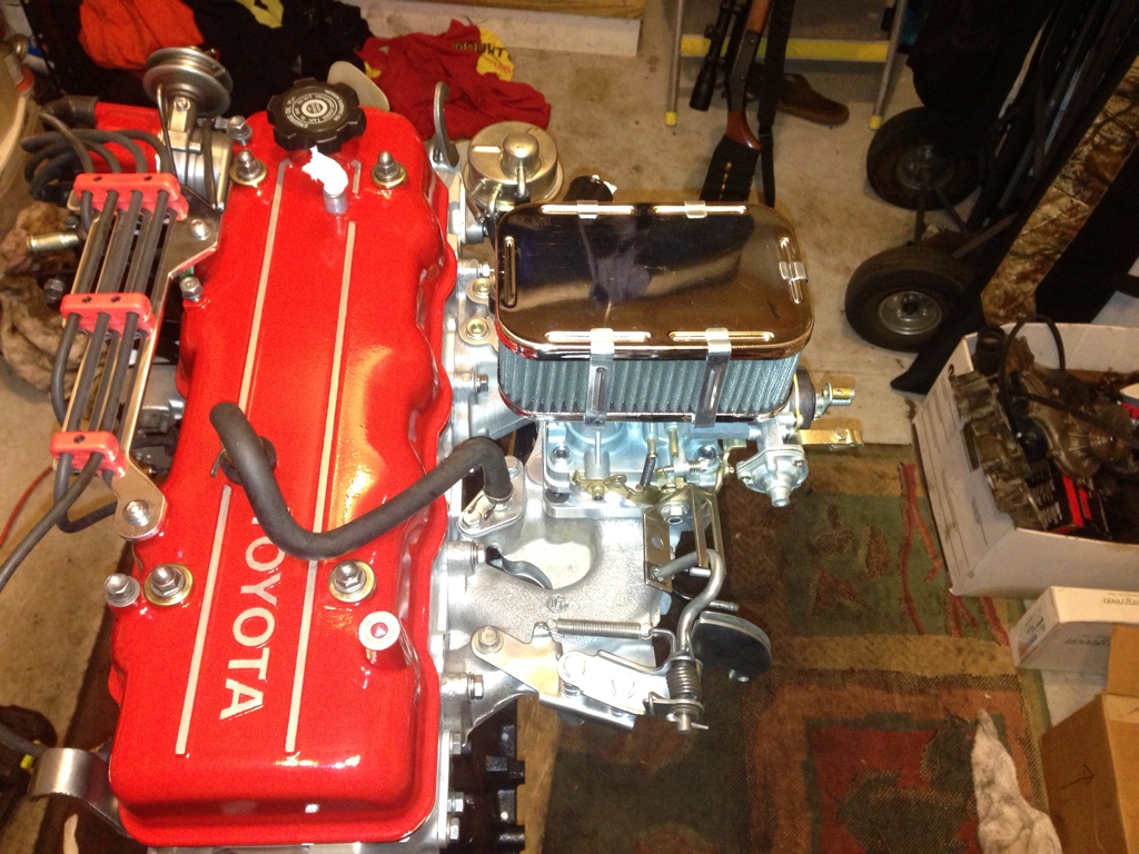

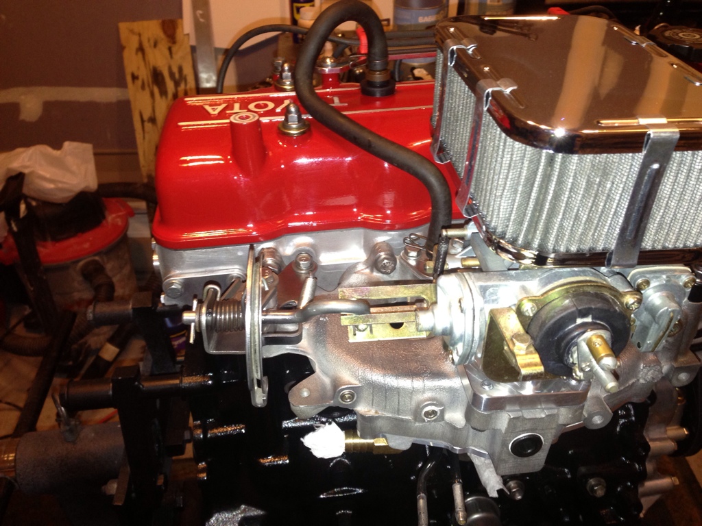

Half circle piece? I'm assuming you mean the throttle cable cam? Here are some pictures of my throttle assembly, maybe they'll help you out:
