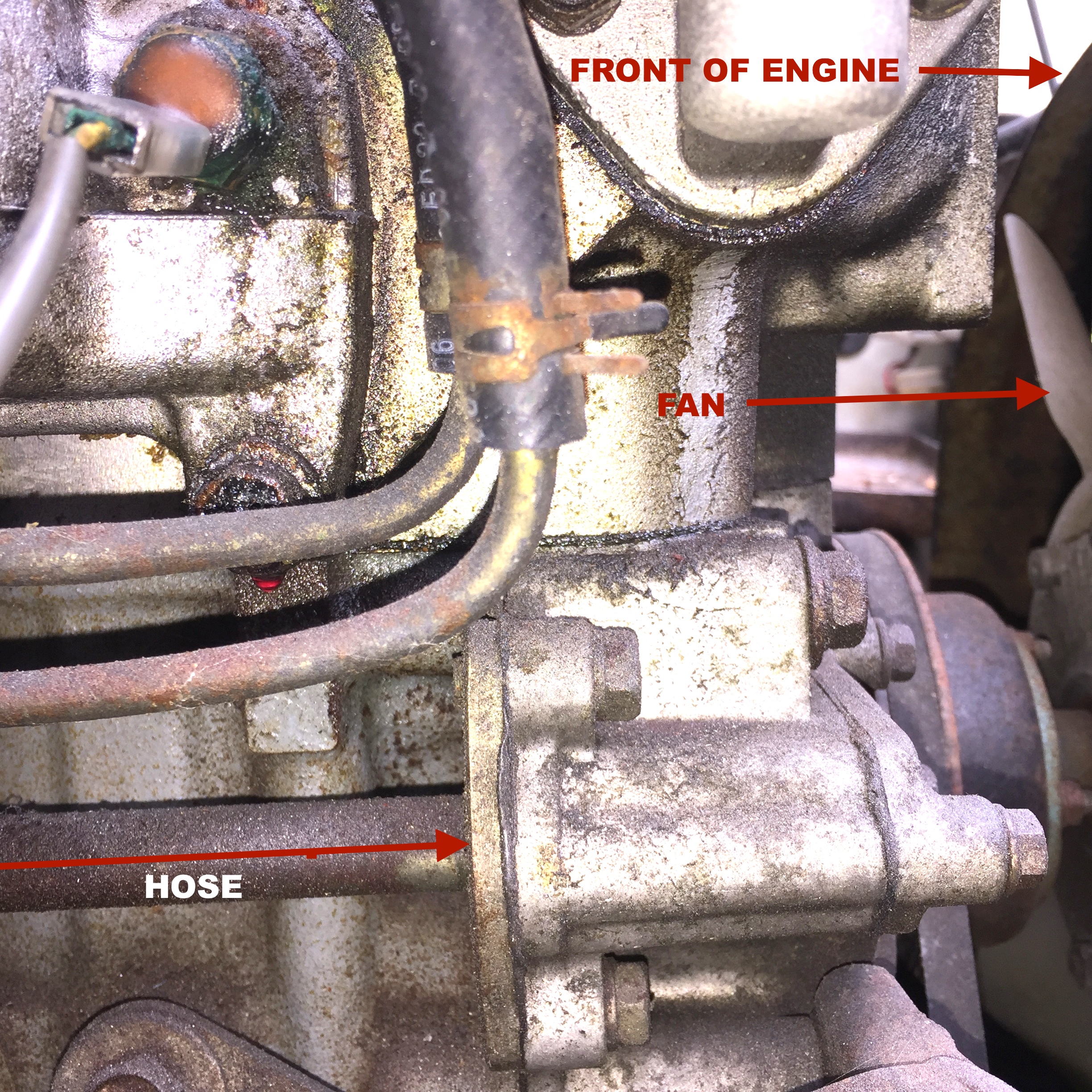

I think I have all the smog junk off but there's still a hose that runs from the front of the engine (SEE IMAGES BELOW) and connects to something under the intake manifold just a little bit behind and below where the carburetor is. Does anyone know what that hose is for and what I should do with it?
Thank you.
Thank you.
that's a coolent line, leave it. Pretty sure it is necessary for your cab heater. Not emissions related I can tell you that much.

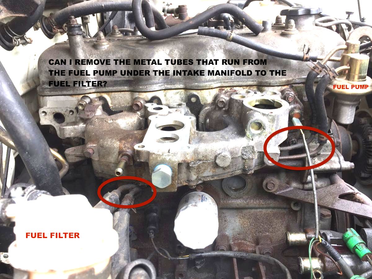

I'm getting close to finally installing the Weber 32/26, but there are 2 lines that run from the fuel pump to the fuel filter. You can see in the image below circled that they connect on both ends to 2 metal tubes that run under the intake manifold. Can I remove those two metal tubes?
ANSWER: I asked LCE and they said I could remove all of that stuff.
Thanks

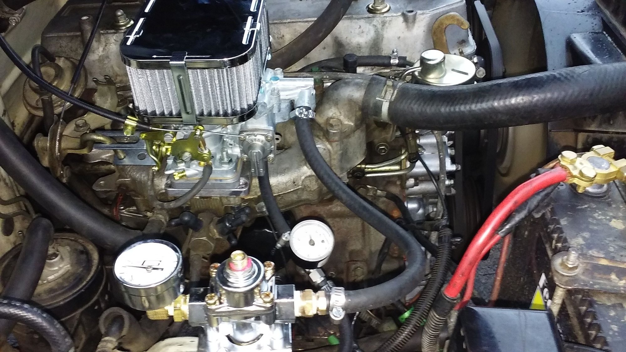

Why do you have two gauges?
thought it would be cool to have one gauge showing pressure to the regulator and one out, that's the one you need, on the reg. Thought it would help me monitor the fuel pump so I would know if it was crapping out on me. I had a little trouble with the T fitting on that one not leaking and just didn't like it just hanging there so I ended up ditching it.

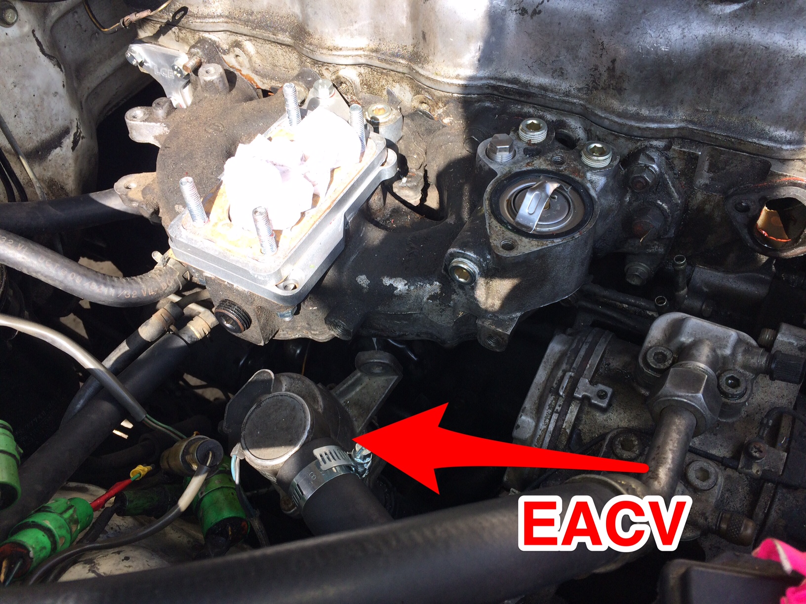

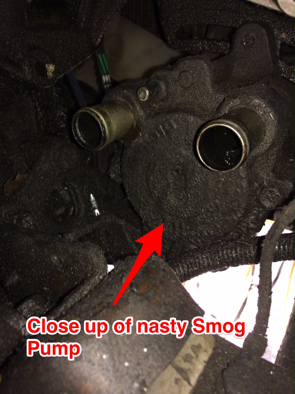

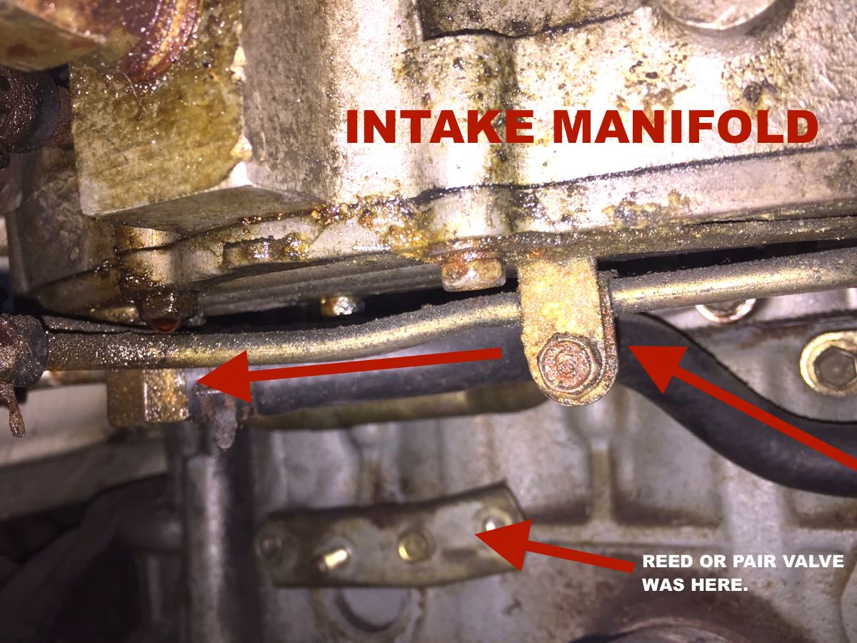

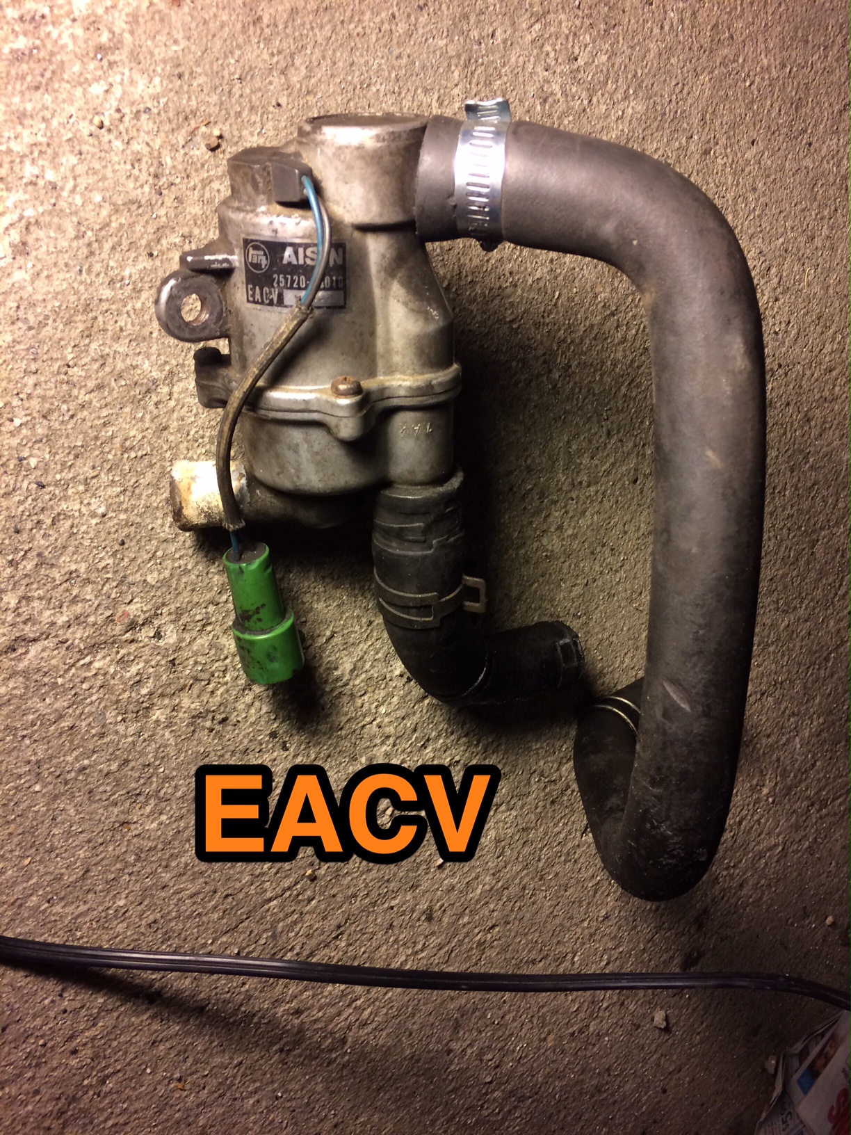

I have a 1983 SR5 4x4 manual shortbed in the process of desmogging. It's a California version with A/C. Here's some pics I took while removing the EACV, turning the SMOG PUMP into just an IDLER PULLEY, plugging a few holes and fabricating a FUEL PUMP BLOCK OFF PLATE (adding Carter 4070 electric pump). I hope these pics help if you see something in your engine bay that you can't find in the FSM.
And yes, the engine is filthy. The goal is to get her running and drive to the acid bath shop for a FULL CLEANING! I'm in the process wiring an oil pressure switch to a relay to the pump... "on a good day" I'll get some pics and see what the peanut gallery thinks.

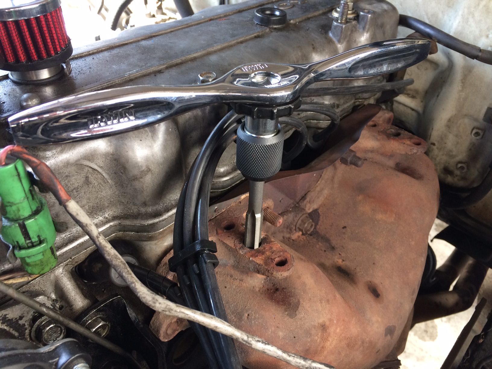

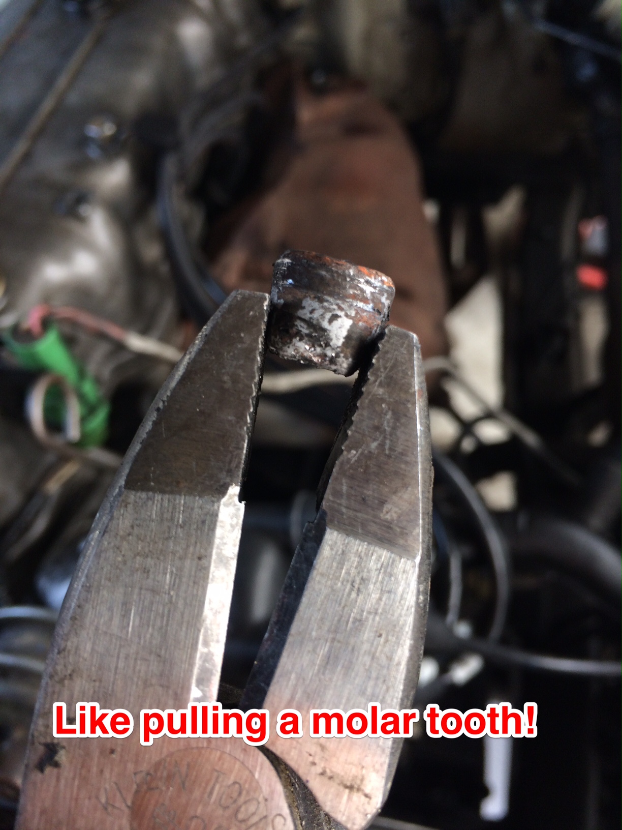

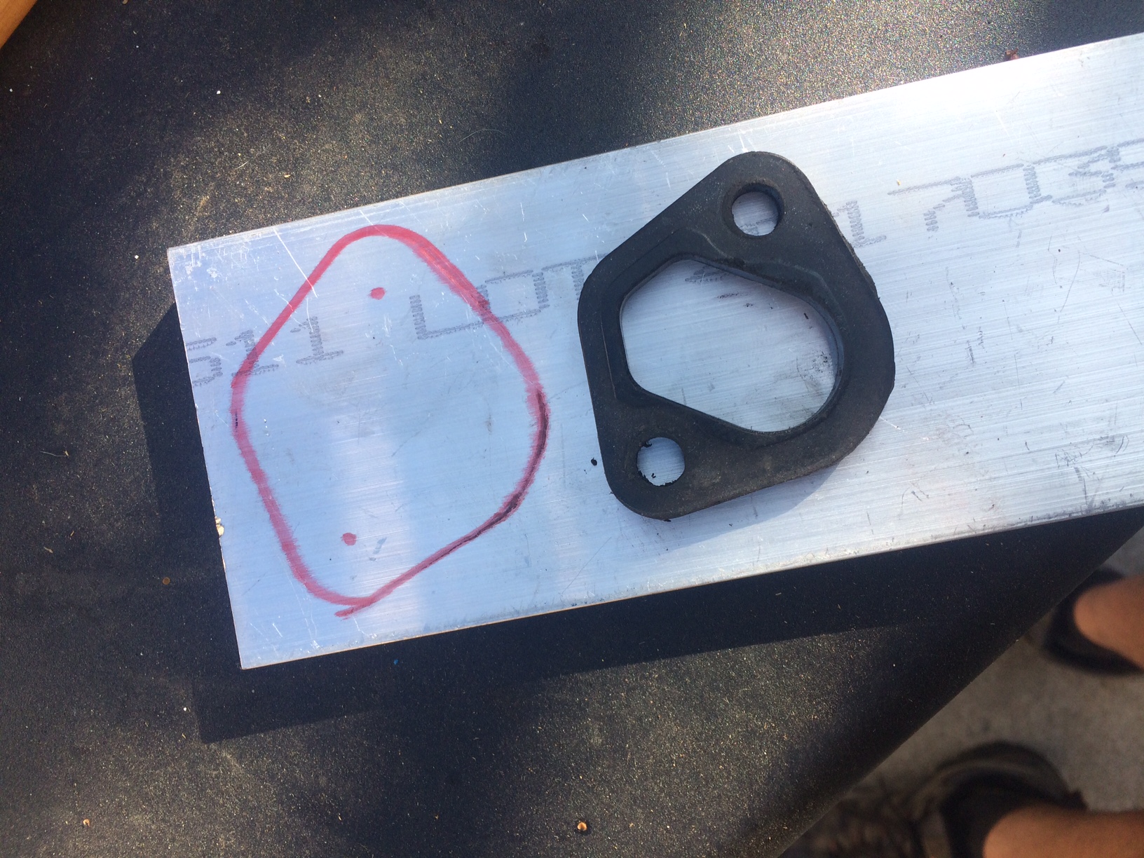

I lined the template up on one straight edge so I only had to make 3 cuts... aluminum is a pain.
Anyone wired a 1/8-28 ISO 3 wire oil pressure switch? Know a PS### that works with 22r? Something that works with PS123

bonus points for getting an easy out to work! Lol
