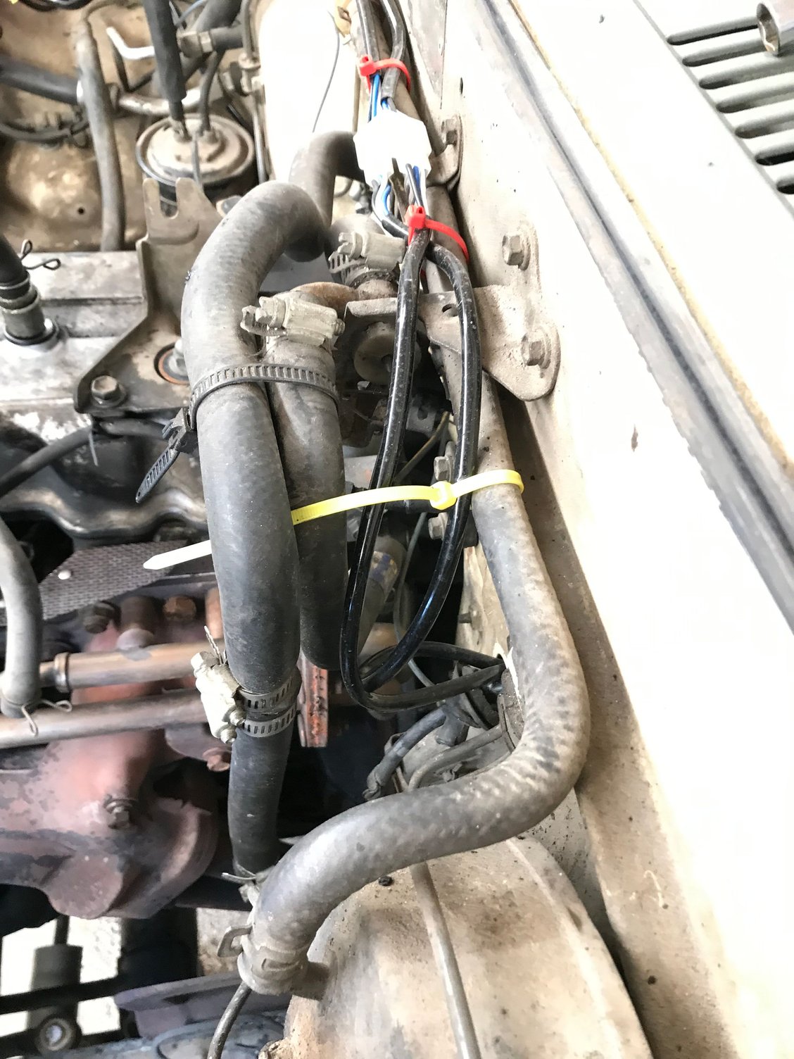

ok figured out the heater hose routing.
Left the stock hose from heater core connected to drivers side , back of timing cover. Other short hose from heater core stays connected to the valve.
Long hose from valve goes to the fitting on the bottom of the LCE intake plate.
Desmog and Rebuild is complete and I started it for the 1st time Thursday night. Had to keep choke (manual choke ) at half way to keep it running. Shut it off and readjusted idle and fuel mixture per Weber instructions.
Fired it back up and it idles nice and smooth now, no choke. Let it idle for around 20 minutes. Still running stock Jets for now.
Have a small water leak at thermostat housing.
Fixed that last night, hopefully.
Will start it up this afternoon after work and check for leaks again. Gonna attempt to get it out of my shop and go for a test drive
Still have 3’ of snow on the ground.
22R rebuilt

Congrads, you are in the final stages. Glad to hear, gives me inspiration to work on mine, like you, got the cold weather and the snow to deal with.
I am thinking about putting the drivers side pipe from the timing chain cover back on. I removed it and put the block off plate on but If I put the original pipe back on it would end up being a shorter water hose from it to the valve. Otherwise the water hose would have to come off the water pipe down by the motor mount and that run is a lot longer.
Guess I'll figure it out when I get there.
Again, congrads, Enjoy your test drive.

Thanks Mike!
In the above photo you can see the hose and pipe on the drivers side you are talking about.. I just disconnected it from the timing cover then bolted it back up after I reinstalled the timing cover. Passenger side has the LCE plate.
it's a lot less hose using the factory steel line. My longest, and only non stock hose was the one from the heater valve to the bottom of the plate on the intake. It comes of the valve, loops down and behind the head to the intake.
I also think i need to swap my vacuum line on the dist to the back port after re-reading some of Kawa's posts.

Yeah, I think I'm going to change it back to the steel pipe (original) and plumb from there. There should be a stock hose for that someplace that goes from the end of the pipe to the heater core, just have to find it. As far as the other hose connection down by the motor mount, I guess I'll just plug it.
