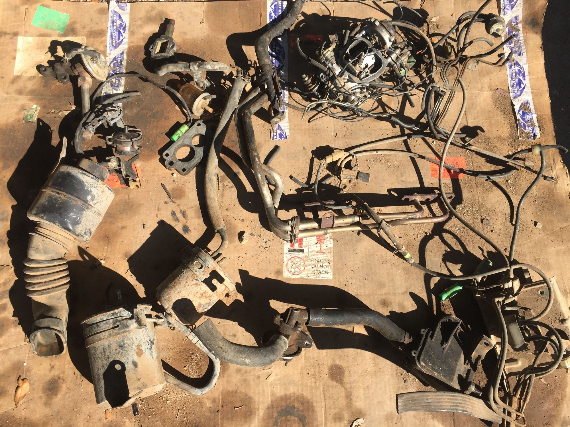

Another succesful desmog thanks to this thread! Look at all this junk you get to nix from under your hood. Feels great.

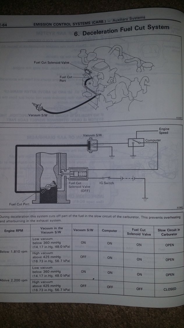

I'm almost certain I have it figured out. It was the "vacuum switch" after all. The FSM doesn't come out and say what exactly it does, but does detail a test (page EC-65 in the 1987 FSM) that involves pinching off the hose to it and seeing if the engine sputters between 1800 and 3000 RPM. The idea I think is that if you let off the gas all the way, the idle jet is blocked so no extra fuel gets wasted. Mine is still messed up, as I get a lot of exhaust popping, but that I can live with.
With the VS removed and disconnected, it cuts fuel to the idle circuit even when you are in light throttle, (light enough to be using the idle jet) this was causing my stumbling problem, and also explained why it didn't happen when I was more on the gas, since it was using the main jets by then. Some other posts on the "light load stumbling" issue suggest a failed FCS, but I haven't seen anyone suggest the VS yet. Then again, desmogging the truck is a special case.
The behavior of the circuit seems counter intuitive, since you'd think the fuel cut would be triggered by seeing vacuum on that port, while having it disconnected would be telling the computer that the throttle is not at idle. Since the emissions control computer is TTL based, however, the input will have a tendency to float to a "logical high" voltage, which based on the diagram of the switch will actually send the "idle position" signal to the computer. Thus, the truck will hit the fuel cut solenoid whenever the engine speed is high enough (2200 RPM on mine). Once again, this doesn't cause a problem if you are off the throttle or on it enough to be using the main jet.
A proper way to get around this will be to ground out that input (telling the computer you are always on the throttle), remove/disable the fuel cut, or get the Weber like OP said. I will try the first option when I have time. Until then, I'll just leave it on there.
Interesting as well, earlier I was asking about the idle advance being plumbed into the same circuit as this Vacuum Switch. Turns out they are both looking at the same thing, trying to activate only when the throttle is at idle. I guess Toyota was pretty smart when they were figuring all this out. Neat stuff.
Here's the page that explains the operation, maybe it will help someone else:
EC-64 deceleration fuel cut system
