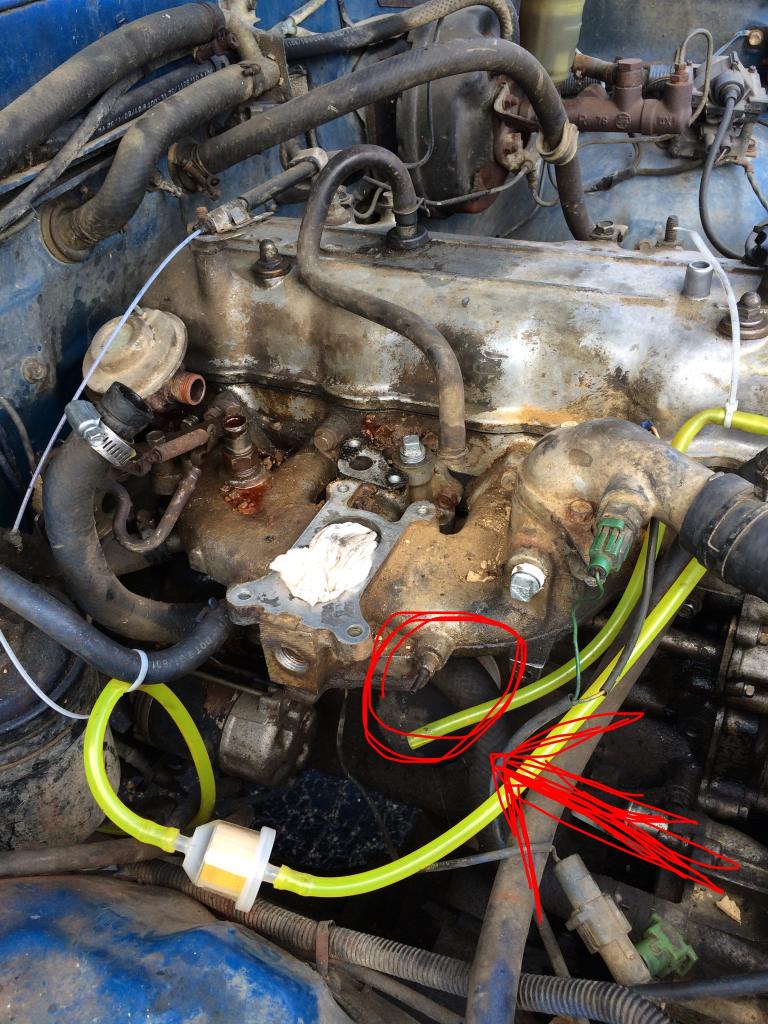

On my 20r I don't see that port for the vacuum line to intake manifold. I have mine hooked up to carb so I only have one vacuum line. Am I missing something?
He installed a new barb into one of the existing holes:
2) Sub/Idle Advance - From the vacuum port on the distributor closest to the head to the vacuum port on the intake manifold. For the manifold port I installed a 1/4" NPT Male to 3/16" barb fitting on one of the existing holes on the intake manfold (temporarily plugged earlier).

So can I use the port I have circled in the picture and put the barb in it and attach my vacuum to it?

I don't have a port where you show yours. I have tried to find a fitting to use where in the manifold where Dave shows it but it's BSTP thread and I can't find it anywhere. Anyone else have any luck finding that fitting?

Here's a little more info on what those vacuum ports do from pg 9:
Originally Posted by kawazx636
Glad that I could help! Some of the block off plates aren't absolutely necessary, but They do clean it up a bit. As for your advance question, one is your idle advance and one is your main advance. The idle advance just advances the timing under normal manifold vacuum at idle and the main advance is what advances the timing with increased carb vacuum through the RPM range.
That manifold (in the above pic) is from a 20r, but a barb there should serve the same purpose.
As for size, majority of the bolt sizes around the head and intake manifold are M8x1.25. But you'd have to pull whatever was in that port and take it to the hardware store with you. And I'd say the smaller hardware stores would probably have a better selection of metric stuff... Unlike lowes.
If you have too hard of a time finding the right one you could always drill out the existing hole and tap it with a more common thread count.

Thanks.. I am going to run my other vacuum to that port and run it. Is there really any big advantage of having the other vacuum line because right now I only have the one going to my carb and the other is plugged..

You would need both to keep the correct timing.
