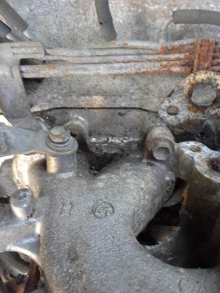

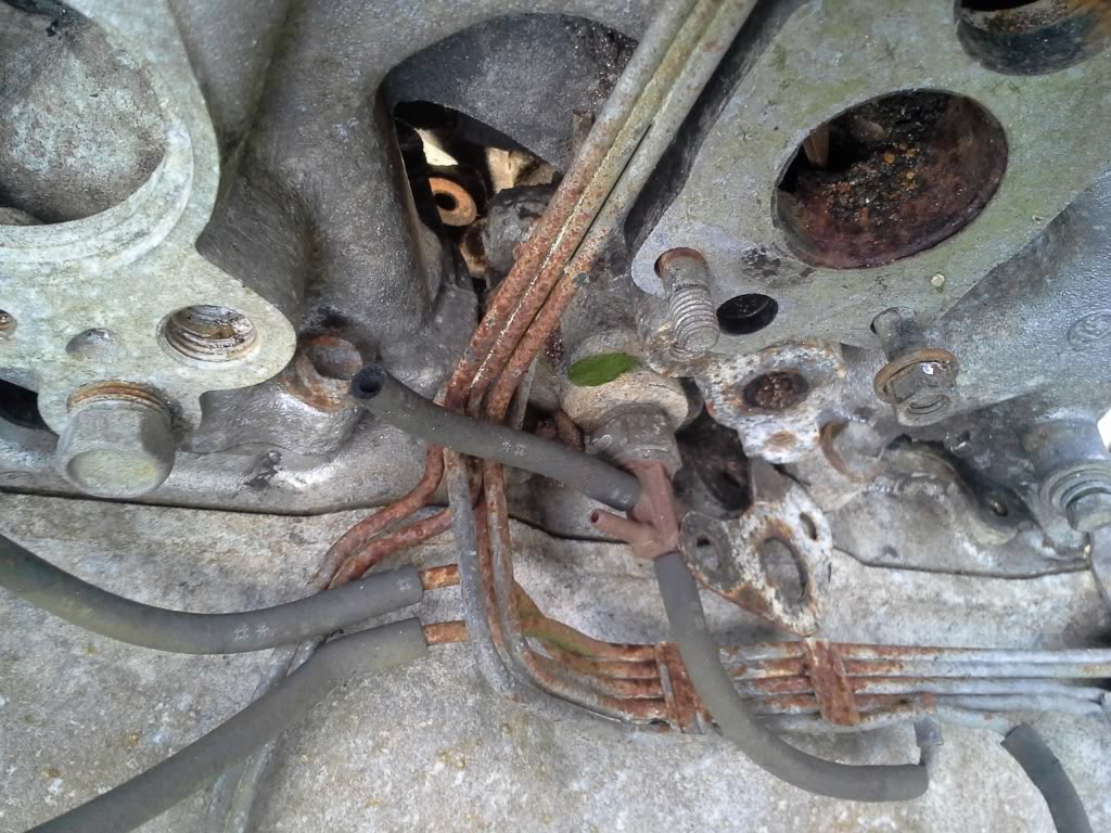

After talking with Kawazx636, he brought to my attention that I should post some of the problems I am having on my desmog.
I own a 1982 4x4 shortbed. I recently picked it up from Vegas and it was not running all that great. There were unhooked vacuum hoses all over, oil all over the motor (still some on there!) but a rust free body. I am no mechanic, but certainly not afraid to get my hands dirty and learn a thing or two. So I started off copying and googling all the desmog parts that the generous Kawazx636 decided to share. Since he owns a 1983, my 1982 should be the same exact thing right? AHH not! I ordered an 11 bolt block off plate but my intake needs an 8 bolt one. Being new to all of this, I didn't even know where the plate went until I started digging in. No biggie, as it's an easy swap. The real problem is on the head. I do not see a plate for this hole (see photos), and the manifold only covers half of it. Also, if the did make a plate, it wouldn't fit because again, the manifold needs to bolt up there. For the life of me, I cannot figure out what I took off that was originally there. I even looked at the fsm that was posted but cannot figure it out. Help anyone?
[IMG][/IMG]
[IMG][/IMG]
Old Jul 9, 2013 | 02:10 PM
  #66
Stetson_md's Avatar
Joined: Nov 2012
Posts: 698
From: florida
Its upsidedown but that's what gose there dunno what its called

I think that one is in the center of the manifold. My problem is more to the left (closer to firewall) between the 2 plenums.

Is it actually a passage of some sort or is it just a void in the head casting? If there's a passage, is it for coolant or just emisions/exhaust recirculation crap?

Here's another pic

ok, this is my 20r, the intake manifold runners split like yours, if there is a piece of sheet metal in there, its well hidden, i poked at the area and it feels like a gasket was just slapped over the hole with fipg,
i had a hard time getting a good angle but this is the area in question

Plowzilla, that hole is just a hole-nothing functional about it. It is just a cavity in the head. I just ran out to my garage to double check on my spare head to verify that. You wouldn't need a plate for that.
As for the rest of you guys posting pictures here, do yourself and the rest of us a favor and draw arrows to or circle the parts/areas that you are refering to. It'll better help us get you answers quicker. I'm not trying to be an ass, I just like to be as efficient as possible so we are all making progress.
