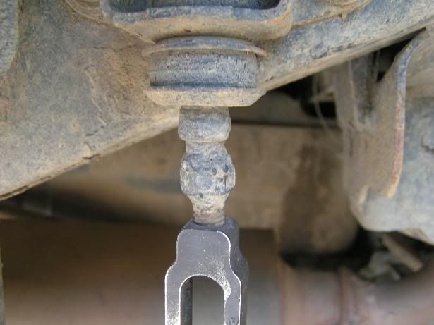

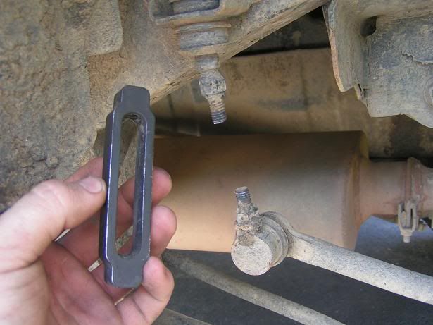

I used turn buckles.
I cut the eyes off of the studs, and welded them to the 1/2 in of swaybar link that I left on top and bottom after I cut them.
Then I just thread the actual turnbuckle on to the studs and walla It holds even if I pick up a wheel. And it disconnect faster than regular discos and when you upgrade the lift you just buy a longer turnbuckle link.
it cost me like 5 bucks and 30 min.
If you want I can post pics....
And yes they are proven strong!!!

give me as many pics as you can $5 is a lot better the $45

k ill try to get them up tomarro night

heres the pics of my discos. I used a nut as a sleeve to join the stud with the link (its what I had laying around, I did this when I was board one day, I didnt even know if it would work.) I supose a piece of small tubing would work better...
