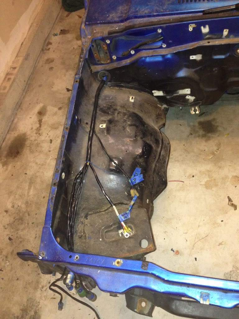

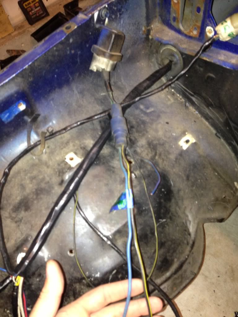

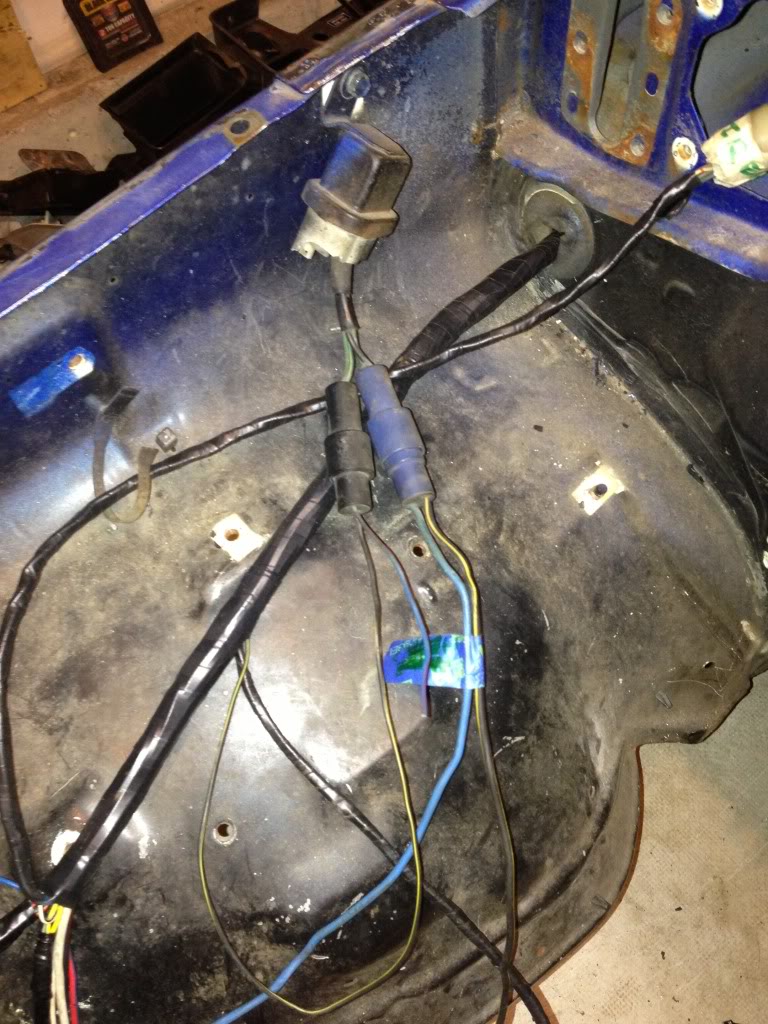

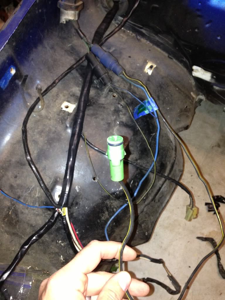

I'm assuming that you are talking about these wires:

  • BLUE PLUG (Pictured above)
    • Black w/ yellow stripe (heavier gauge) --> runs to the Cold Mixture Heater (CMH) on the bottom of the intake
    • Blue (heavier gauge) --> Ties into the "E" circuit (ignition power) - it will splice into a black w/ yellow wire somewhere under the dash before it runs into the ignition. The wire at your ignition will be black w/ yellow of a similar gauge.
  • BLACK PLUG (Pictured above)
    • Black w/ yellow stripe (small gauge) --> runs back to the engine fuse (common wire that connects the VSV, Fuel cut off, CMH and magnetic valve back to the 15 amp engine fuse)
    • Blue w/ red stripe (smaller gauge) --> this wire is not correct. The previous owner switch the plugs to the VSV and the CMH relay. The blue w/ red shown (Cut) should be plugged into the VSV and a similar plug with a black w/ red wire should be plugged into its place and run back to the emissions computer. Both the blue w/ red and the black w/ red run back to the emissions computer.
  • From your emissions computer (assuming non-california)
    • Black --> igniter
    • Green w/ blue --> speed sensor
    • Brown --> ground
    • Green w/ blue --> vacuum switch
    • Green --> splices into green w/ red going to the thermostatic switch
    • Yellow w/ red --> splices into yellow from alternator/regulator going to the charge light relay
    • Blue w/ red --> VSV
    • Black w/ white --> Fuel cutoff solenoid
    • Black w/ red --> CMH relay
If you want to cut all power to the emissions you can simply unplug the emissions computer and remove or cap off that heavy gauge blue wire going to the CMH. However, if you need an ignition power source, you could run that blue wire to a small auxiliary fuse box and that would carry enough amps for things like lights, radio, aux power outlet and such.

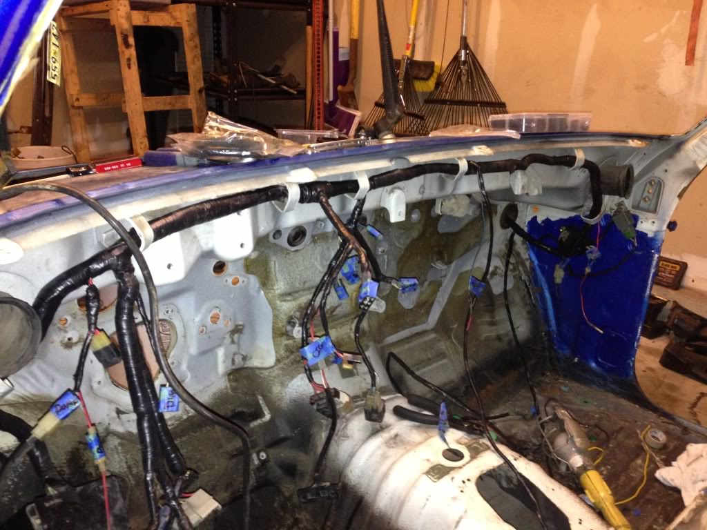

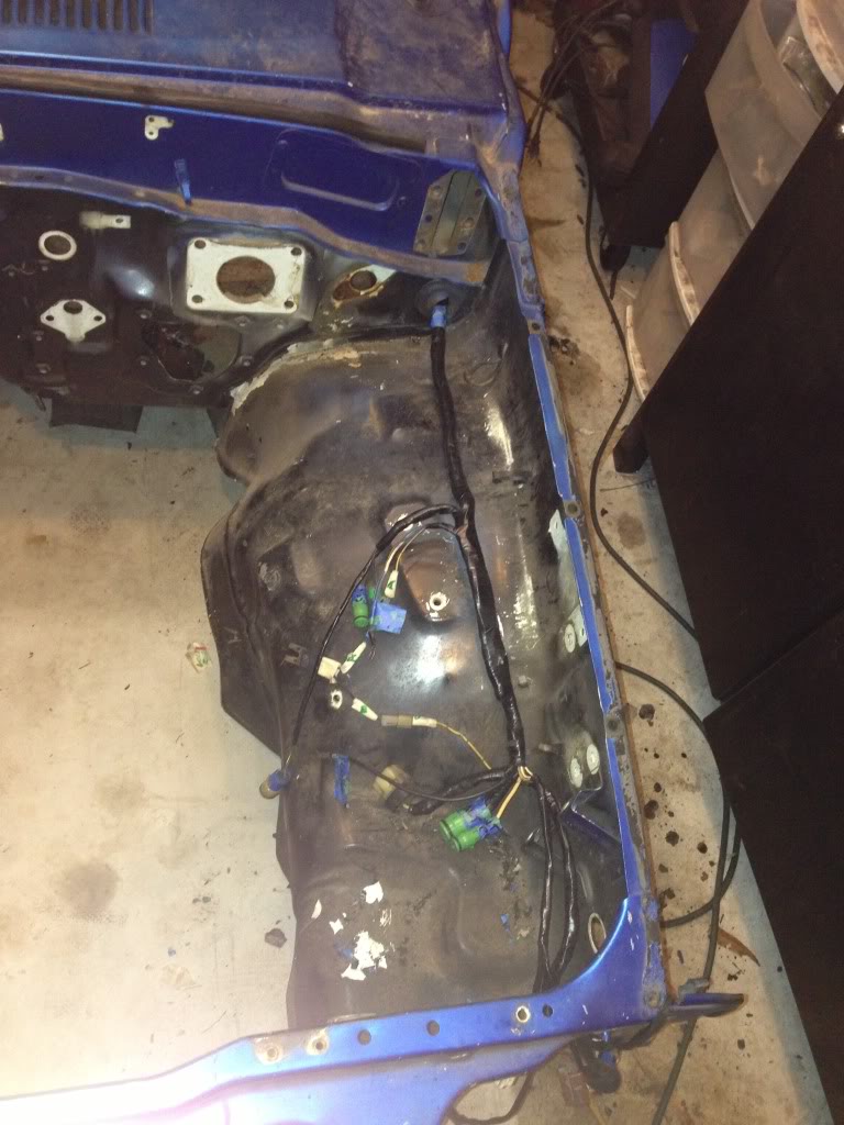

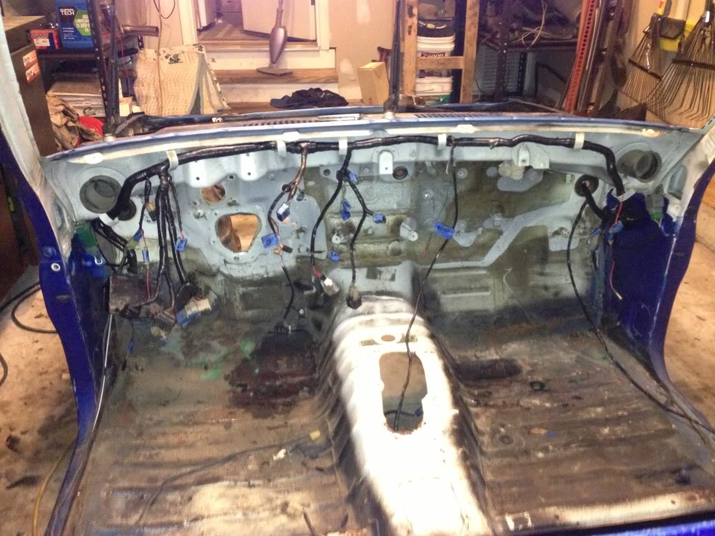

OR you can do what I did and remove all the emissions wiring completely. It really wasn't that hard and I did it in an evening. What I did was leave the harness in place and started unwrapping it at the emissions computer. I removed all the wiring coming from the computer and as I went I rewrapped the harness so as not to lose it's shape. The are few wires (such as the blue wire, the yellow w/ red wire, and grounds) that splice into other wires that you still need. Just make sure you tone them out on each end to make sure you are pulling out the right wire. I played it safe so as I went through the harness I only taped it back together every 6 inches or so and when I got to the end, I started going back the other way through the harness removing anything that was left from the first pass. There at a LOT of wires that can come out, but Worked out perfectly for me!
This is what it looked like after I finished pulling the emissions wires (obviously it is easier with the dash removed):

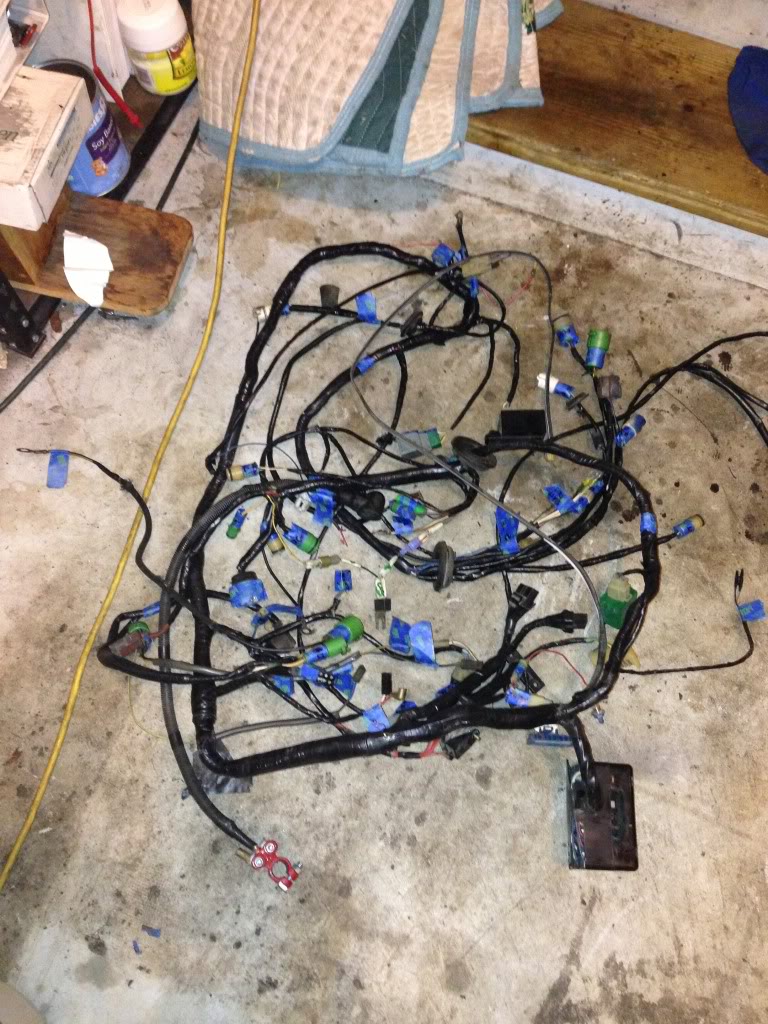

And this is what it looked like in a heap on the floor:
