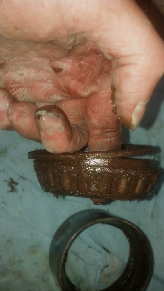

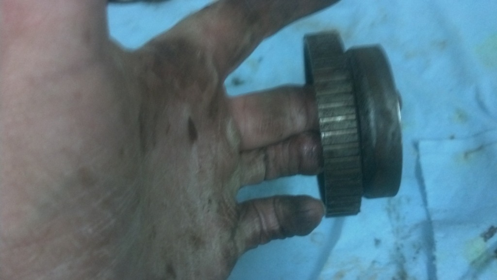

hab in takeing mine apart the only thing I found like a spacer would be the sleeve for the stater ring. I have pics.

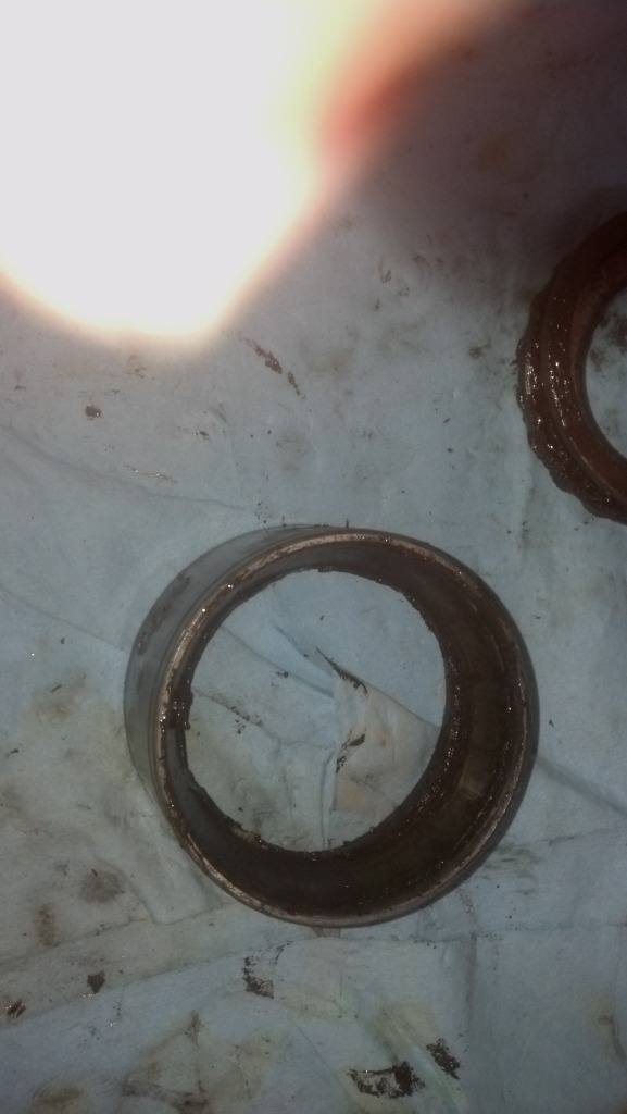

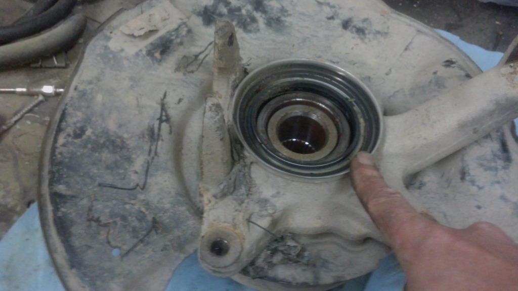

ok so this wheel bearing thing turned into a little bigger job than anticipated. not a bad job with the proper tools but I didnt have the proper tools. The bed on my press was just not wide enough for the job so a good deal of time was spent trying to find someone else with a bigger press, once that was done the disassembly went smooth. I didnt get any pics in prosses but I took some pics after and will try and explain how we got it apart. I coulded get a bearing today so resassembly will have to wait.
start by removing the inner seal

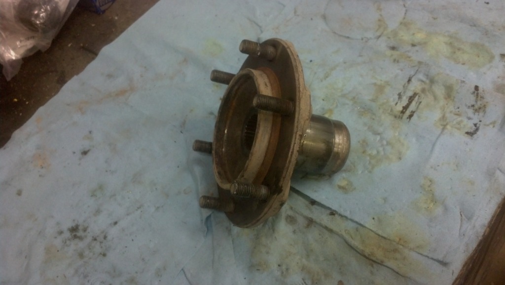

we positioned plates between the hub and the knuckle tried to stay on the bolts that hold the backing plate on and pressed the hub out.

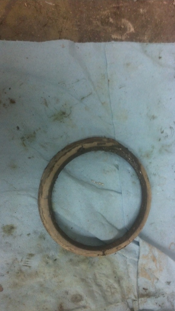

the stater ring and it spacer ring will stay with the bearing but once the hub is out they will be loose and you just pull them out.

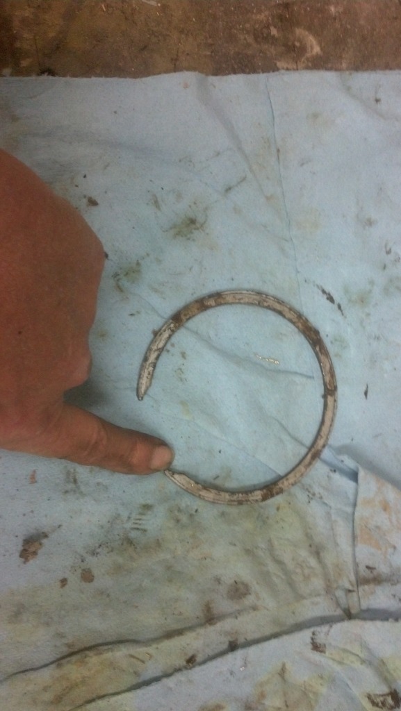

at this point remove the front seal, I didnt get any pics of it in place but under the seal is a snap ring, be careful removeing it we broke both ears where you hook the plyers so we had to work it out with a pick and screw driver.

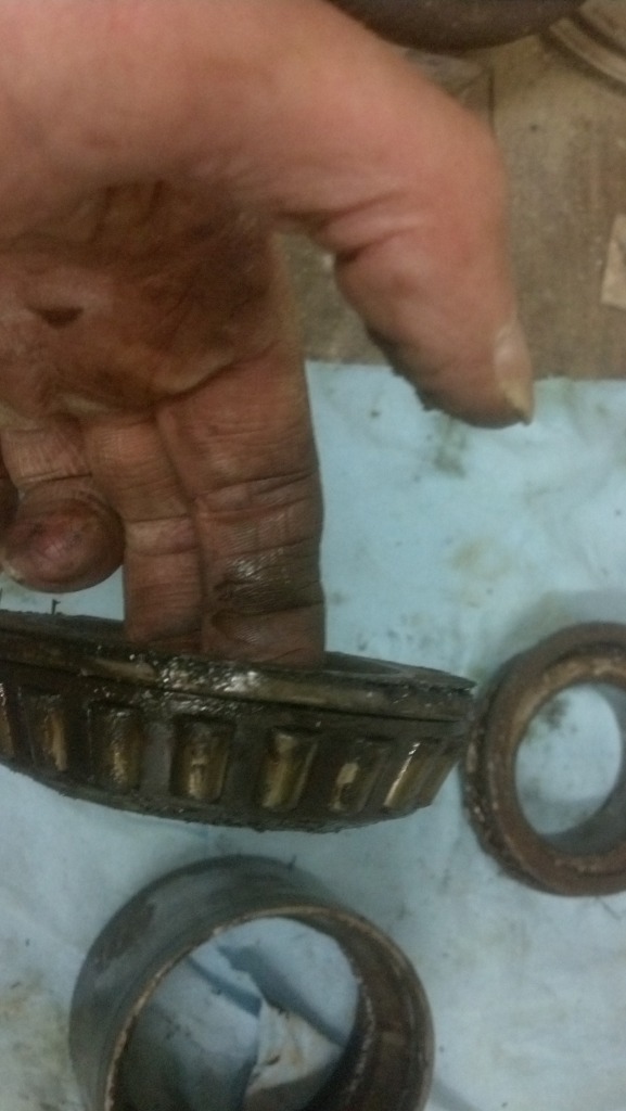

the shop I was at had a good selection of bearing drivers, so we found one that fit pressed bearings and race out together.

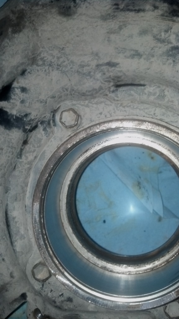

if you look inside the knuckle you will see a ledge that the race getts pressed up to.
