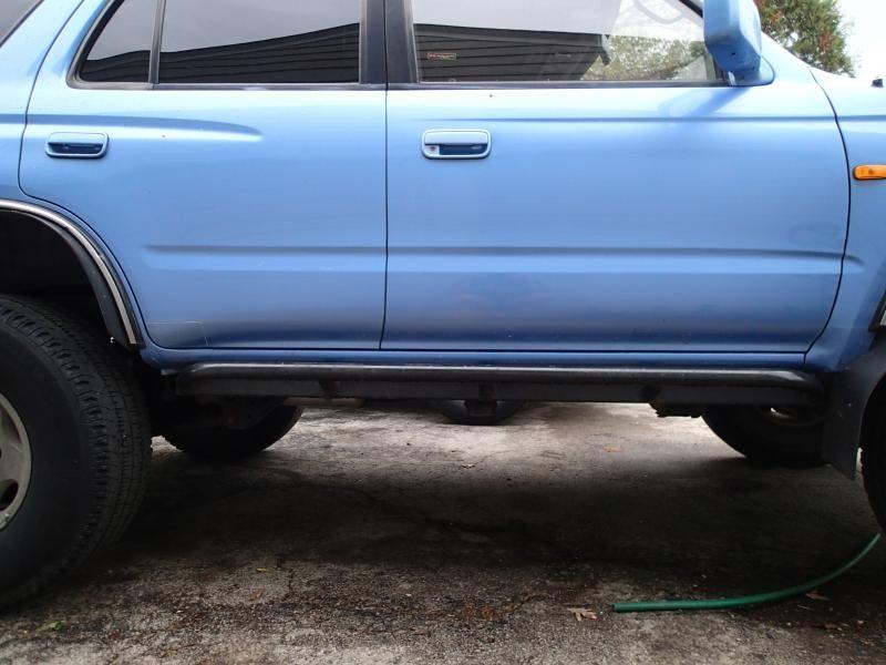

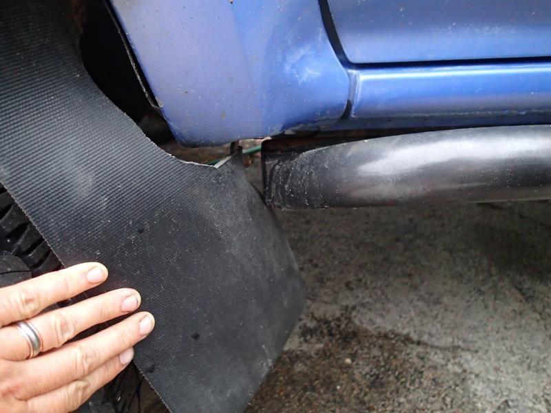

This week I've done a little back and forth pm-ing about sliders that made me remember how difficult is was for me to decide what length I wanted.
For anyone who it might matter to, I chose 65". I just have the little chrome trim, not flares. Here's what 65" looks like:
Front:
Rear:

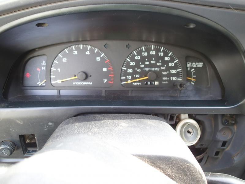

Today I double checked for pre-wiring and removed the ABS light (Taco spindles = no abs), which I will put back when I eventually move the hub to the 4Runner spindles (when bearings are replaced). I stuck the bulb in the rr diff lock light place (there's one there!) and then looked desperately for any sort of pre-wiring. Nope. Wasn't there before and it's still not there now. Maybe next time.
While I had the cluster out I cleaned both the outside and inside.
A lot of the smudges were on the inside.
A little cleaner.
I also dusted/cleaned up the light bulb and plastic ring that fits around the ignition switch. That's as close as I'm going to get to house keeping.

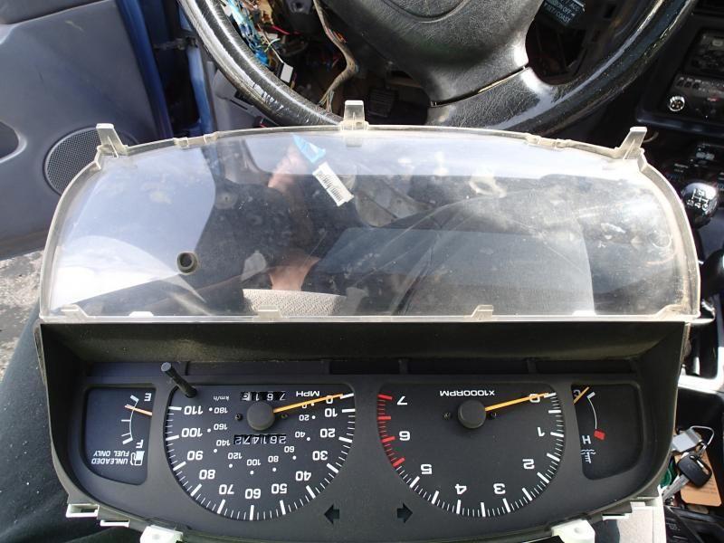

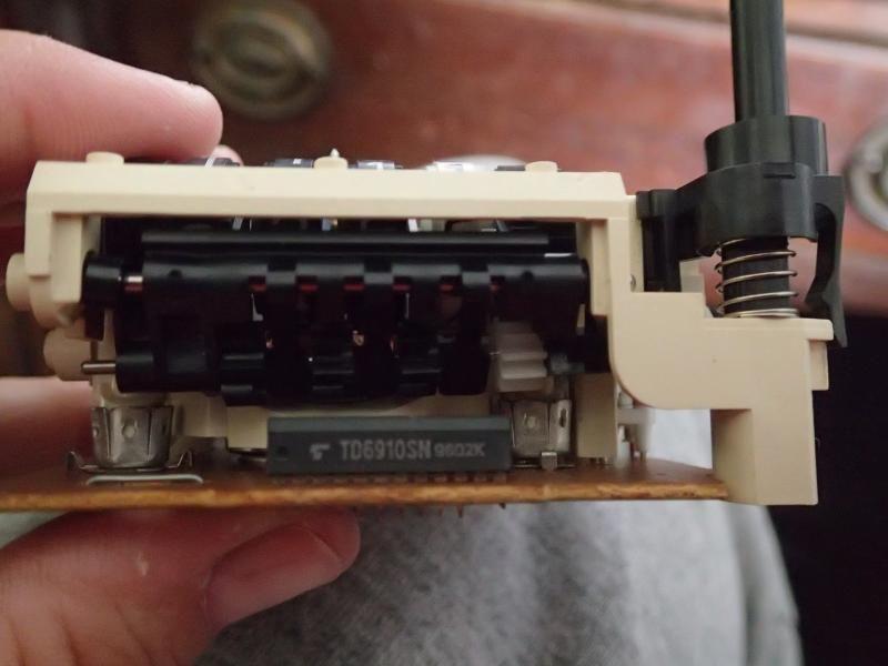

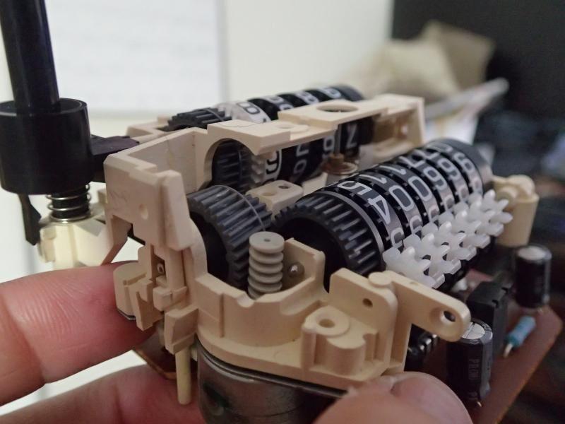

96 4Runner
Fixed the trip odometer.
BEFORE YOU ATTEMPT THIS BE AWARE!
There are 4 teensy copper wires soldered to tiny posts.
The trip odo sits over the top of this. I've replaced mine with great luck- but yeah, stinky tiny wires. After so many years of vibration I'm sure anything could cause them to jump ship and break.
A hummingbird could fly by. Someone could sneeze in the next town. A dog could fart. Mine just did.
Your speedo will not work if breakage occurs. Caveat Emptor! Well, okay, if you're going to do this be super careful.
Do this with your own will and at your own risk. That's actually true of anything posted in here....or anywhere.
Okay.
Unbolt the 4 bolts that hold the bottom panel on (under the steering wheel, houses the fuse access panel).
The trim around the ignition carefully pops loose.
Unscrew the 4 screws that hold the rest of the trim around the instrument cluster. Two in front and above the cluster and one at the bottom of the trim on each side.
Unscrew the 4 screws that holds the cluster in.
Undo the 3 plugs on the back, pushing in the tabs to release each of them.
Pull cluster out, carefully unhook the clear plastic lens from its various points on the cluster.
The black plastic trim comes off the same way as the clear plastic did.
Unscrew the tiny screws on either side of the speedometer needle.
Carefully pull off the needle. There may be a better method, but I don't know what it it.

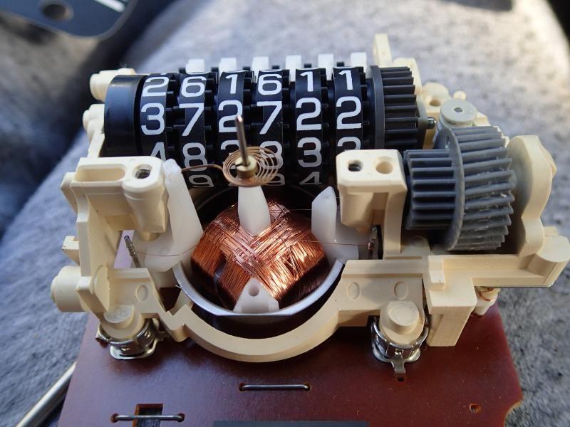

Unscrew the 4 screws on the back of the cluster that are directly behind the speedometer. This is the donor I borrowed the trip odo from:

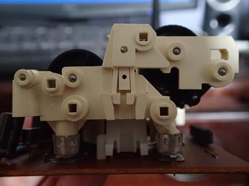

One arm of the bracket that pushes the gear out of the way and allows the cams for each number to reset is broken. It's the one to the immediate right of the white gear. Cruddy pic and I know I'm not explaining that right, it's kinda difficult to articulate with thingamajiggers and whatchamacallits.

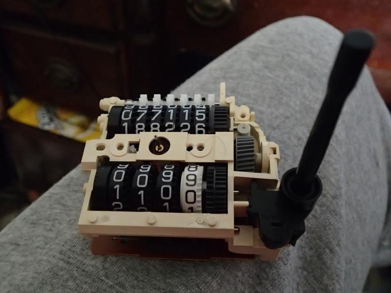

The trip odo pops right off, just gently squeeze the tabs together on either side and push up. In the below pic it's already halfway out.
See the tiny spring on the needle post? The tinier copper winding? Take care.
And snap the unbroken one in its place.
I only nabbed it because somebody had already torn the cluster it was in apart and had broken parts of the cluster in their effort to get I don't know what. Luckily they didn't destroy what I wanted. Yes, that other one says 77,xxx miles. No, I must have a touch of Volvo-itis because I would only be tempted to replace my odo with one of a higher mileage.

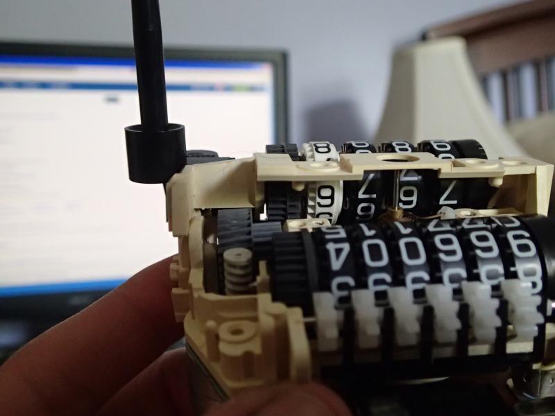

And another pic I found interesting...
The auger screw is what seems to run the trip and regular odo. The trip odo in this pic is not pushed down into place yet...

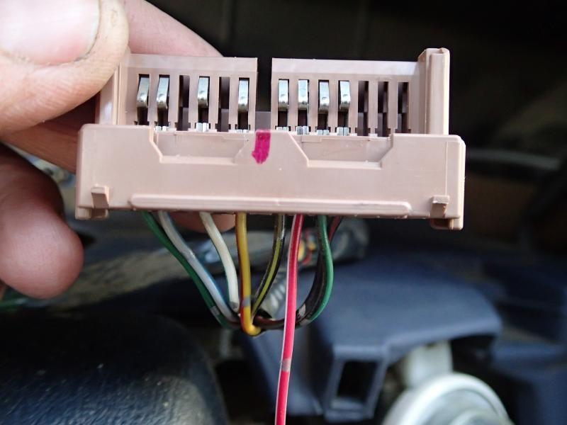

While I was in the cluster I:
Used Toyota# 82998-24180 to add a connection to that rr diff lock light I'd found earlier (No, still no prewiring has magically appeared yet. I'll keep checking) Red wire, shinyblackdeer called it pin 6 but if I'm reading this right it's actually pin 8.
as inspired by this thread:
http://www.toyota-4runner.org/1480759-post141.html
so a major thank-you to shinyblackdeer over on t4r for a terrific bit of information.
I'm also getting some terrific info here:
http://www.toyota-4runner.org/3rd-ge...ml#post1038490
And here, post 11 by black taco:
https://www.yotatech.com/forums/f2/e...please-247763/

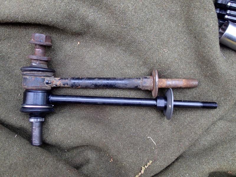

96 4Runner 261,6xx miles

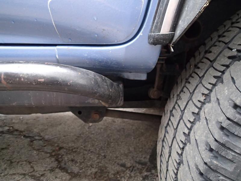

The 96's front sway bar got some longer links- s'posed to fit a 2nd gen 4Runner rear:
No, I can't afford the quick disconnects. The hubby used one of my old ones to replace a broken link on the 99.
I did drive it around disconnected for several days. It wasn't horrible, but I didn't like it.
