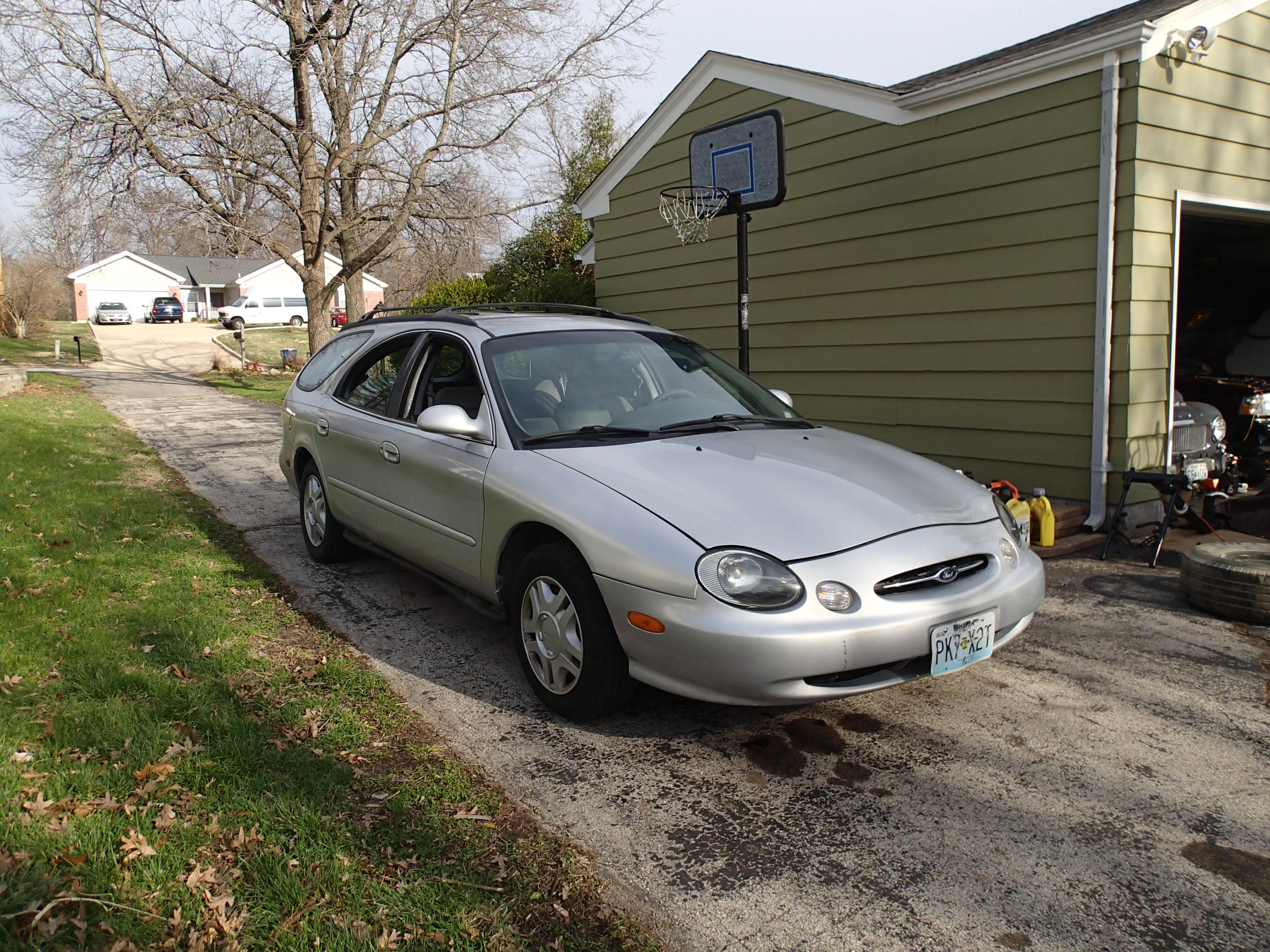

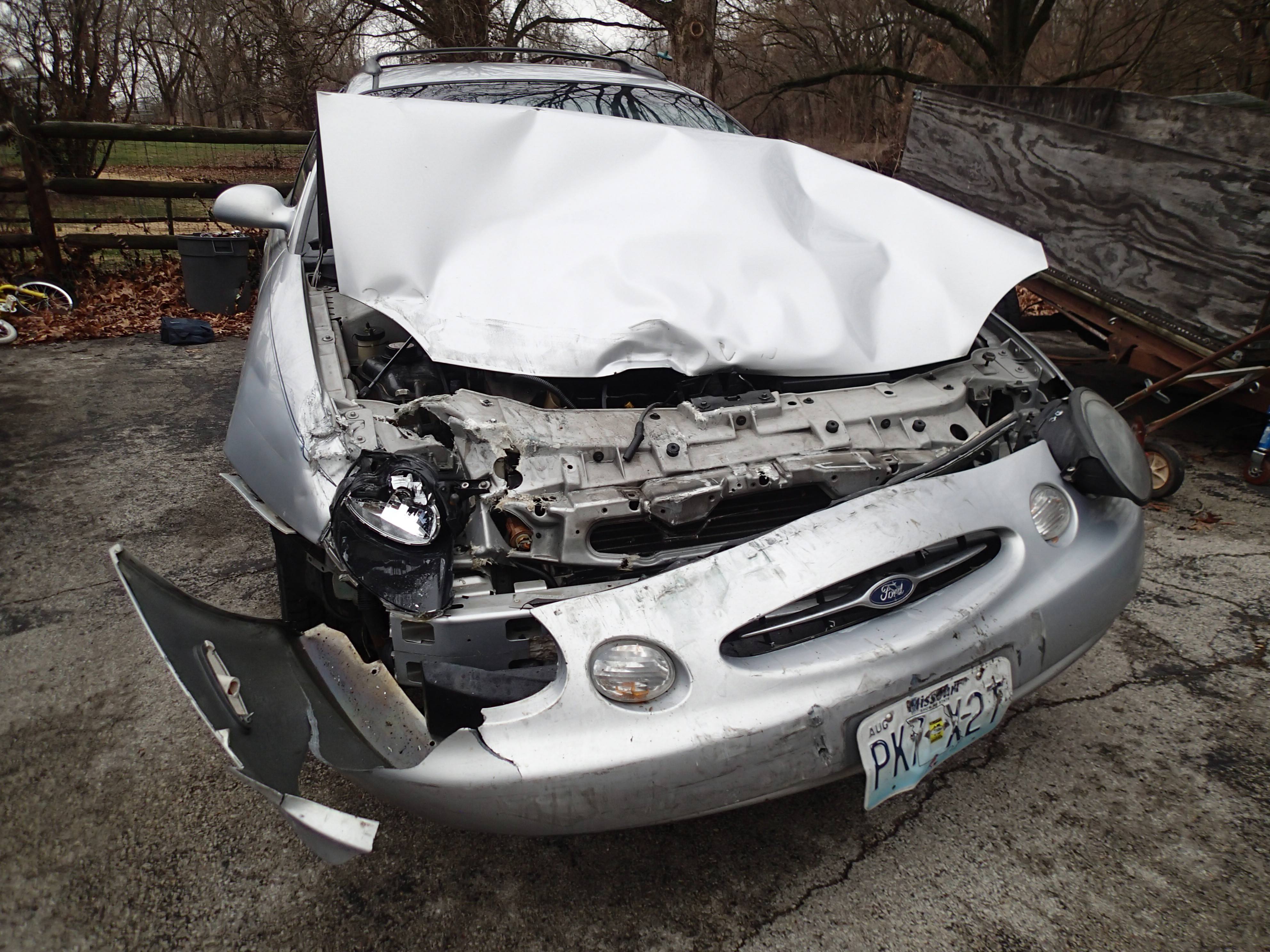

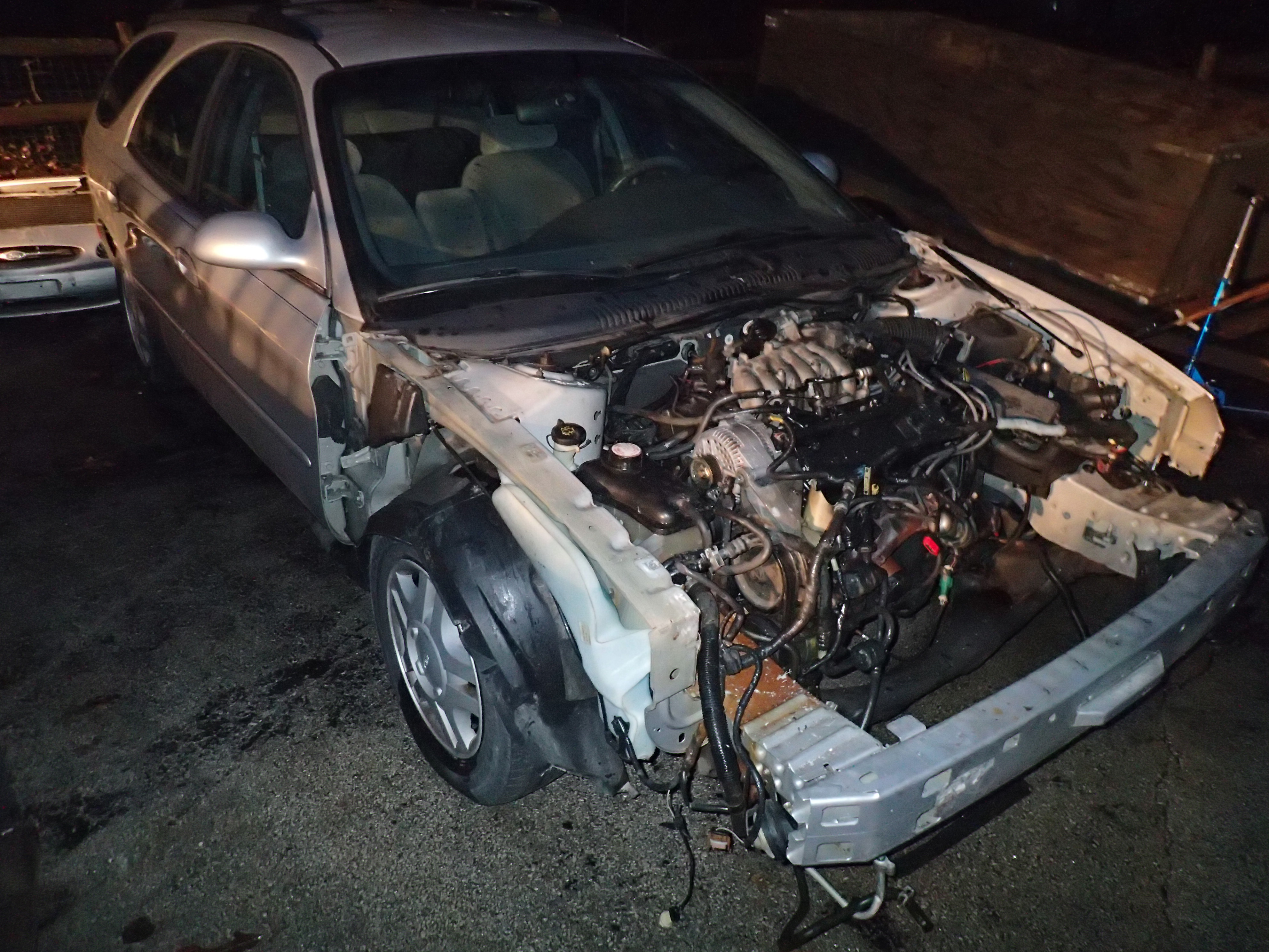

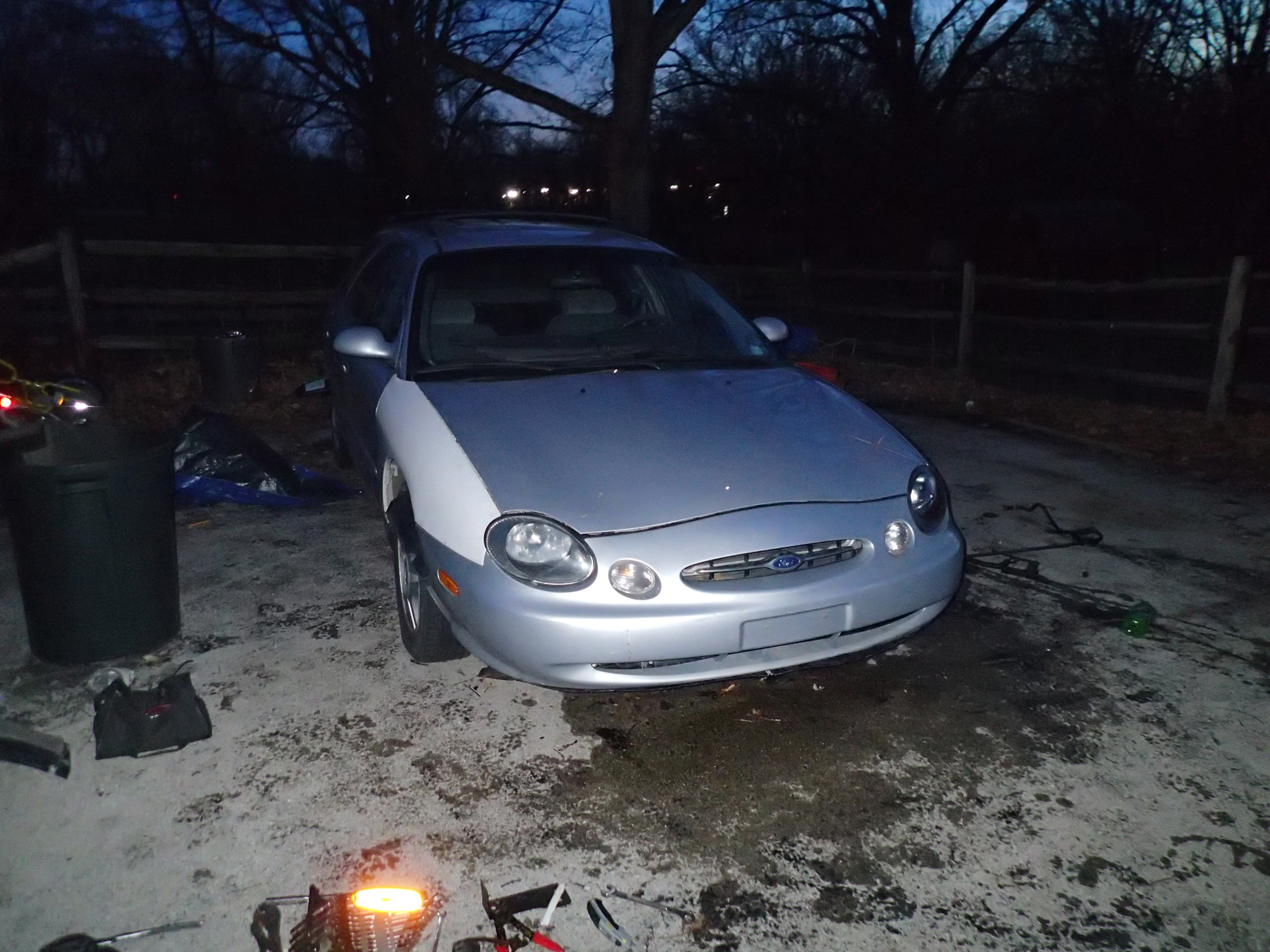

My younger daughter. Wednesday morning she got caught on the tail end of a sudden freeway slowdown, and bumped her Taurus wagon into the back end of a BMW X5. She's OK, got a bump on the top of her head somehow, some bruises and sore spots, all minor.
The tall bumper of the SUV combined with the dipped nose of the Taurus meant that her car nosed under and the sheetmetal took the hit. I.e. it looked pretty nasty, but not that hard of a hit. Nothing that didn't unbolt easily was bent. Just a lot of bent parts to unbolt, get at a junkyard, and bolt back on.
Brief pictoral:
What the tow truck dropped off:

Everything broken/bent taken off:
Parts slapped back on:
A lick of paint applied, fluids added, good to go again:
