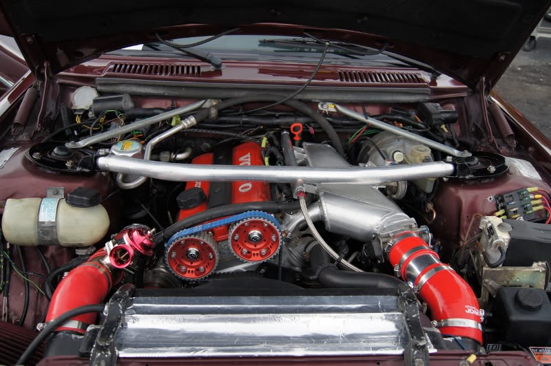

He threatens an LS1 if he keeps blowing engines but what he's done to the 4 cyl. Volvo engine is unique and infinitely more interesting. I think it suits him better because he has to be a lot more creative about it than some boring 8 cyl drop-in. Sure makes people do double takes when they see what's under the hood.
A Mustang engine might make more sense, it's already got a Mustang tranny. Bet he'd get bored with it in about 3 seconds.

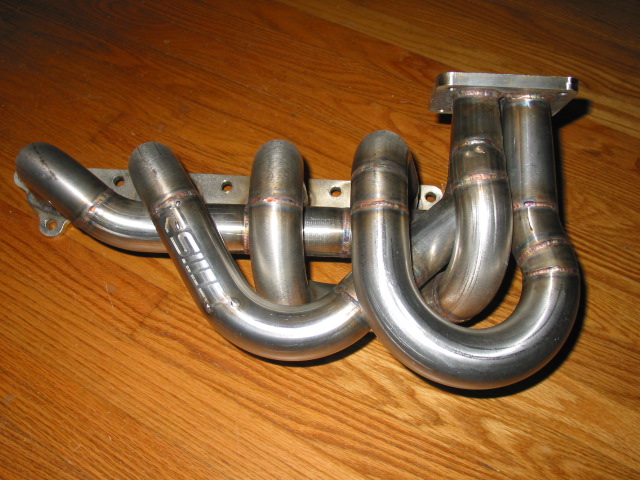

Version 1.0 was a 16V head swap, stock cams, 8V intake manifold on an adapter (16V's don't fit naturally in a 240 at all), stock head, stock cams, and a restrictive log manifold with a chinese knockoff GT30R turbo. Stock engine sensors, run by an old Megasquirt 1 box. That did 305 hp at the rear wheels (330 - 340 at the crank?).
Version 2.0 was all that plus a custom intake manifold, a ported head, some racy cams, upgrade to MS3X, coil-on-plugs, Mistubishi crank sensor where the dist. used to be. This was a bit if a disappointment, mostly I made the motor very peaky, either all on or all off. The cams were a bit much. And it never made more peak HP because I ran out of fuel pump capacity (E85).
Version 3.0 is going to finally unplug the exhaust side. Getting rid of the log manifold in favor of a nice fairly equal length divided (properly pulse paired) manifold:
And replacing the Chinese T28 flanged GT30R with a divided scroll T4 flanged... something or another (I'm still pondering that). And replace the fuel system. Going back to stock cams too, they're for a fairly revvy NA motor, they work well with a street driven car. Those other cams were just too much.
I also have to (ahem) replace the pistons. I pushed the last motor a little too hard before the tune was solid enough, all 4 had broken top rings, cracked top ring lands, lots of detonation damage on the crowns.
