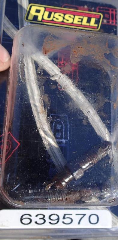

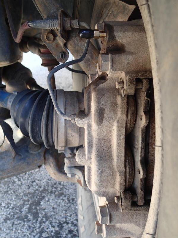

Finally got around to replacing the front caliper bleed valves with speed bleeders-
For the 231mm tundra front brake calipers:

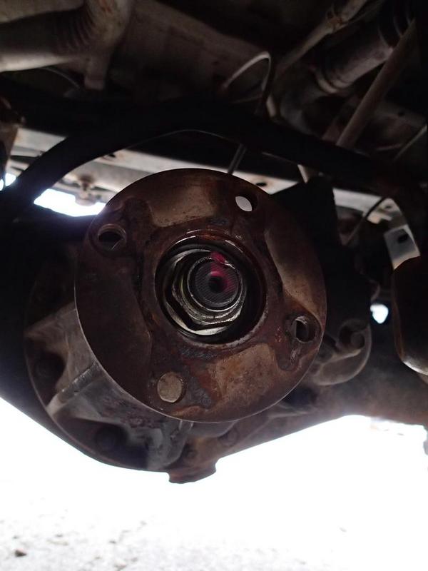

Pulled the driveshaft and it was as suspected- bad rear u-joint. It does have grease but is still very notchy. I'm not sure what a double-cardan joint should feel like, mine is floppy and wiggly and not at all notchy.
I can:
1) Replace only the rear u-joint
2) Have a shop do both front and rear and balance it- the DC is original.
3) Have one made with something other than a double cardan.
THOUGHTS, INFORMATION AND IDEAS ALL APPRECIATED.
EDIT: Just looked back at the last time I replaced the rear u-joint, 245,xxx miles in 2012. Why did it seem like it was only a couple of years ago? Well, I guess 60,000 miles on an aftermarket u-joint is....okay.
Also pulled the front swaybar- the bar has several millimeters of movement within the poly bushings. Will likely go with another set of poly or figure out a way to make up for those millimeters because the rubber ones can't handle the wheeling, kept destroying the right side oem bushing. While it's not as bad to drive as when the rear swaybar is off I don't see leaving it off at this point.

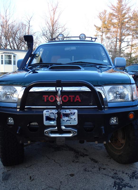

I did a thing....think he'll notice???
Found a hood of some imperfection off a '99 at pick n' pull
It had an insert that someone mangled trying to get it out BUT my husband pulled an insert off a different 99 with a destroyed hood ages ago so we're all good.
I'm not sure at this point what color it's going to end up being.
Maybe I should get some matching eyebrows so it might almost look like it's on purpose?

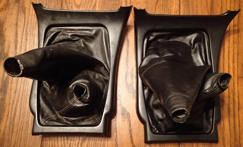

I also took a chance on a shifter boots assembly out of a '99 that has no holes at all, unlike mine. It's hard to tell from the pic, but they are exactly the same which is awesome.
So now we know that the early 3rd gen m/t shift boots with surround are the same as the later 3rd gen m/t shift boots with surround.

Got the driveshaft back. I wanted the double cardan mess rebuilt plus the notchy-bad rear while they were at it. They did the rear, said they hadn't had any success with the Toyota DCs and didn't want to tackle that one.
Kinda bummed, but I appreciate an honest shop that isn't afraid to not do something that they don't feel right about so it's all good.
They did say they can build a dc-like joint that uses easy-to-find u-joints, if I wanted. He said there was a little play in the rearmost DC u-joint, that it wasn't too bad at this point and to keep an eyeball on it. At least with the new rear u-joint and the new upper control arms the rear shudder is gone.
Now I just have to figure out what's going on up front. My front sway bar is off because I need to get new sway bar bushings. It's a bit....sway-ey, but it doesn't drive as funky as when the rear was off.

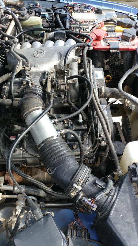

Moved my 3-hole (Rav 4) washer nozzles over to the 'new' hood
Deleted the stupid huge later 3rd gen ISR thingy and replaced with some aluminum pipe that was hanging around the house. For the vacuum lines (power steering and fuel pressure regulator) I used the hubby's neat trick and spare screw-on tire valves with the cores removed.

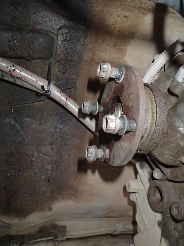

Couple of driveshaft notes:
To remove, I start with the rear. 4 bolts, both heads and nuts require a 14mm. Each also has a washer. Once I get those off I can drop that end of the shaft
Rear:
The front has 4 studs that stay in, with 4 nuts, 15mm wrench. There is a washer with each nut too. Mine is usually tough to separate though there's nothing holding it on once the nuts and washers are removed
Front:
