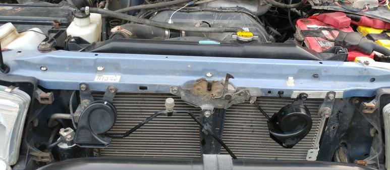

Found a set of horns out of a 2001 Tundra.
I had the 4 Cadillac horns for a long time, but the winch meant 2 won't fit any more, which left me with 2 horns and a relay and extra wiring. All the GM wiring is gone, the relay was left for later use, the fuse was pulled.
When I put that system in I purposely kept my oe connectors intact which meant the Tundra horns were plug n' play. They're louder and more American sounding than my original Toyota meep meeps.

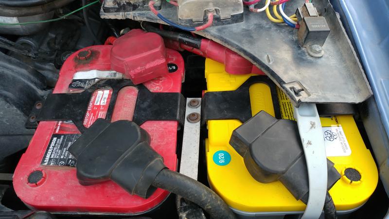

The battery I bought from Batteries Plus showed up yesterday. Dated 9/20, nice and fresh. Batteries Plus really went to bat for me to get one that was under 6 months old and I didn't mind waiting. Not like I'm going anywhere anyways.
Had a minor issue installing it. The center section that sits towards the middle is longer than the original yellow top (purple arrow) so the hold down on the Ruff Stuff dual box wouldn't sit down in place. A little bit of filing of the top edge allowed the hold down to fit and all is good.
The other thing I did differently was leave the handle on. The yellow top is a lot heavier than the red top and its position makes it really hard to pull out. Having a handle on it will really help. Because of the box's sides the handle can't be put on after the battery is in the box.
Someone once asked if I'd do yellow/yellow or red/yellow. I think I said yellow/yellow. Noticing the weight difference between the two, I might just stick with red/yellow when the start battery needs replacing as that has worked well for me so far anyway.

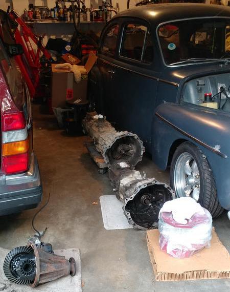

Got a visit from Mightymouse! Always great to talk to him, he's got a lot of experience and knowledge, great stories, and is willing to share what he knows. Top notch guy.
Thanks to him and his connections I now have a transmission with a lot fewer miles and less wear on the input shaft. Some is there, but definitely less- and he was very upfront about it as he always is.

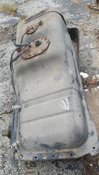

He also brought me a gas tank. Since oe is not doing it for me it's time to come up with a skid....well, after all this other stuff happens...

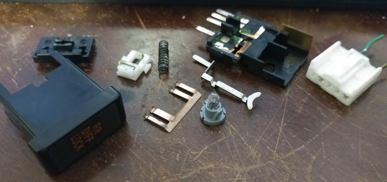

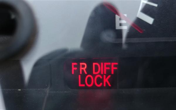

We've got locker lights in the cluster, now it's time to do something about the switches.
This is as far as I got today, the locking part isn't wired up and the labels don't match yet, but this is the beginning...
these are kinda delicate...

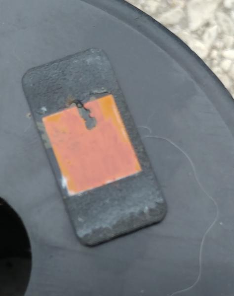

Will work on getting the lighting to match...step one was to see if I could alter the label.

Got both oe diff lock switches in and working. They both match much better now. The lights in the dash both work too. Would like to get the truck out and use it to make sure everything is copacetic, especially with the cluster, but that will have to wait.

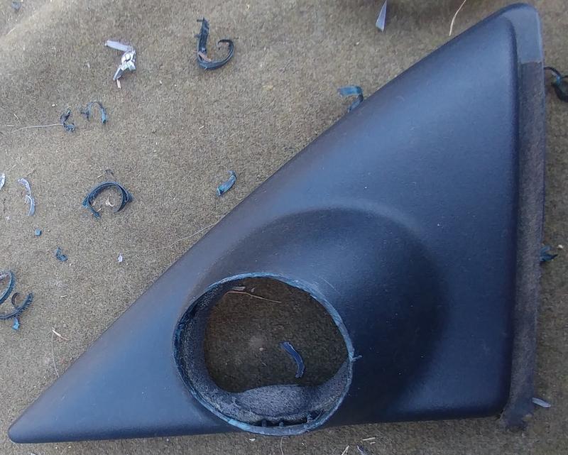

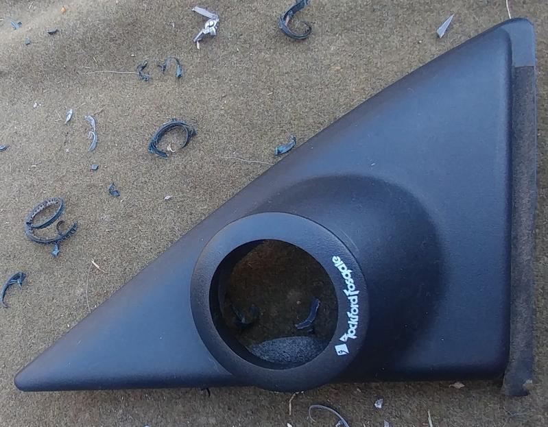

Finished installing the stereo. The Pioneer 4220 was a tad big for the dash, but a file and missing couple of millimeters fixed that.
Front speakers was 6 1/2" Rockford Fosgate component w/tweeters. The woofer was easy and fit right in.
The tweeters required surgery. I used a utility knife to remove the surround grille
Then enlarged the hole to accept the RFos. tweeter surround.
The tweeter fit in and ta-da

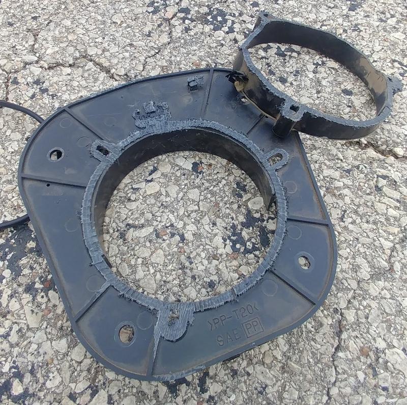

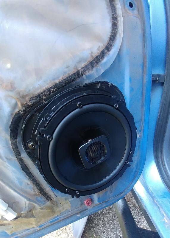

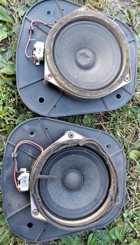

The rears were another story. Stock is 5 1/4", I went with 6 1/2" Polk.
There was a bit of figuring and some surgery. The door pocket will need something to block the now open end, but I can live with it like that since it's rear.
Crutchfield sent brackets that I needed along with the mount bracket that came with the speakers
I used the speaker surround that came with to measure where to cut out the door pocket. After checking I cut everything still in the way.

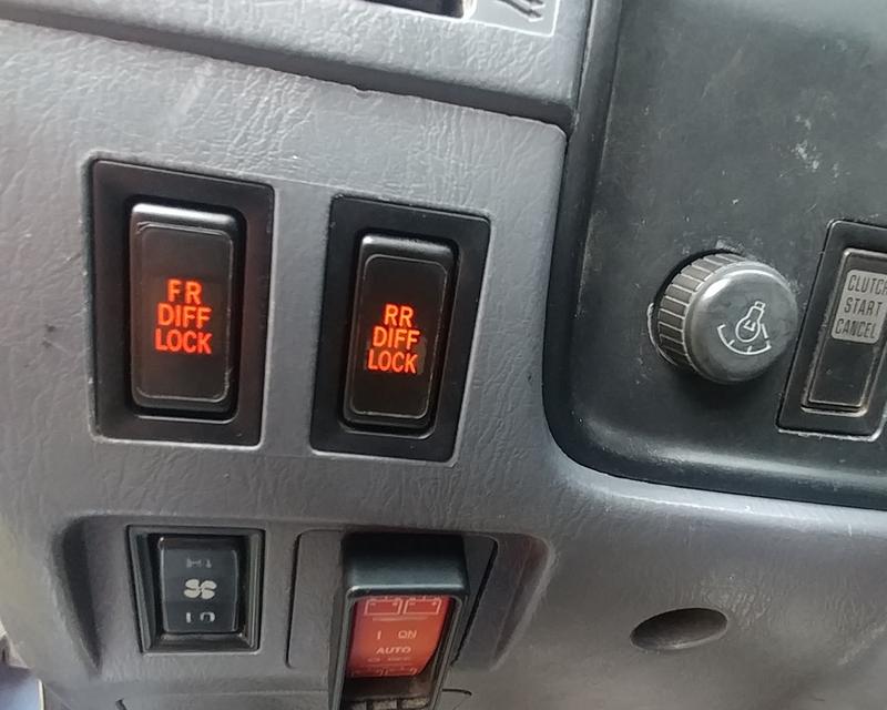

And the switches match now...

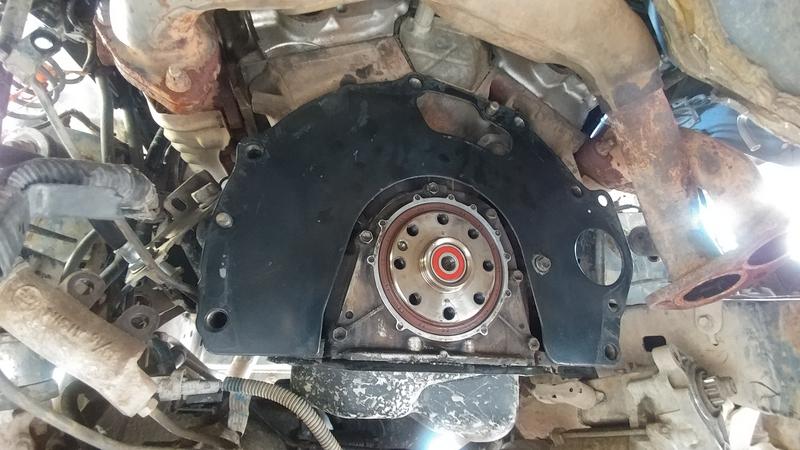

Rear main seal was slightly oily so it got replaced
Superseded Toyota #90311-A0027 is not as tall as the original but otherwise similar in dimension.
Also threw the pilot bearing in.
Both sat in the freezer while I prepped the area, then came out one at a time as I needed them.
I tried the bread trick with an old hamburger bun out of the freezer...AND IT WORKED!
I just kept stuffing bread in and tamping it down over and over until the bearing popped out. No excessive force, not a whole lot of time.
And that's it for now.
