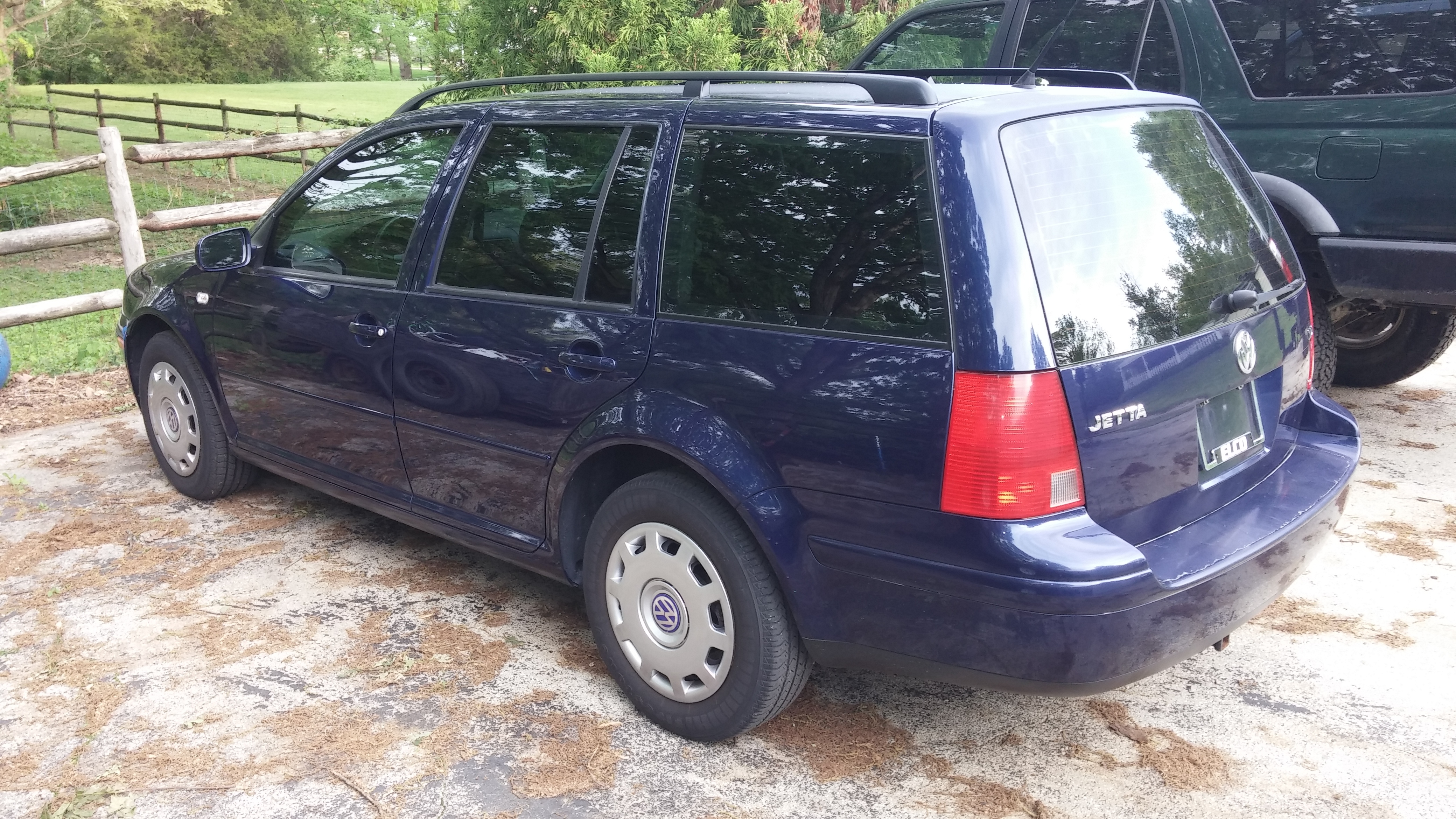

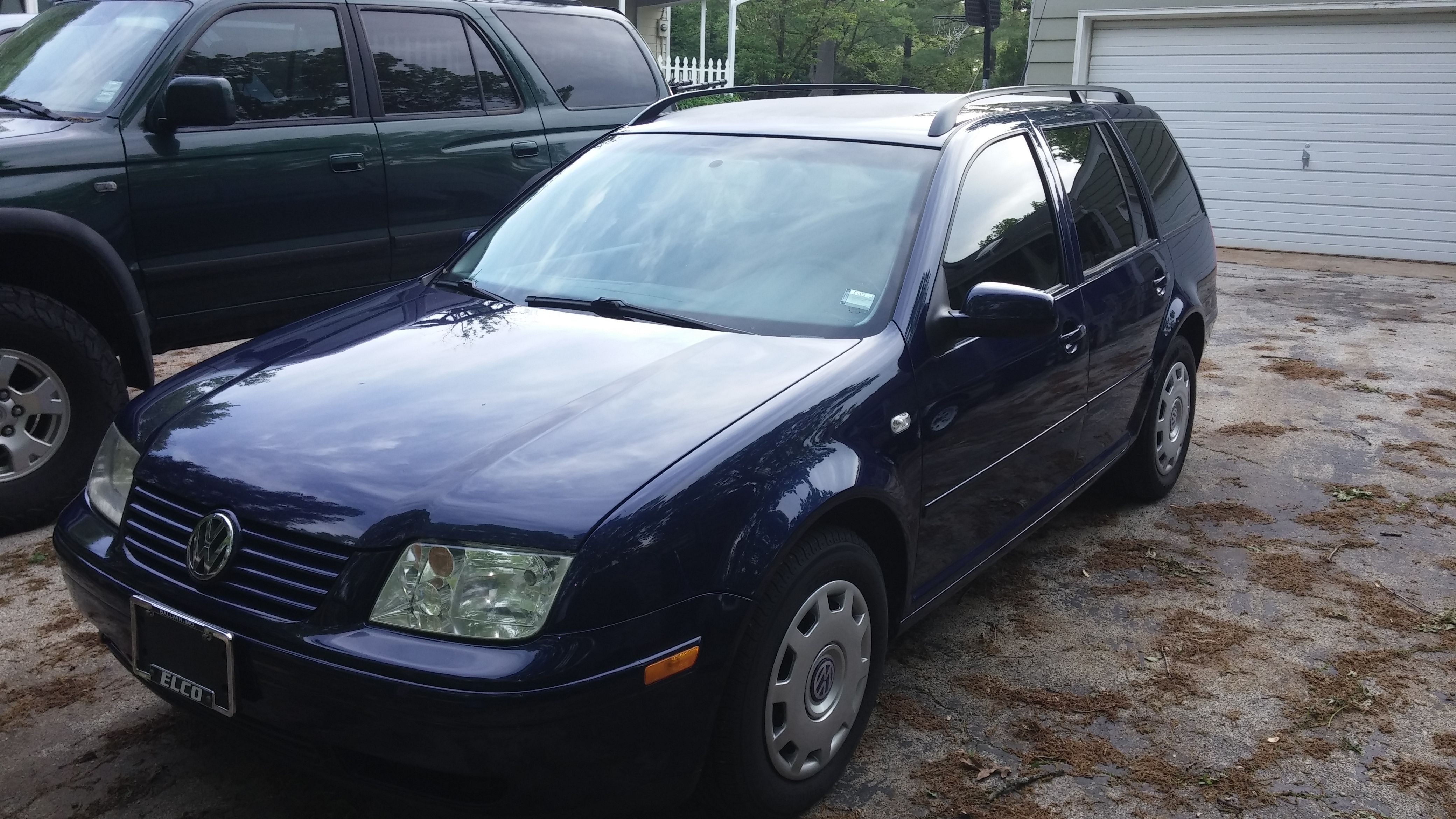

What gets 3x the mpgs as my 4Runner? Our 'new' car! Really just a beater, we continue the tradition of the beater stocker car being the newest one of the bunch and not in too bad shape. It's an '03, manual, diesel, and a Volkswagen. At least it's one of the German built wagons. I'm not generally a VW fan, but this fit the size, price, safety, trans and mpg requirements so there you go. Guess I'll learn.
My 96 is still my daily driver, no worries.

Some pics (or it didn't happen).
It's a peach. About the worst I could say about it is that some of the rubberized trim pieces inside are peeling, but that seems to happen a lot. We'll either ignore it, or take them out and plastidip them.
