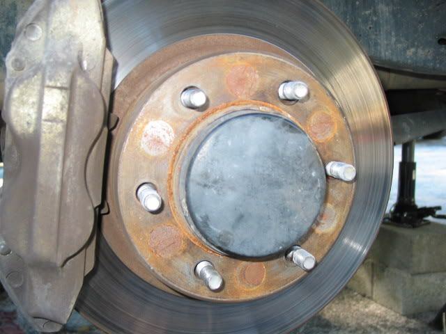

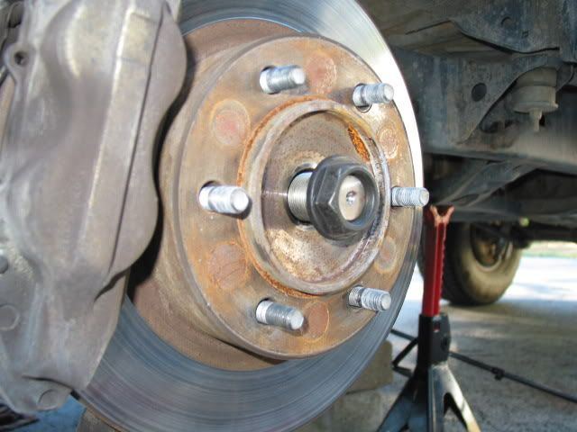

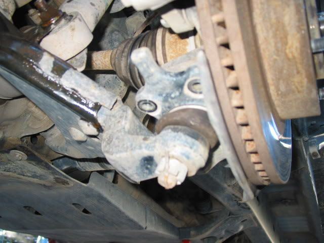

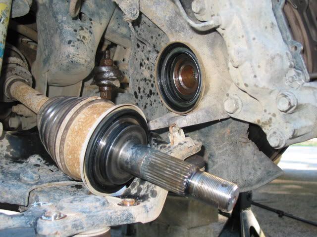

96 4Runner 229,xxx
The worm can has been opened and the suckers are crawling all over the place....
So off come the wheel and adapter, off comes the hub cover...
Off comes the cotter pin, retainer nut thingy that I don't know what it's called and isn't pictured but sits atop the axle nut, and the axle nut (35mm in this case)
Off come the 4 lower ball joint bolts. Leave that big guy alone, we don't need to mess with him today.
Pull the spindle/brake assembly away from the outer cv shaft. I got lucky, this one fell right out. Maybe because I got unlucky and am redoing the stupid things after just over a year. Hook the assembly somewhere out of the way.
Carefully find a way to convince the inner shaft it wants to separate from the front diff. There's a c-clip holding it in- I have to use a long pry bar for the leverage. Partway out. Girl muscles, meh.
Ah yeah, that got it. Now it'll pull right out.
