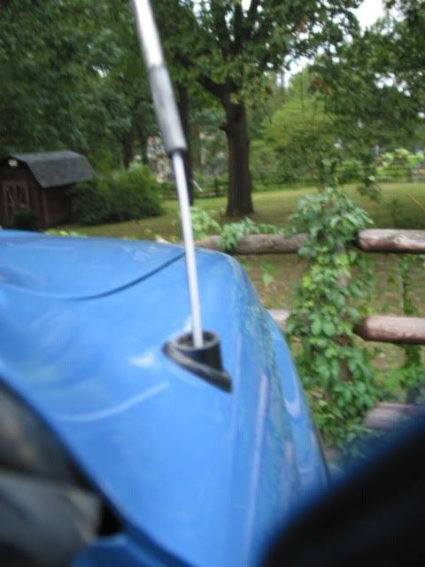

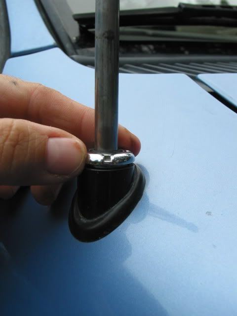

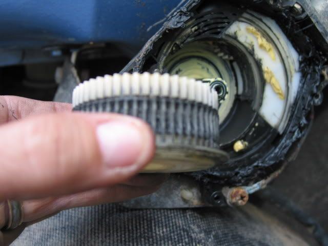

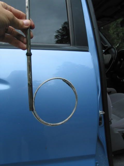

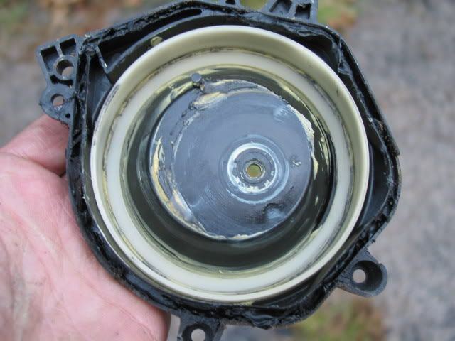

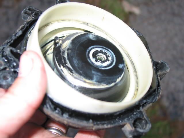

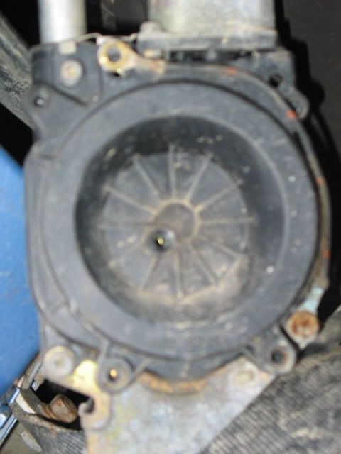

Antenna guts and mast removal/ replacement
Radio off. Unscrew this counter clockwise
and take off
hit this button (or turn radio on if you don't have that antenna switch )
Antenna poops out. It's nice to have someone catch this for you.
Here's the antenna with intact plastic track
Old Sep 16, 2011 | 08:03 PM
  #333
habanero's Avatar
Joined: Sep 2005
Posts: 8,247
Likes: 497
From: mo

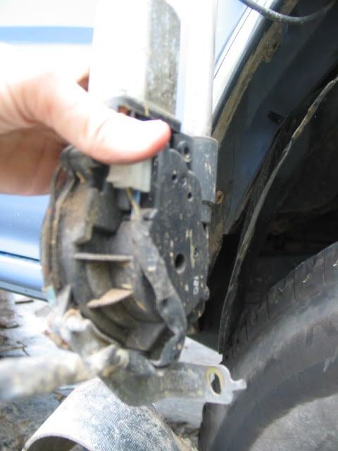

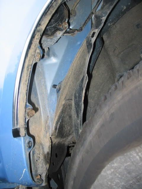

undo 10mm bolts that hold plastic wheel well cover on
There's the antenna just in front of the passenger front door

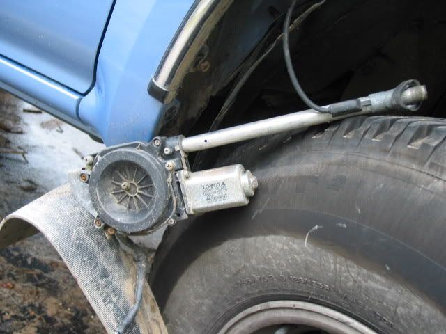

Follow the electrical wiring to the plug. Disconnect plug
Undo 10mm bolt just under antenna motor.
there is a tab holding it in place but it's not hard to unhook from bracket to pull motor from fender
One antenna motor, antenna wire still attached.

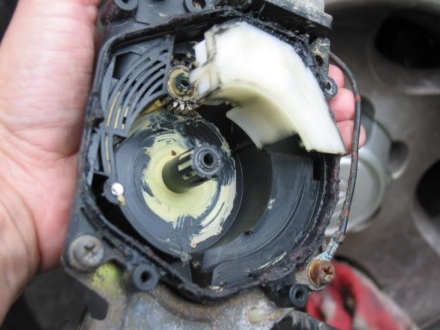

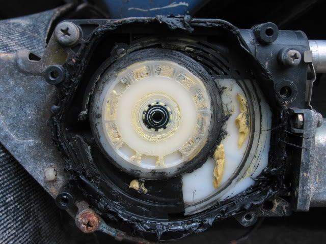

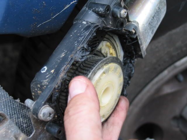

There are 6 screws to take the cover off. 1 in the middle, 1 at the top ground, 4 on the peripheral. I used a screwdriver to carefully pry the thing apart, they use an ooey gooey gasket to seal it.
Old Sep 16, 2011 | 08:09 PM
  #334
habanero's Avatar
Joined: Sep 2005
Posts: 8,247
Likes: 497
From: mo

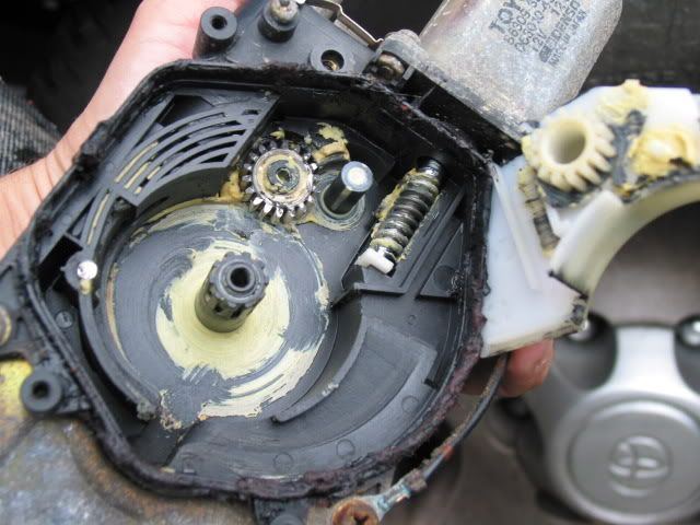

Here's the innards. I cleaned and regreased this stuff after making sure there weren't any broken bits
Then I put it back together, bolted back into the truck, plugged the connector back together, screwed the antenna nut back on (where the antenna comes out). Next I cleaned the gunk off the plastic antenna track and regreased that. It was pretty solidly gunked up near the top which was prolly why it wouldn't retract entirely. I had my helper push the antenna switch on (turn radio on), waited for the noise from the antenna motor to quit, then put the track down into the motor until a little bit of it caught. Next my helper push the antenna switch off (radio off) and the antenna track sucked into the motor as I guided it. It took a couple of tries to get it far enough in to get the motor to pull it the rest of the way in. I tightened the antenna nut.
  #335
habanero's Avatar
Joined: Sep 2005
Posts: 8,247
Likes: 497
From: mo
Ta da!!!
Gunked up antenna track was my problem.
